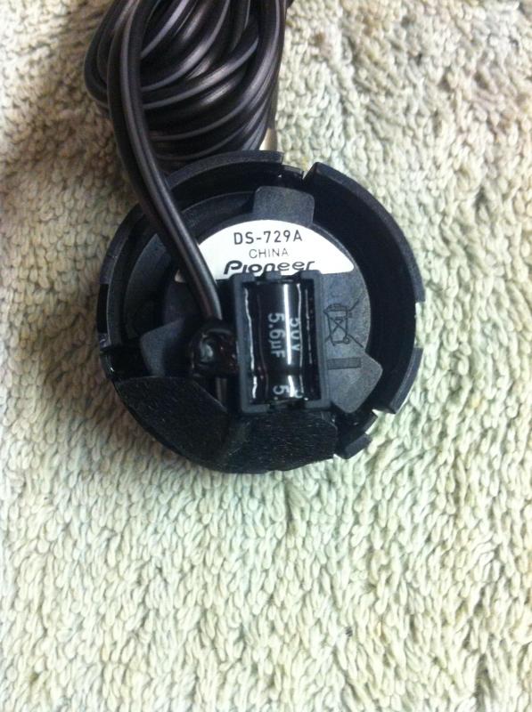

My front speakers are staring to crackle one side, I've sourced some half decent Pioneer ones off ebay new for cheap.
And they come with tweeters so I'm interested in fitting them.
These do not come with any crossover boxes so I just want to check if I can straight swap them?
I just want to make sure I don't fit them get the dash back on and they pop in a few days.
Thanks.
yeah that cap on the back is the HPF for the tweeter so can connect them no problem
