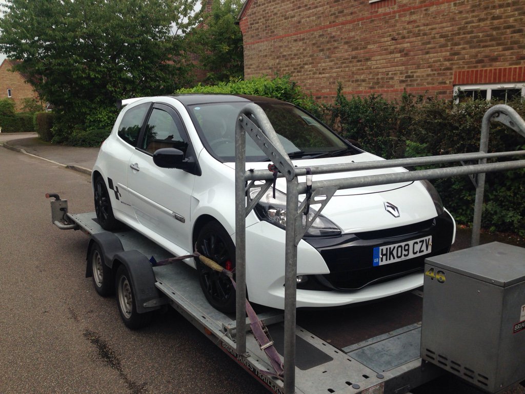

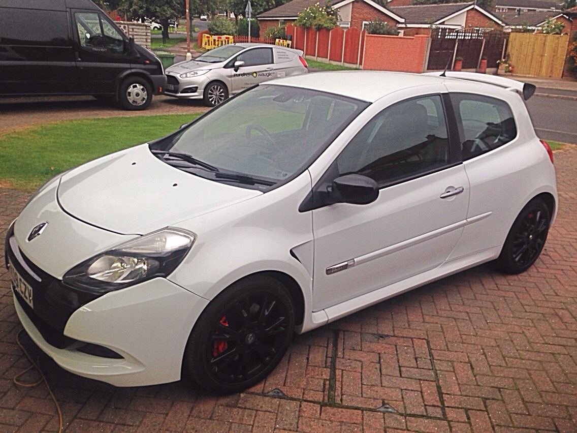

Anyway, seen this and it's 'my' perfect spec. Very early 200 on '09 plate. Glacier white FF with Cup pack, cup spoiler, Speedlines and Recaros. Only done 59k with history.
Gearbox has the usual crunch into 3rd and its due a cambelt so thought I'd just pull it all out and do the now popular megane conversion!

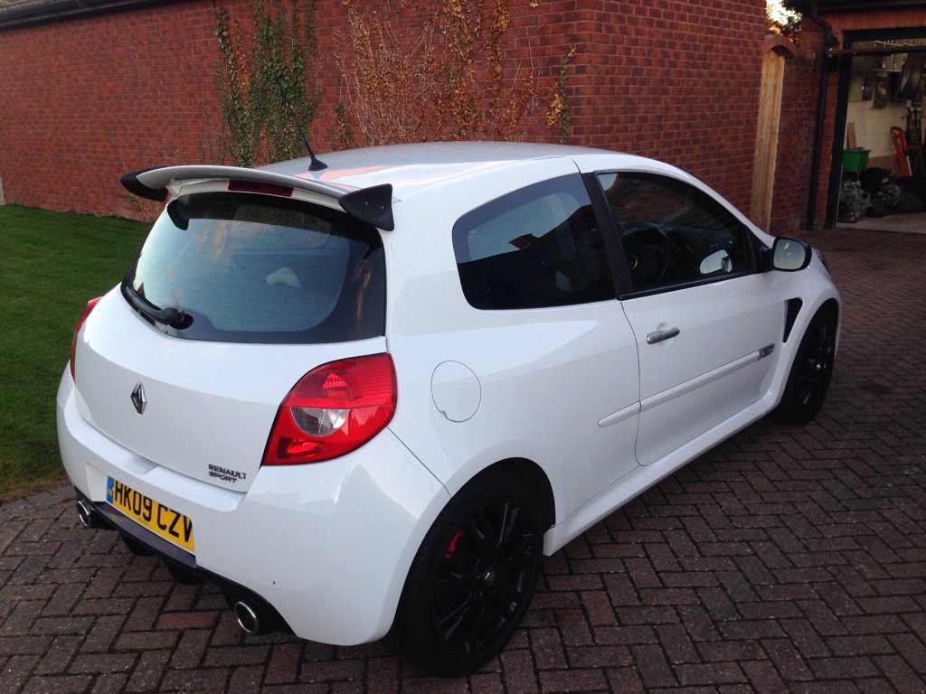

Before all that though, had to get it home and knock the 'ugly' off it.
Roof was wrapped black so that was removed along with the dealer stickers and various cliosport urls and some renaultsport logos on the lower quarters. Goes without saying that the wind deflectors were skipped too, never understood why everyone fits them!
Looking a lot better already. Have s few bits I want to sort, steering wheel needs a retrim and all the interior bulbs are green for some reason! No I don't know why either! Front Pirelli P-Zeros are nearly on the markers and the previous owner has put 2 new budget tyres on the back, some absolute Chinese garbage, I don't understand the logic of having an awesome handling hot hatch and putting £30 ditch finders on it! 4 new uniroyal rainsport 3's are on order. One of the wheels has a few marks on it so might have all four redone gloss black to match the front and rear bumpers and mirrors as the satin black looks a bit strange against all the gloss.

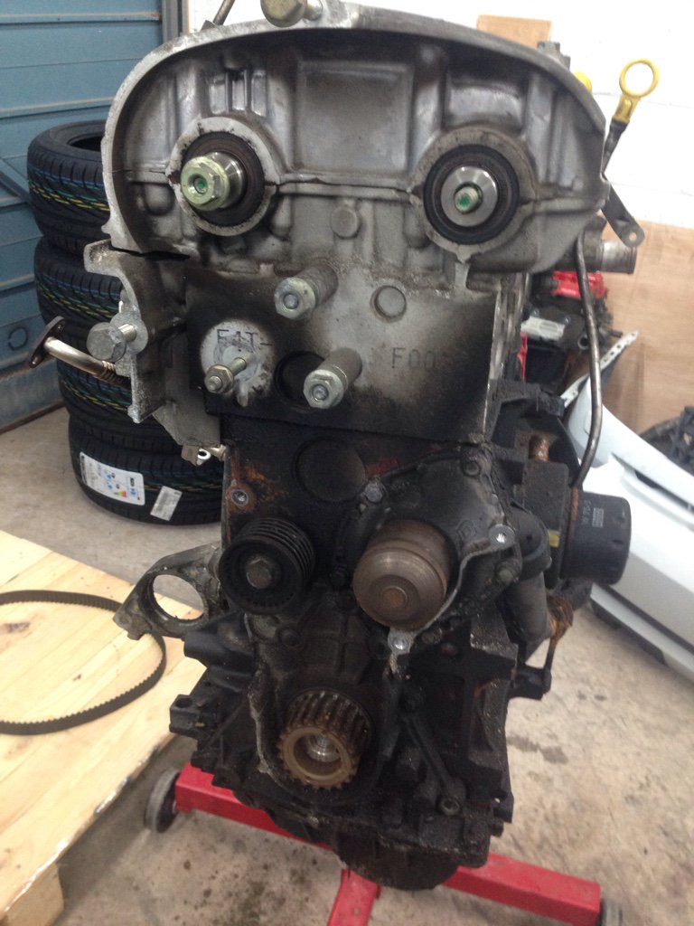

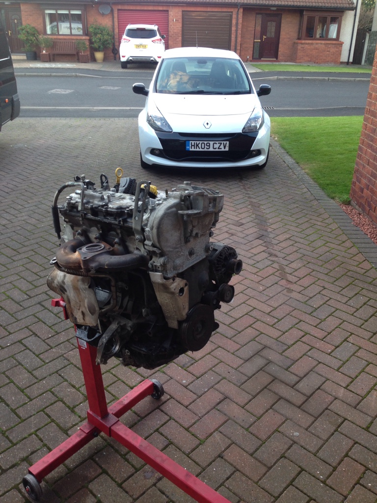

Been and picked an engine up today from a ph2 225 cup. A guy on meganesport's own car that he smashed.
Got most of the bits I wanted with it, loom and ecu, some coolant and boost pipes and both manifolds. Even got all the history from the donor car
Obviously I'll give it a decent check over and do the usual cam belt change, new plugs, coils and arp rod bolts. New sump gasket and anything else it needs.
Spec will be fairly simple with standard internals for now, Megane 250 turbo, 630cc injectors, decent cooler and 3" down pipe and exhaust. Should be happy with 300bhp for now.

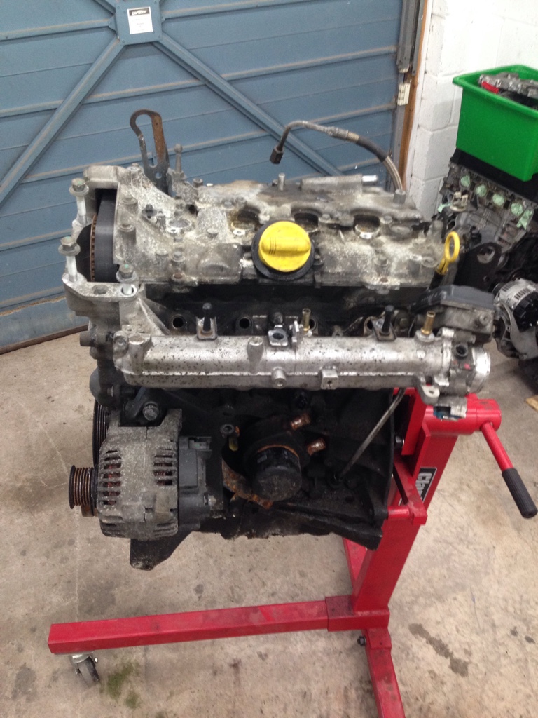

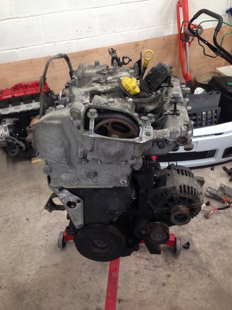

Put it on the stand already and pulled a few bits off. It's pretty grubby and needs a good clean but I'll sort that.

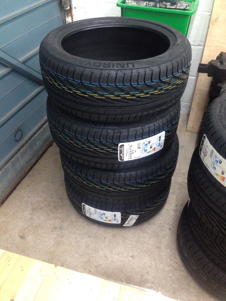

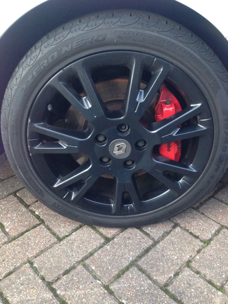

Mostly parts updates and engine stripping this week. My tyres turned up, still need to strip and powdercoat the wheels but tyres are ready to go.

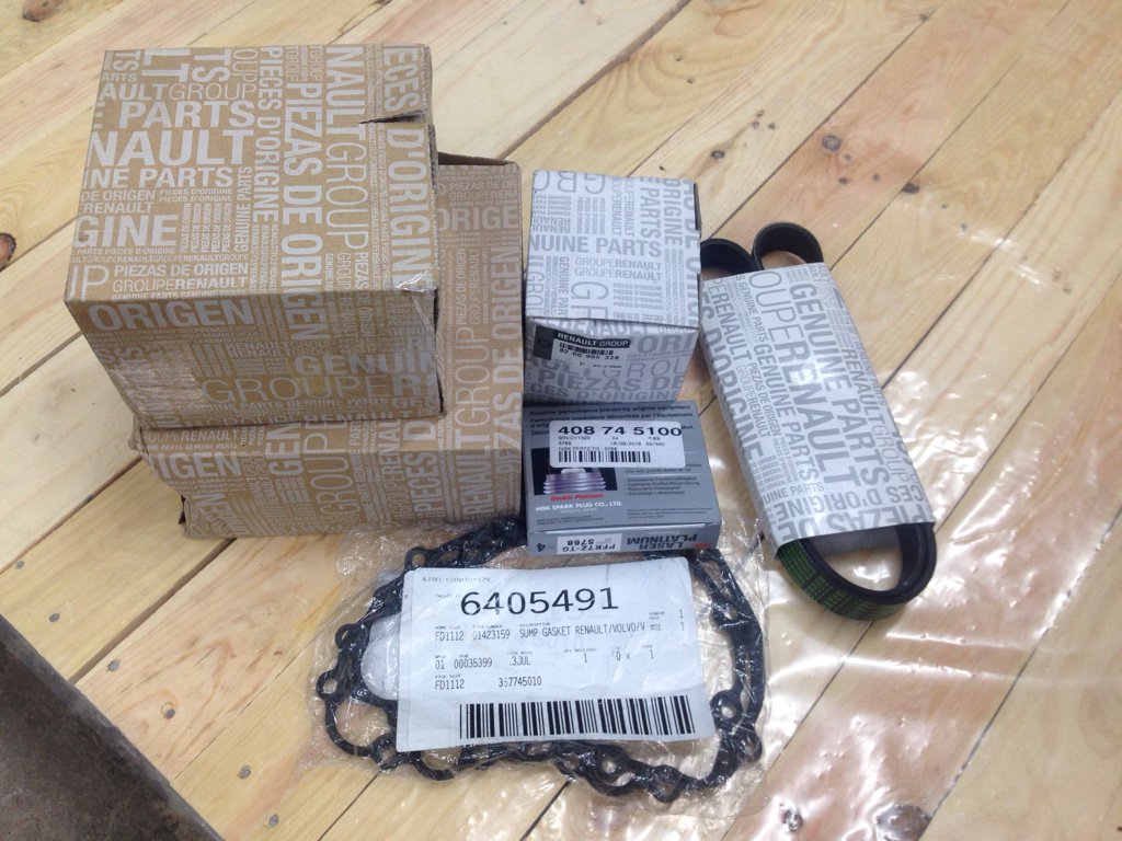

Ordered a load of service parts for the megane engine too.
NGK-R plugs, genuine cambelt kit inc water pump and genuine aux kit. New sump gasket too as I've got ARP con rod bolts to fit.

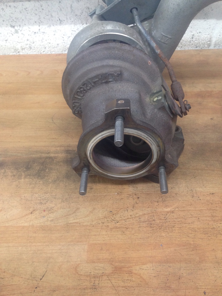

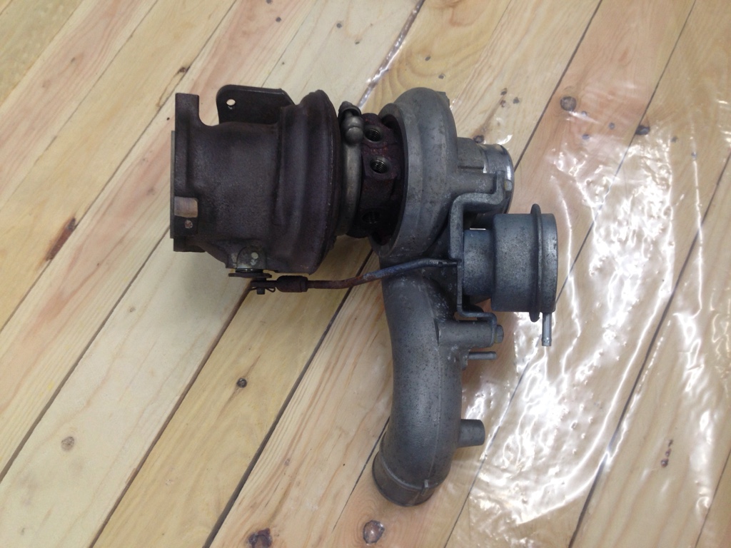

Picked up an RS250 turbo from @T.Trophy on here cheers Steve.
Need to have a trip to Renault for some water/oil fittings for the turbo + some studs, nuts and bolts. Need an inlet and exhaust manifold gasket too.

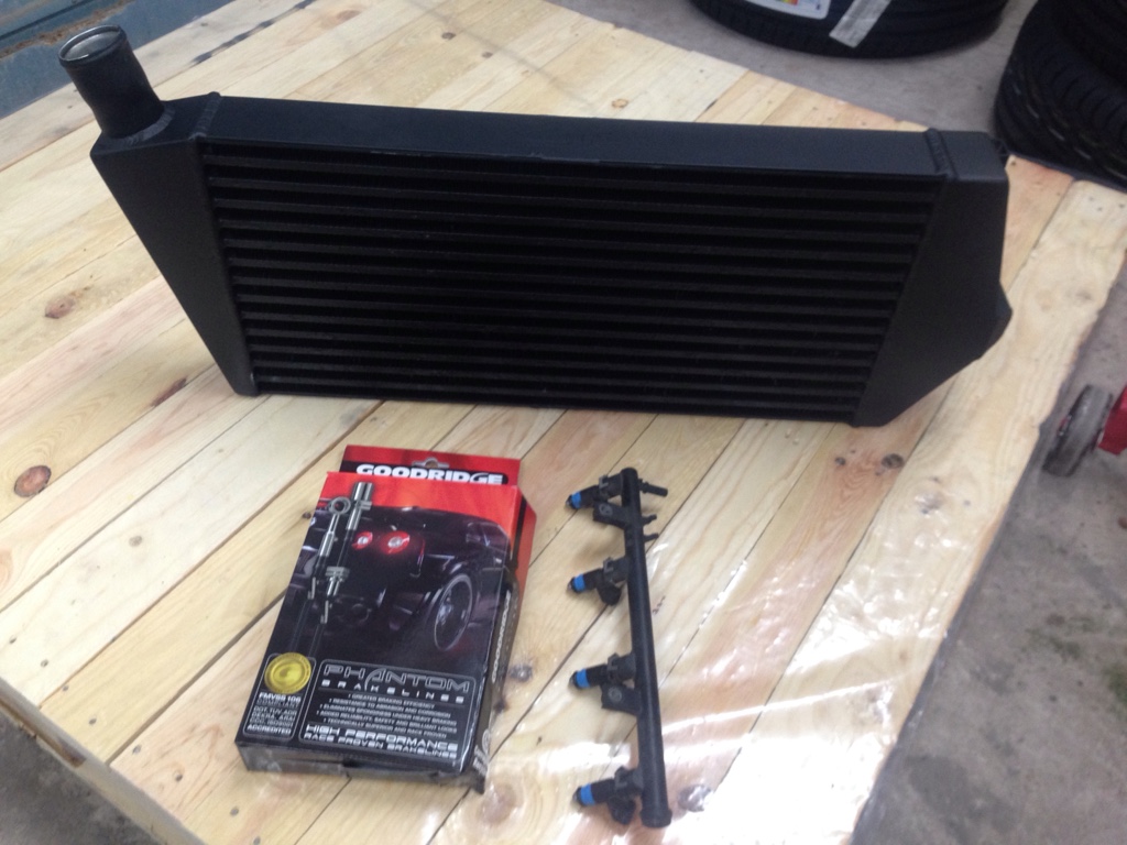

Forge intercooler, 630cc injectors and fuel rail and some Goodridge brake hoses.

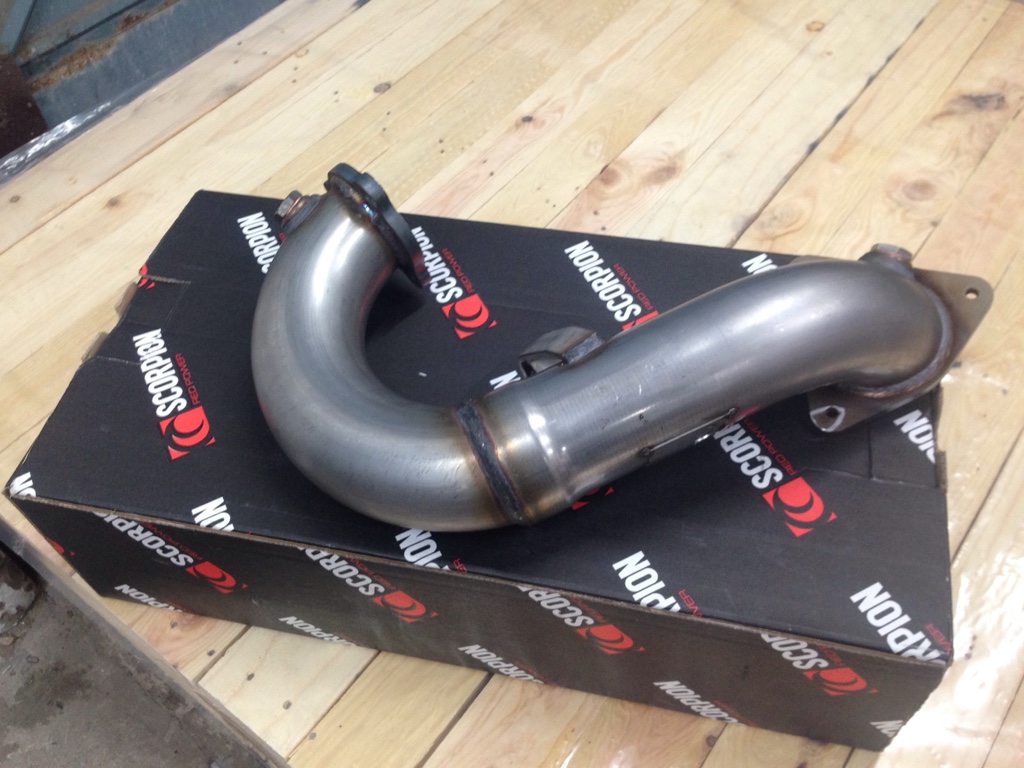

Scorpion 3" decat downpipe is here as well. Still need some heat wrap for it.

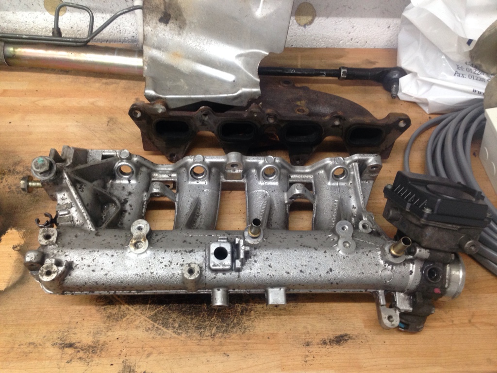

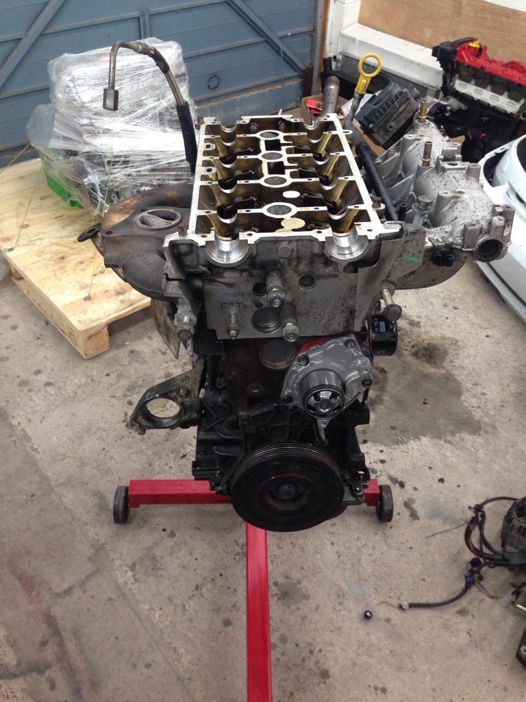

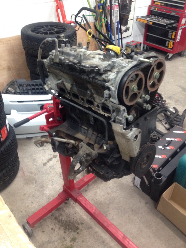

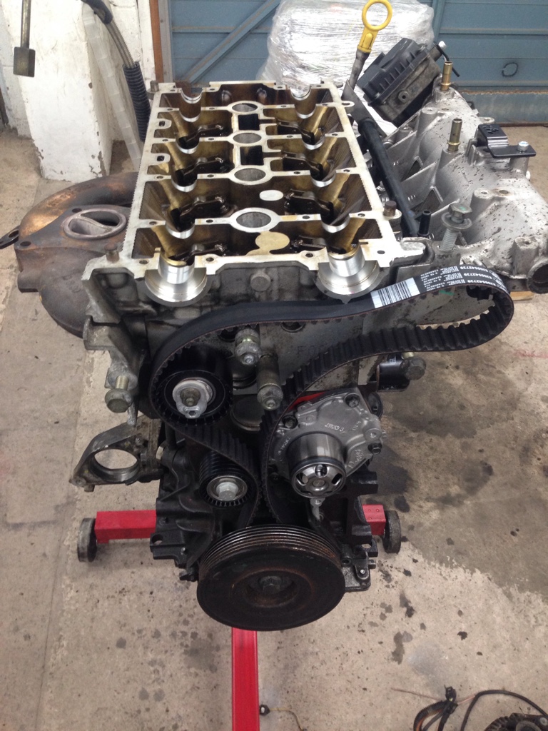

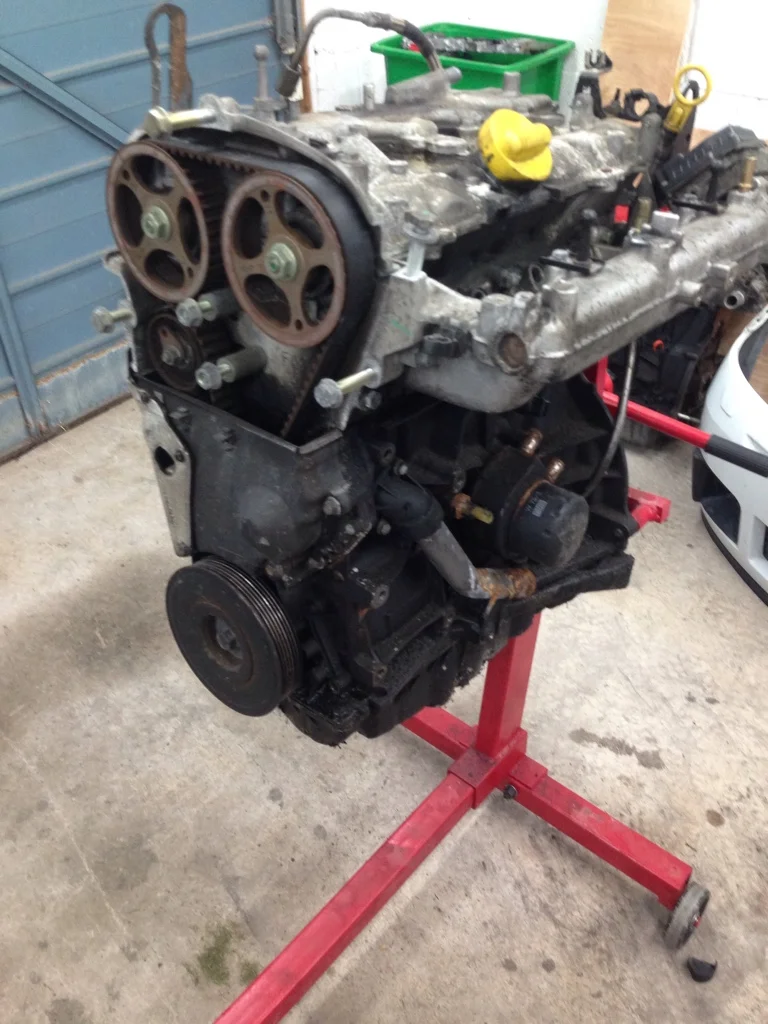

Stripped the motor down a bit more for a clean and to do all the service bits.
Both manifolds off.
Gave the inlet a scrub up as well.

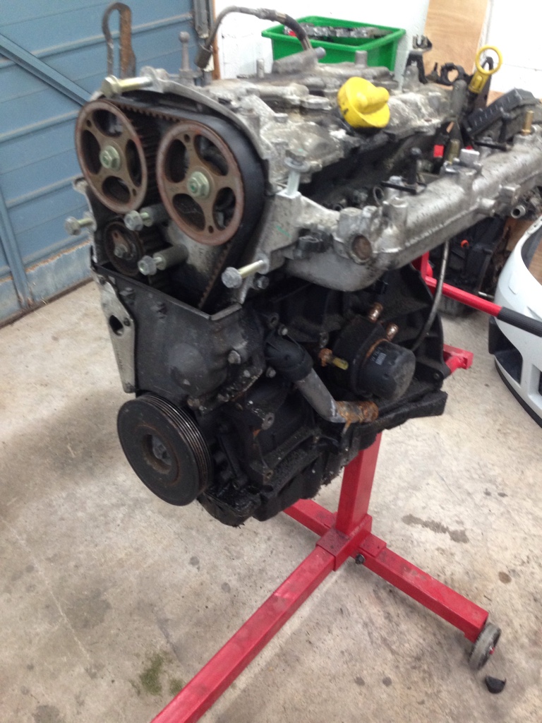

Cambelt and pulleys off.

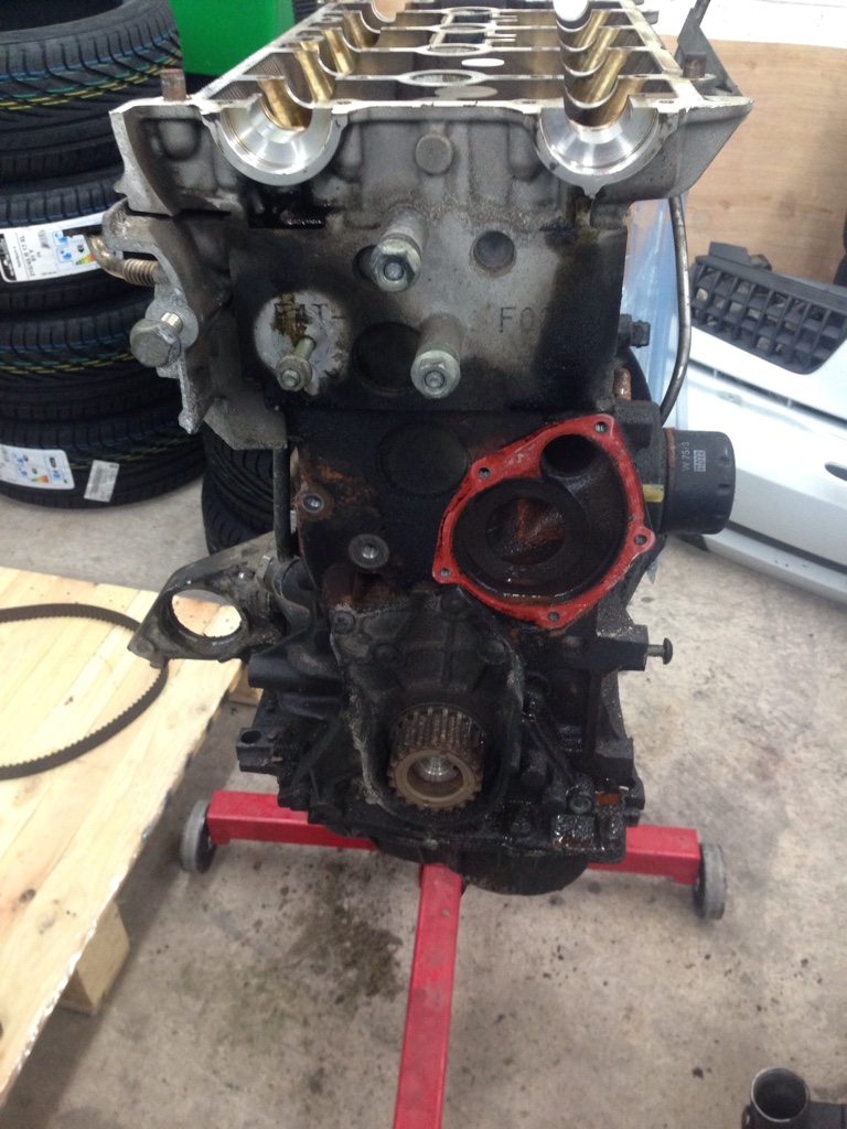

Water pump off, still got the dreaded gasket to remove!

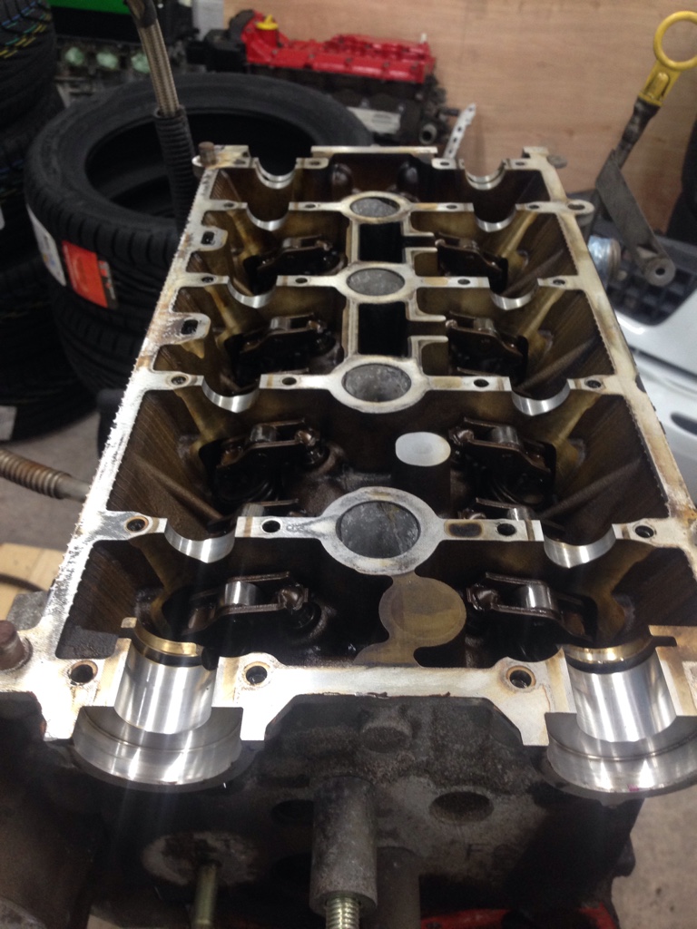

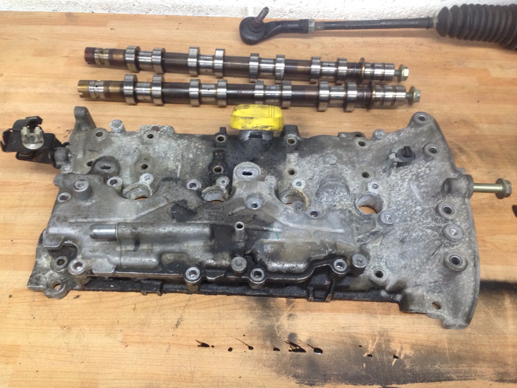

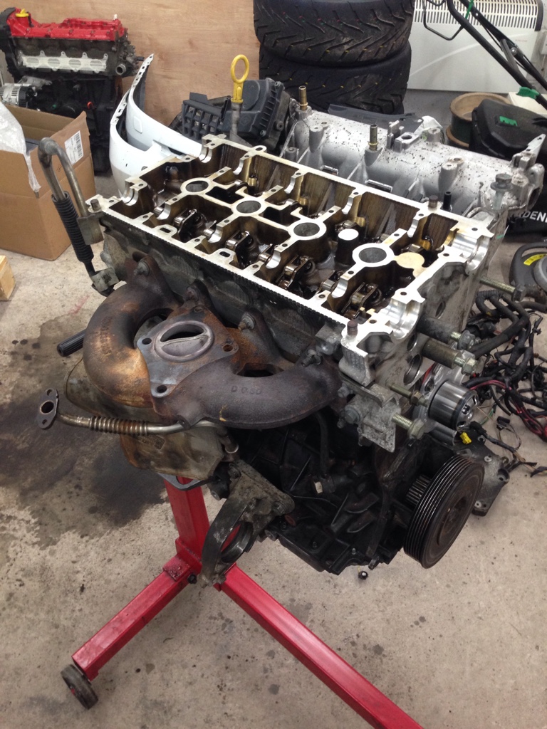

Got the cams and cover off to have a look at the top end, all looks pretty clean and well Looked after. Lifters and rockers all ok.
http://uploads.tapatalk-cdn.com/20161021/66acaf17129e6f49e58ae58673d477aa.jpg[/IMG
Need to give the cover a lift.

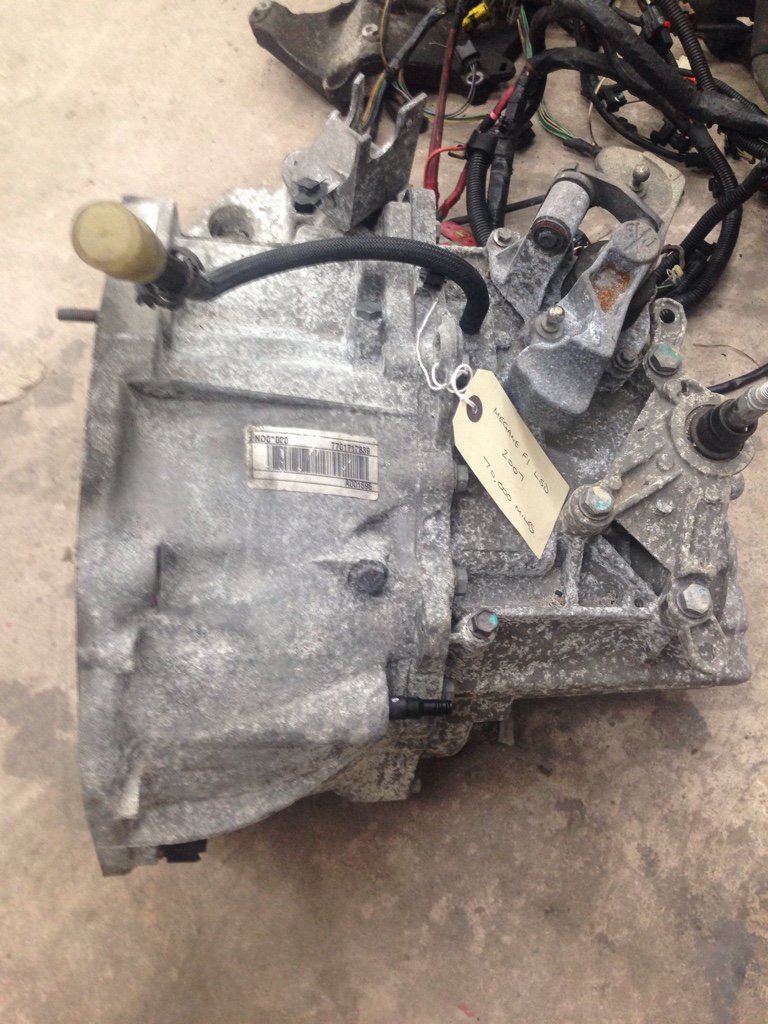

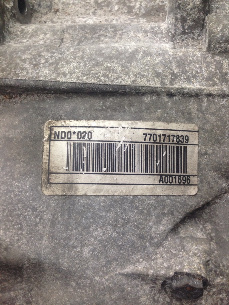

Picked the R26 gearbox up yesterday. Just need to give it a clean.

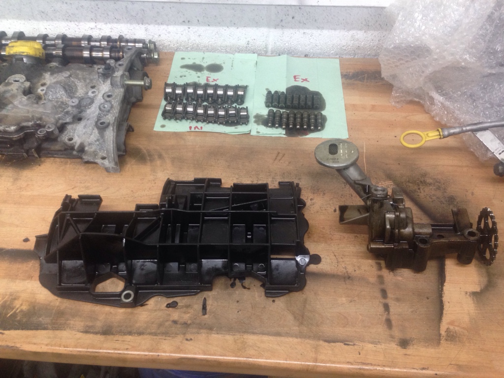

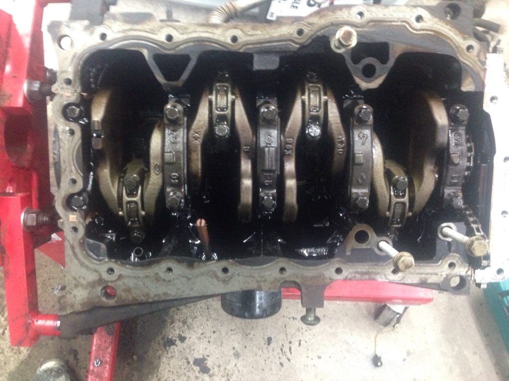

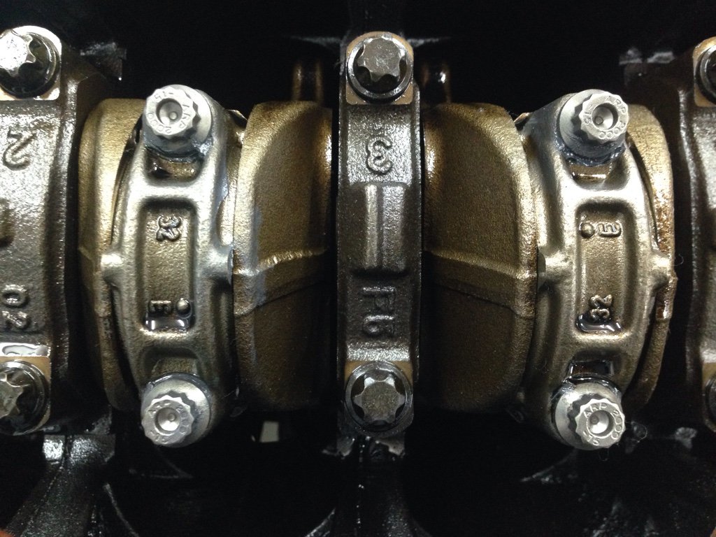

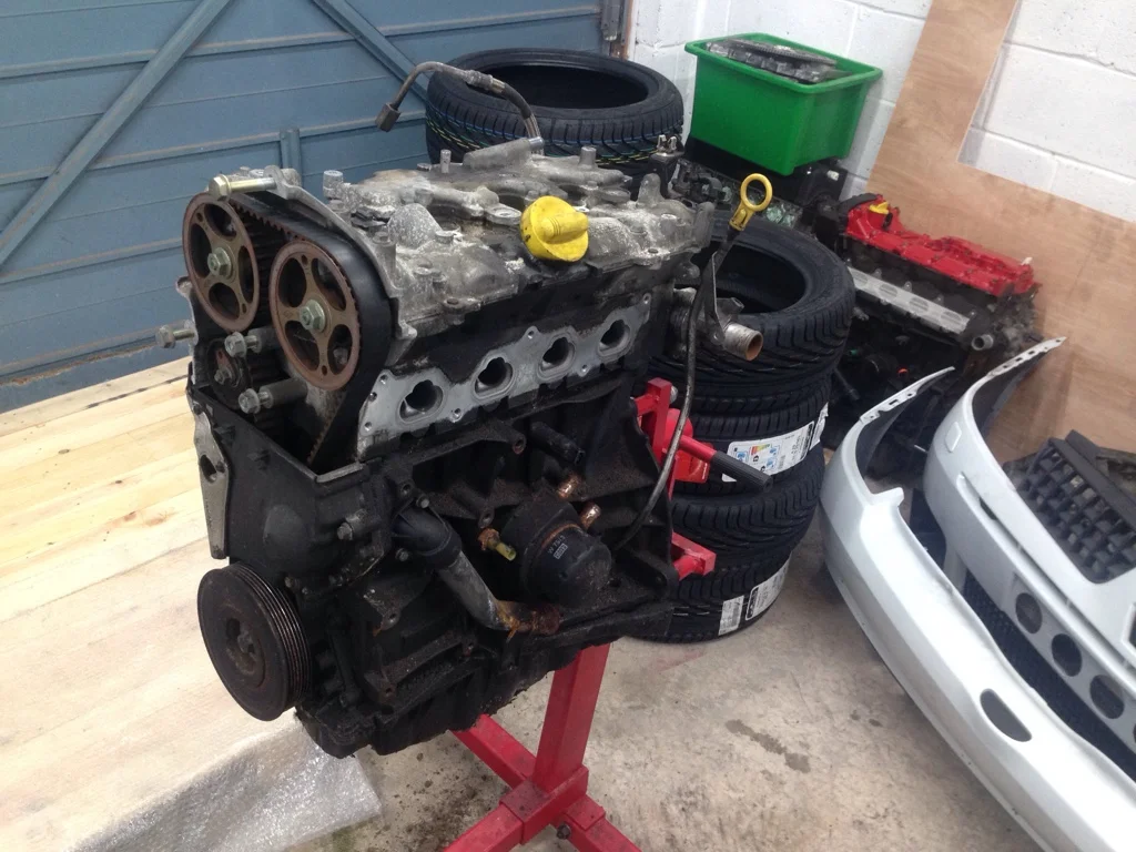

Stripped the engine a bit more so I can do the conrod bolts and check the bearings.

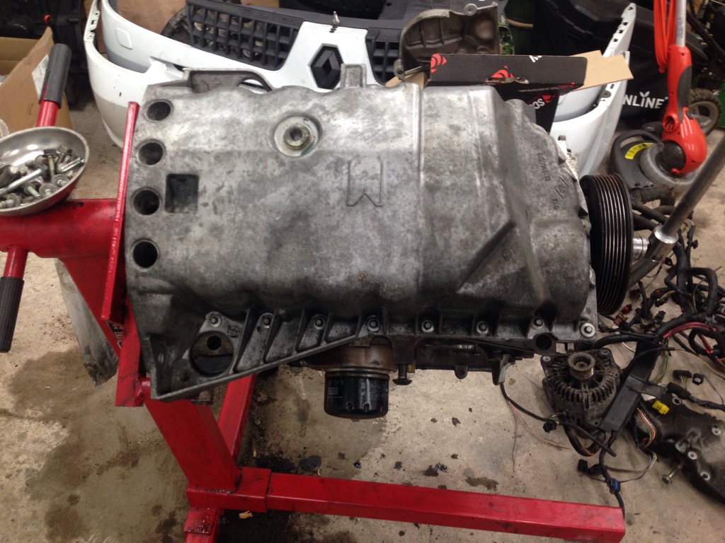

Windage tray and oil pump out, rockers and tappets out.

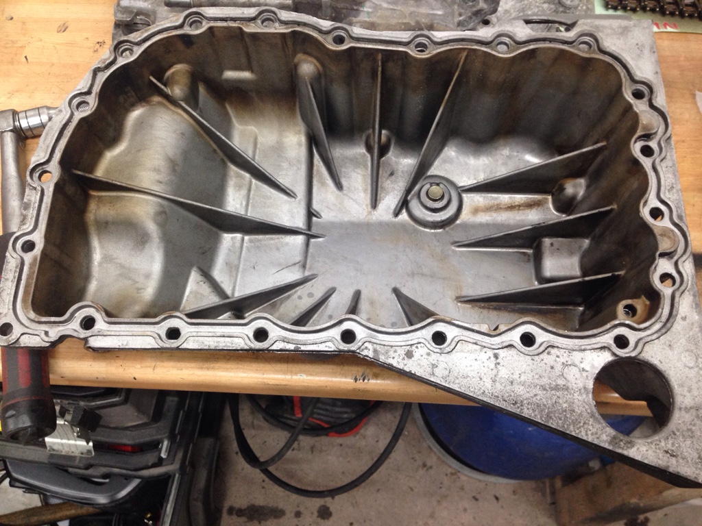

Need to give the sump a good clean in and out tomorrow. Already cleaned and degreased the block and it's come up really well without needing to paint it. Got the water pump gasket off easily too as they're not the paper style gasket as on the 1*2's they're a proper metal/rubber gasket. Be nice to start building it back up tomorrow, arp bolts in, sump back on, water pump in etc.

Got some of it built back up. Arp 'rod bolts in.
Gave the sump a good clean and refitted it with a new gasket.

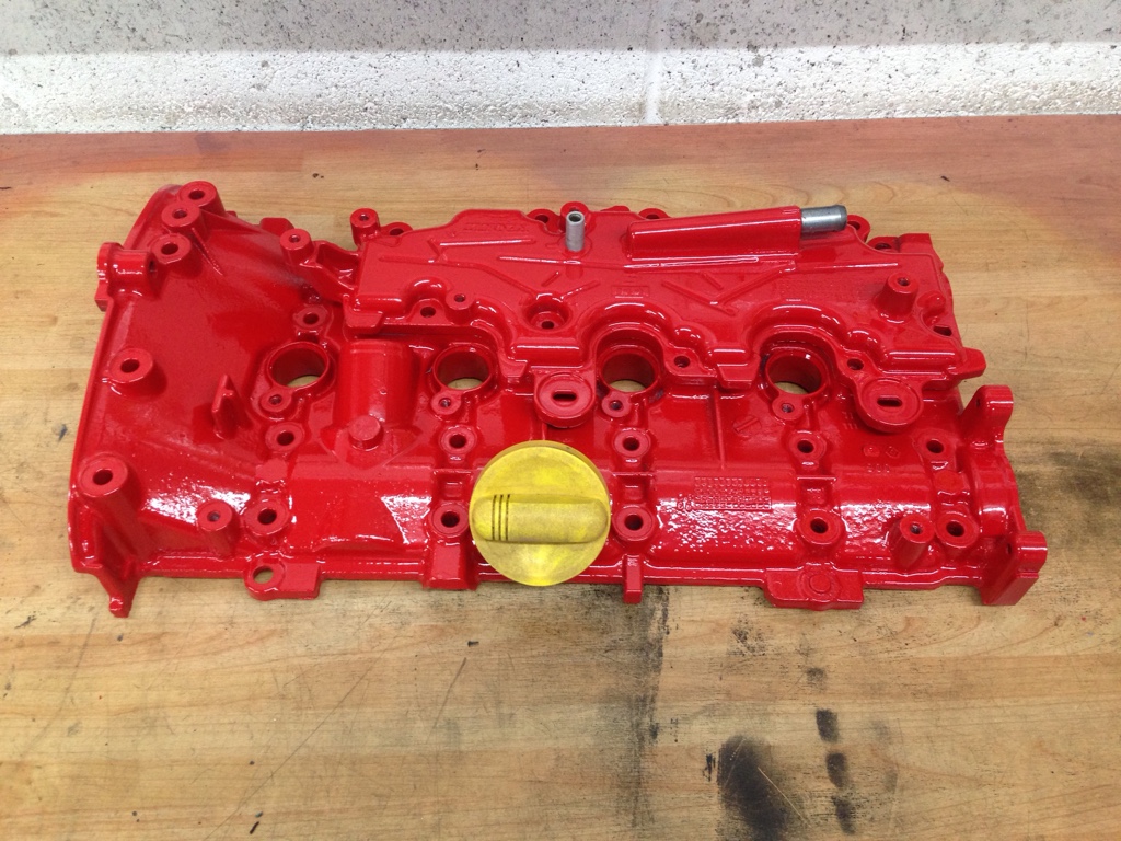

No rush as I've only just painted the rocker cover and breather plate tonight anyway.

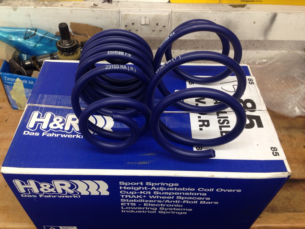

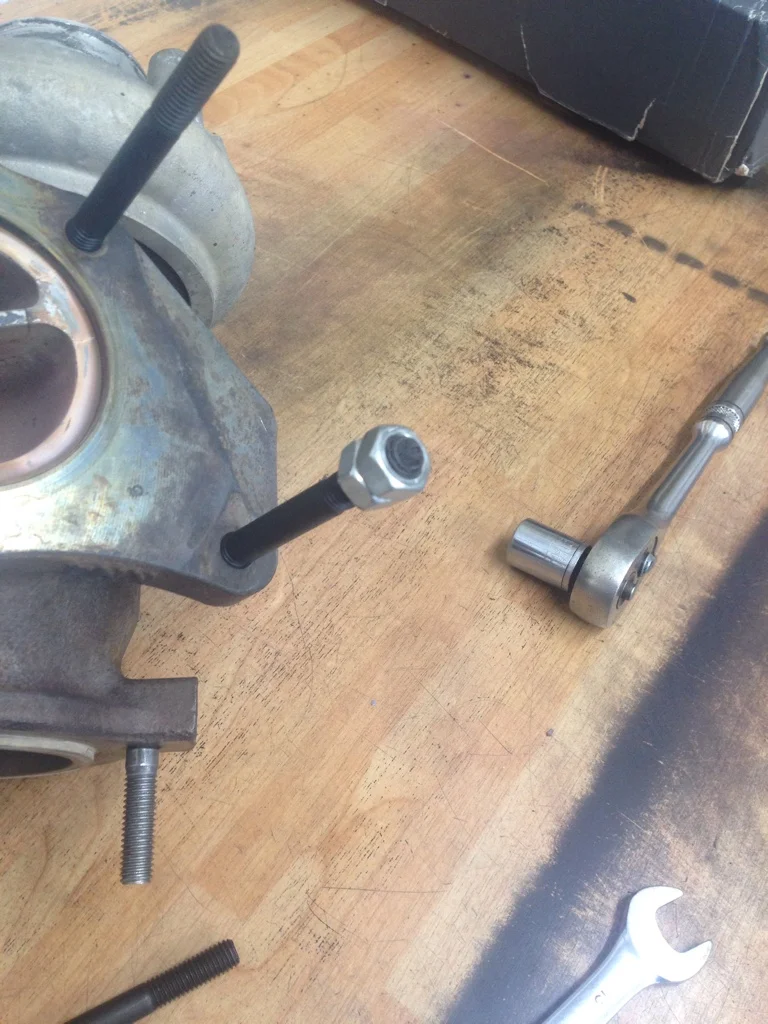

Few more bits collected, springs have arrived after being on order for 3 weeks.

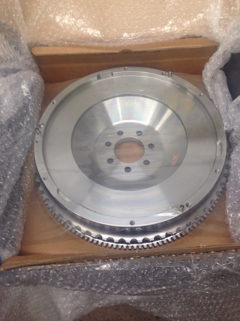

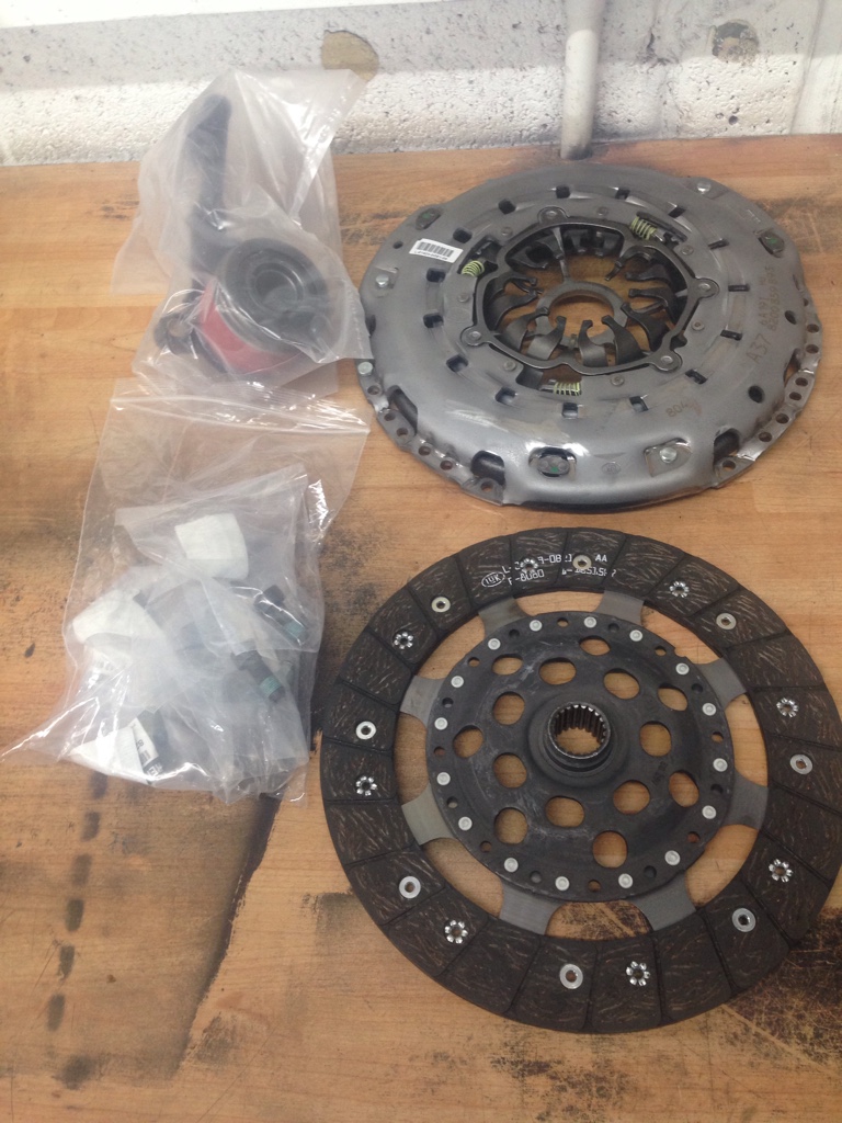

Unpacked the clutch and flywheel for a few pictures.

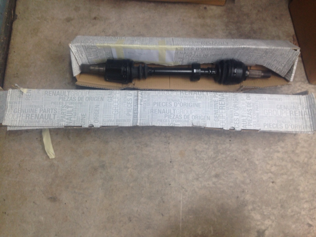

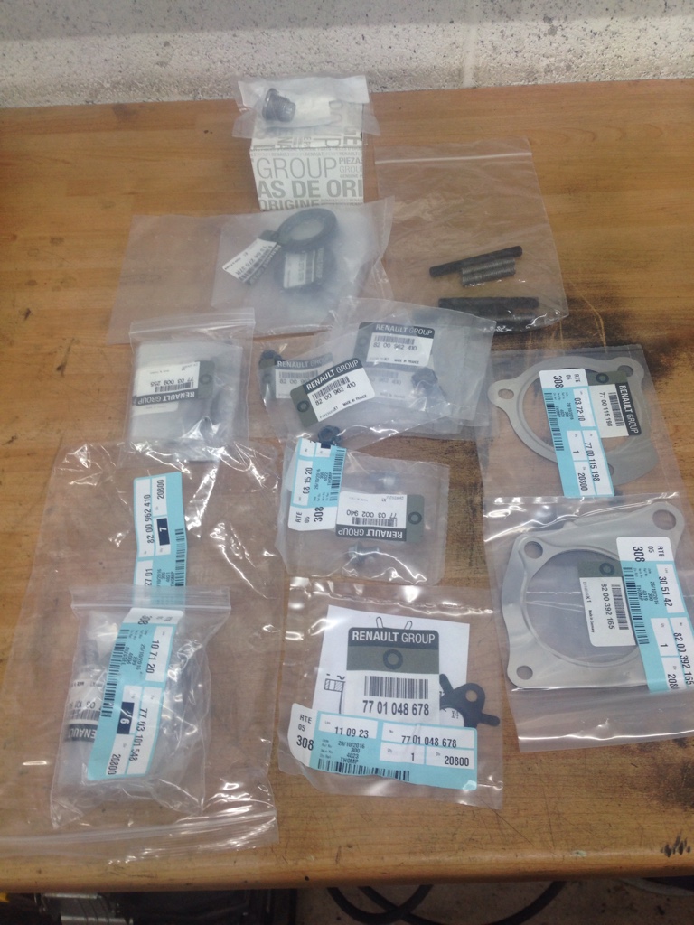

Picked up the bits on order from Renault. A load of nuts bolts and gaskets mainly along with a pair of megane driveshafts.
It meant I could bolt the turbo on properly with the new studs and nuts fitted + new gaskets.

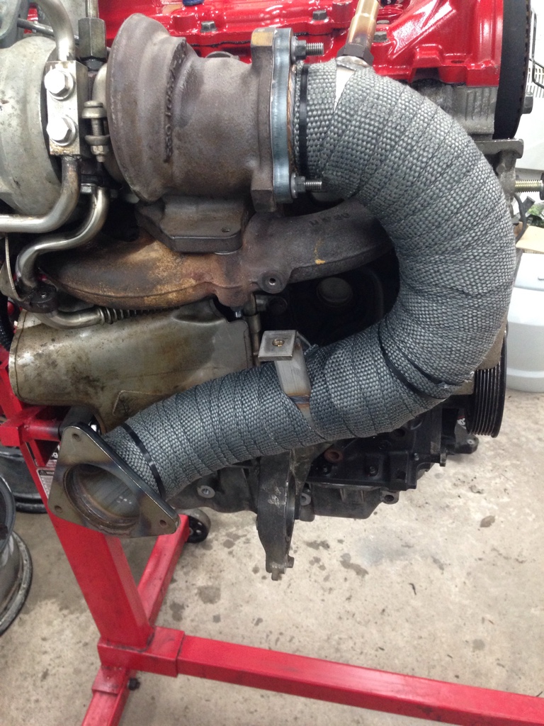

Got my heat wrap to do the down pipe however I never ordered enough! Still to finish once it turns up so just hanging in place for now.

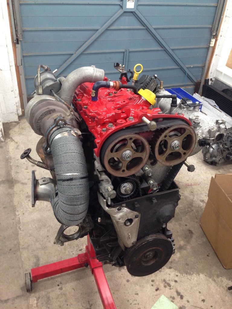

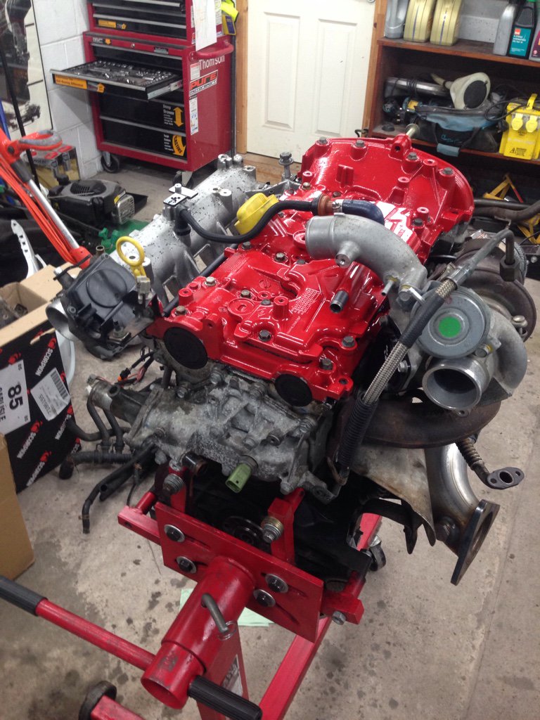

You'll Notice the cam pullies are on which means it's all back together and timed up.
I'm about at the point where I need bits off the Clio to progress, engine mount bracket, coils, gearbox bolts etc so need to pull the engine out. Will see how we get on for time this week.

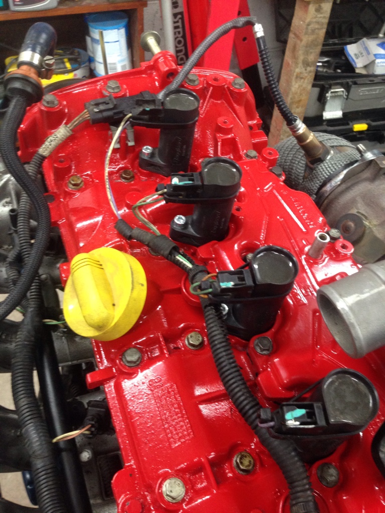

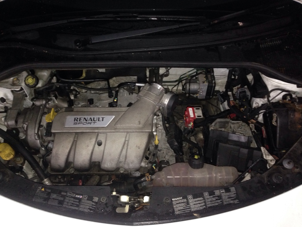

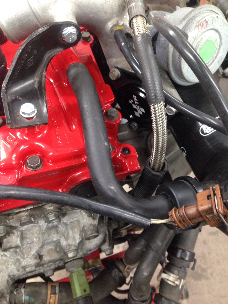

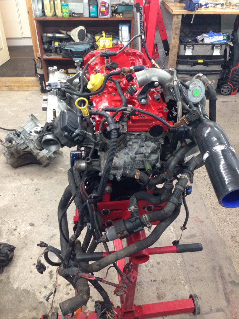

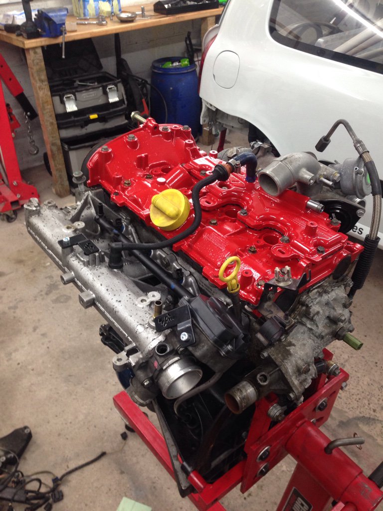

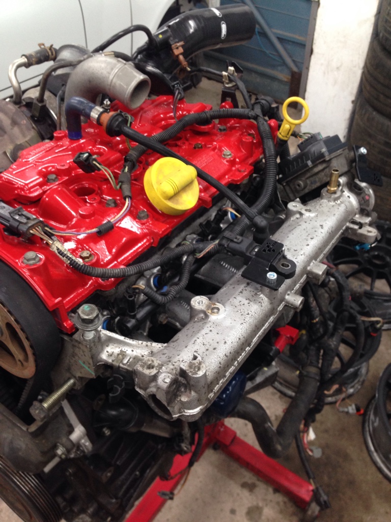

Chucked the loom and coolant pipes on the engine to see what's what. Got the sensors plugged in that I have. Short of a couple still.

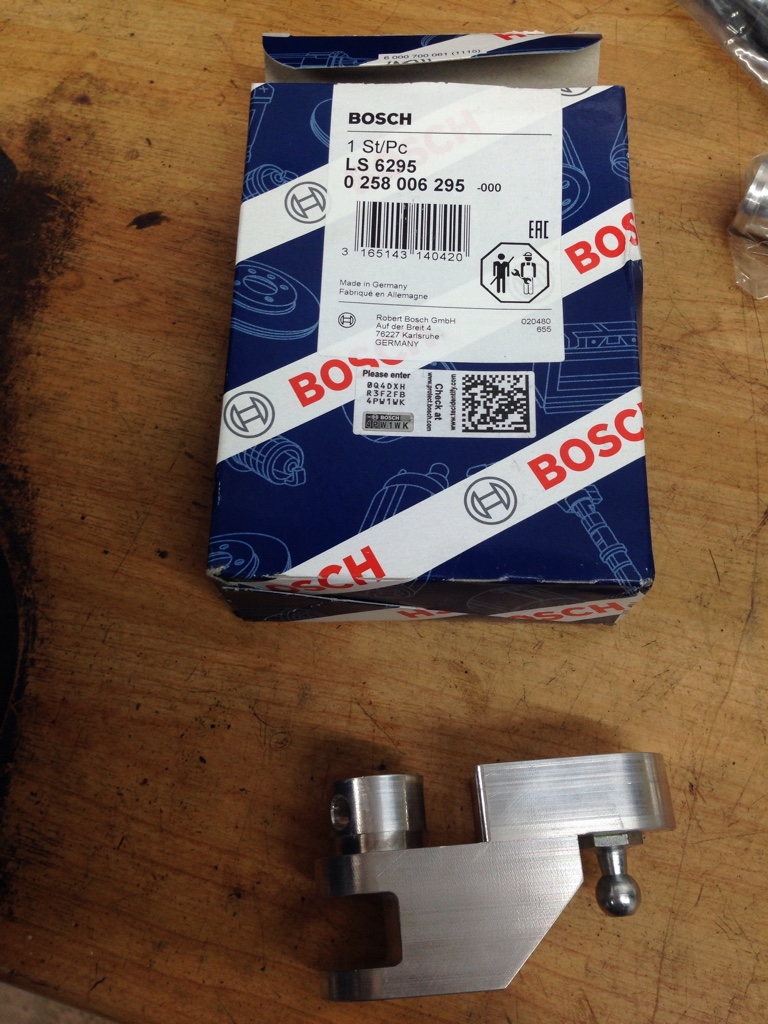

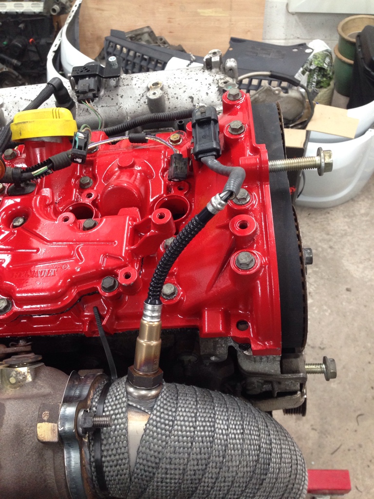

Got the new Bosch lambda fitted, pic shows my new short shift linkage from engine dynamics too.

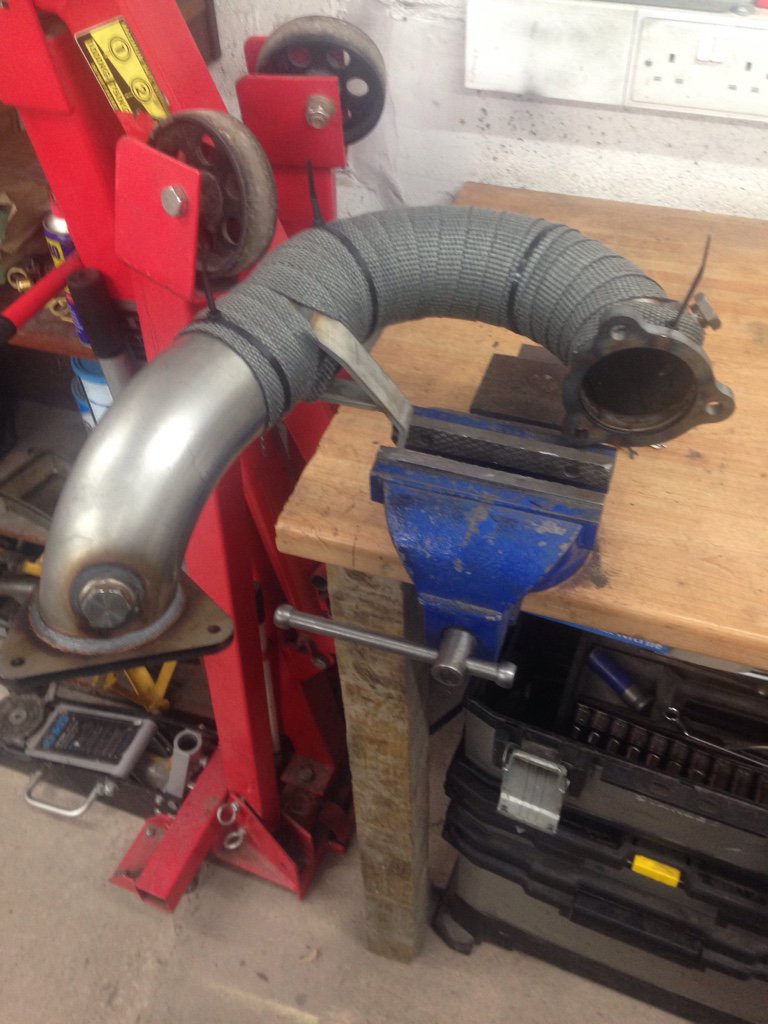

Also got the downpipe re-wrapped and bolted on.

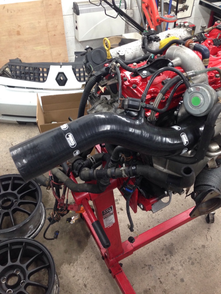

Samco inlet turned up so just chucked it on along with the boost control valve and piping. It'll probably need cut shorter once in the car anyway.

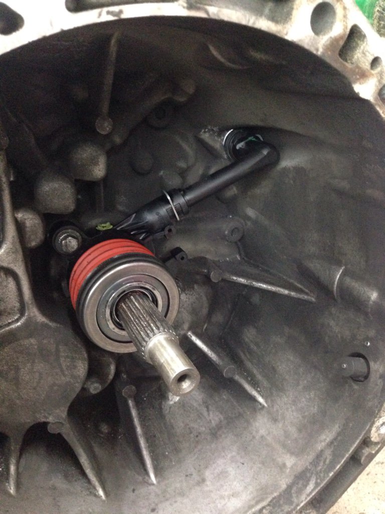

Last of all, put the new concentric slave cylinder on the gearbox. Have the quick shift linkage to fit too that I'll sort tomorrow hopefully.

I hate the slave cylinder design i.e. a join in the plastic pipe and no retention of the connection where it passes through the bellhousing.
We had a new one fail at Oulton Park (pishing fluid out of the joint) on the Friday before Saturday race day - It was a busy Friday night at Brosport (thank you Dave Hudson)!
I believe LUK now do one thats a one piece metal pipe with a bellhousing retaing collar (well I'm sure I've seen one)
Russ Rallye
We had the same thing in one of the race cars but reckoned someone was a bit rough putting it back together after a clutch/gearbox change.

  Clio 182
Use lockwire to hold the heat wrap in place - it's cheap and once you've got a reel of it you'll find a million uses for it

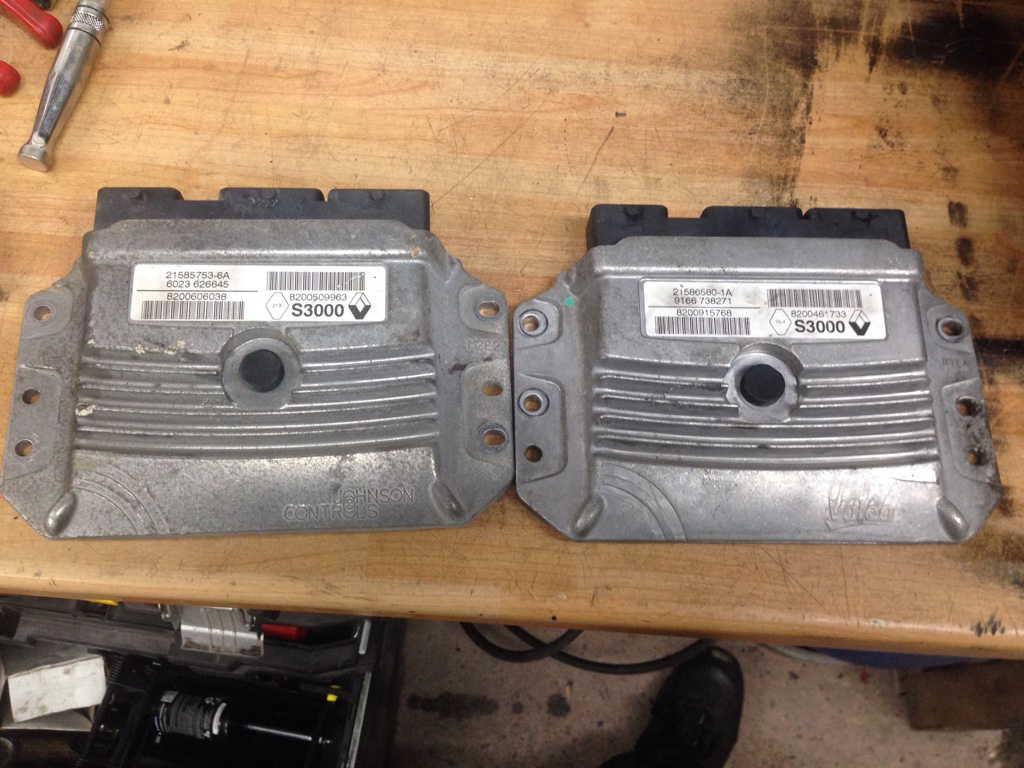

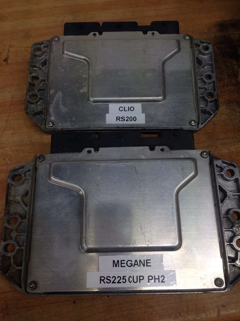

Started stripping the Clio last night. Just got the battery and air box out really.
Got the ecu out as well and it's currently boxed up along with the megane ecu ready to go and be unlocked.
Couldn't help pinching bits as I went. Swapped the coil packs over.
Sorted some breather/vac pipes out on the new engine too.

I was waiting for someone to notice! Thought I had some stainless ones at work but I've had the stores upside down and can't find any! Trying to avoid buying some as they're a rip off!
Russ
Will normal metal cable ties you do up with the guns not work? If you have a gun I have loads I can send you a pack if you want..
