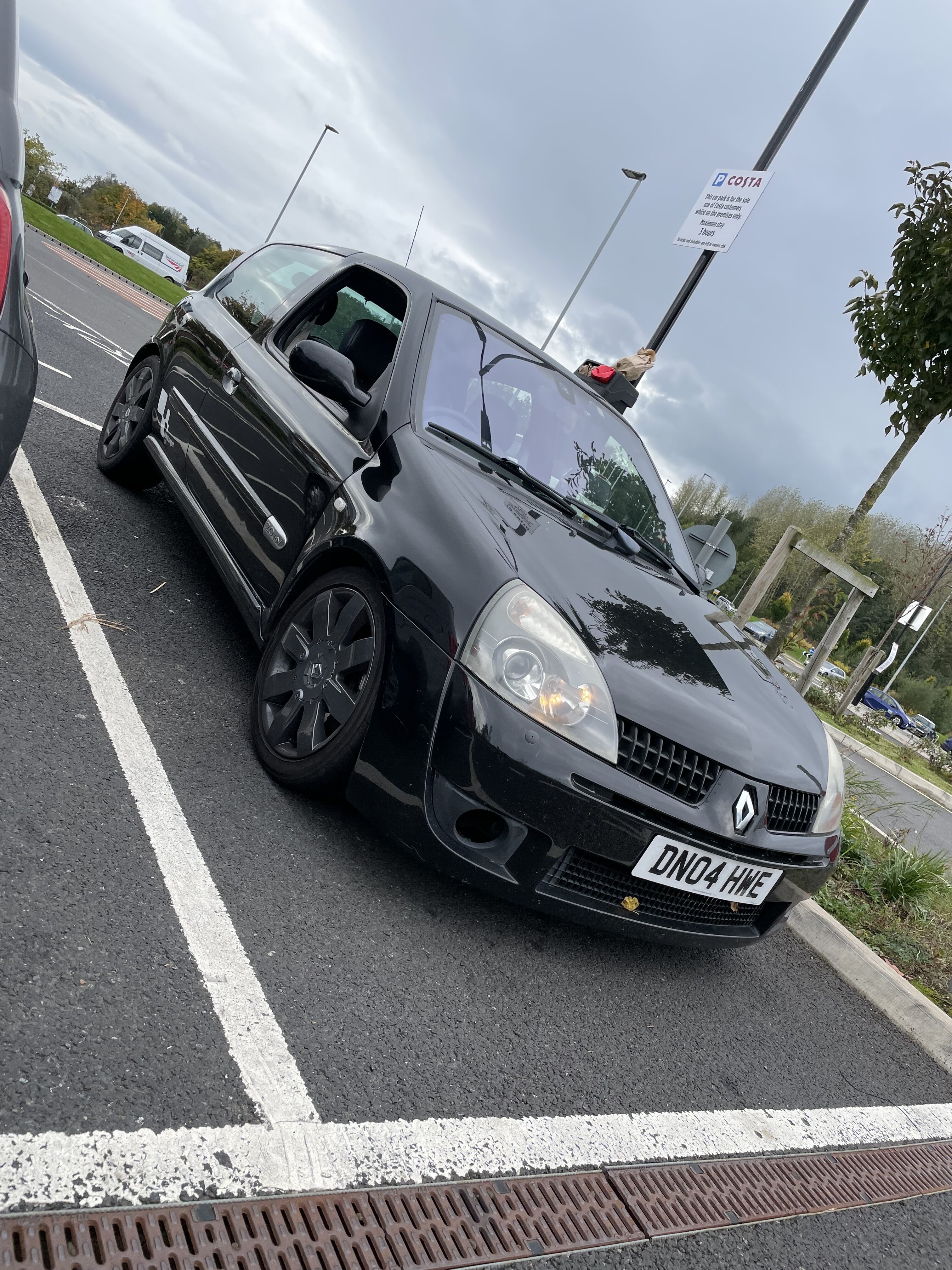

Well, after a few years and many different motors I now have another Clio. Although my last one was strictly track, this one is a little more tame.
‘04 black 182 with the cup pack collected this morning. 197 cams, milltek decat and non res (May need a res section but will see…) and Lowered. Forgot how much fun these little things are😈
It’s no show car, but needed to scratch the itch seen as I only work 3.7 miles away from home and the Mrs has a Q5 as the child wagon…
