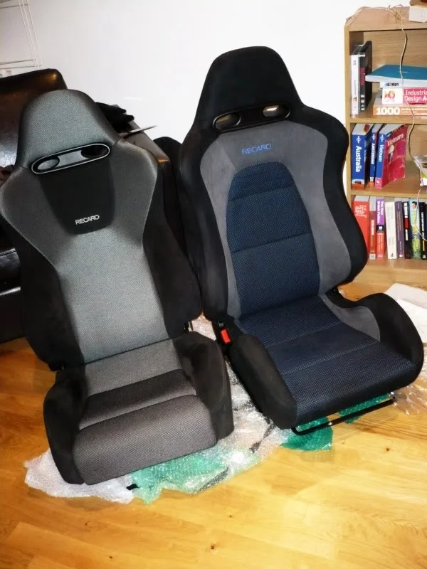

jenic: I haven't got any pics of them in yet - but i'v got a pic of one of the Evo Recaros (the one on the right) next to a Trendline that i trialled first.. interesting to see the slight differences betweent the two! (Bigger side bolsters, no extendable leg support, different panels/stitching)
