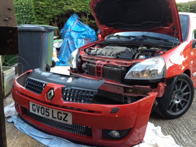

Day 2 of ownership of my little 182 Trophy, and we've hit a snag. Stopped mid journey for a drink,keyed off, then failed to re-start. Bumped it, and got home. Then didn't start once home, not even trying to, but found a thread about the immobiliser getting upset, and overcame that by cycling the key to position 1 a few times. So, with the immobiliser happy again, It started (somewhat laboured)...
Bonnet up, hot electrical smell...
Test kit out, idling at 12.4v, then drops to 11.something with all the electrical things turned on (lights etc).
So... Can someone please point me in the direction of the "how to remove the alternator" thread, as looking at it, It looks as though they built the car around it, and that it's in there for life!

Bumper off job unfortunately.

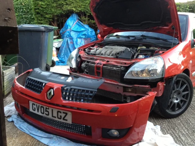

Bumper is off!
LH wheelarch liner has been chewed apart, so added that to the parts list. Am off on Holiday Saturday morning to Scotland, so might end up taking the Elise on the driving tour, rather than the new Clio (so no aircon, bugger)
Am hoping that I have got the car to a stage where I can collect a shiny new alternator from somewhere tomorrow, throw it on, test drive, find all is fine, then take the Clio.
Condensor doesn't look like it's got too long left either :banghead:
​All good fun!

Not the "look at my lovely new Trophy" pictures I was hoping to upload!
Apologies for it looking as though I'm working on the car in a junkyard - I'd sent the servants home, and only then realised they'd left the bins and a tarpaulin covered heap of kit lying around!

Am off to Scotland for the week tomorrow, so it can sit on the driveway and think about what it's done! Need to order a tool to reduce the aux belt tension to get the alternator off. Searched and found a suggestion that you could use a jubilee clip around the self-tension spring.... Buggered if I could get that to work!
  Elise, Trophy #31
Back from holiday, alternator replaced, all repaired! Now to start looking at getting it looking its best, and refurbishing the suspension!
