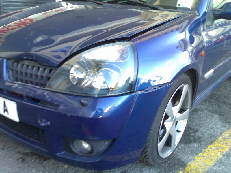

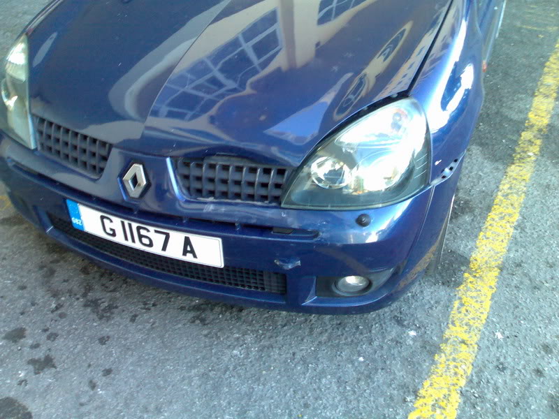

It Finally happened guys, what you guys predicted, i would have an accident, dont see it much us my fault but heres the story....following an old man out of a give way on new years eve, he decided to hit the brakes hard....the round about was in an area where housing development is going on, so there was alot of dirt dust....coming out of the round about, at less than 5km/h the guy hits his brakes my car skids in the dirt/sand and i hit the back of him....quite sad, and im really depressed about it...here are two pics...

Obviously a replacement bonnet would be required. Notice the there seems to be no damage to the headlamp. You could pop the bumper off the car, its easy to do.
Simply undo the 2 10mm headed bolts underneath the car on the metal tray thing, then open the bonnet and undo the 2 fastners on the slam panel. Then on each wheel arch there is a bolt. Its on the forward face of it, you can pull the wheel liner away with the car on the road, its slightly awkward but can be done. Undo the 10mm bolt and thats it undone.. 6 bolts, 2 on the slap panel as in plastic catches, 2 in the wheel arches, 2 underneath.
Simply get each end of the bumper on the wheel arch, and pull it outwards..ie.. looking at the front of the car..pull it sideways, it will click out of place and then the bumper will drop. This keeps the bumper located. I thin you may have snapped the mount on yours. As the bumper is now loose, you need to ease it away in one piece from the sides, the top and the bottom. Once its nearly free, reach down and disconnect the fog lights, and the washers if fitted.
Then you can look at the car and see what is behind it, and what is damaged. The bumber may need replacing, or repaired if you can.
If you can get the parts painted, and are happy that no more damage is done its very simple to do...

As you can see on the pic aswell, the reflection of my dads super market...Ramsons....

Its not a bad repair, just pull the bumper and spray it, perhaps get a carbon fiber bonnet
Gutted....not too bad though.
Recommend a change in wheels when you get a chance as well....they look a bit bent as well.

Hope you get it sorted and you cant really see the pics of your dads shop so get some other pics up???

Joe...i dont think this emphasises young inexperienced drivers etc because its not like i was speeding and i flipped the car etc, it just happened, and i dont know how :( My clio sport to me is like my baby and wouldnt do anything to harm it and i guess you guys sorta feel the same about your cars but oh well its happened...estimate around £1,085 for a New Bonnet, New Front Bumper, New Grill, New Front/Left Wing and Labour...including paint :)

Will the bumper not repair?
Surely that bumper just needs to be rubbed down and resprayed?
