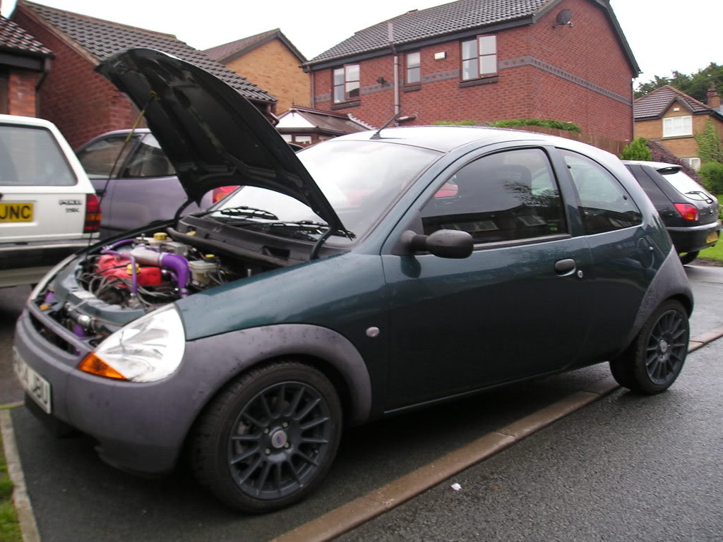

For anyone interested here's my ka

is that the ka that was at the club vec day?? looked awesome! i'm guessing its a fiesta 1.6 turbo engine?

Yeh it was me at the club vec show. Cliosport stand was looking good:cool:

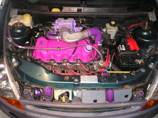

Current spec:
ENGINE
Fiesta RSTurbo 1600CVH EFi
0.5mm oversized pistons
Piper T2 Cam with vernier pulley
Superchip 165
Brass bleed valve
Uprated Actuator
Powerflow 2.5" bore exhaust with letterbox tailpipe(very chav lol)
DIY Mesh air filter
Samco & SFS Boost/Water Hoses
Sierra Cosworth 2WD intercooler with custom end caps
GRS Alloy Rad (250% bigger than standard Ka item)
Pacet 10" fan
BlakeyCreation Mount
Puma 260mm calipers + discs
Sparco "corsa" buckets
Motordrive flocked dash
Ford racing wheels
Stripped interior
Planned to be done soon
T3 Turbo
Bigger intercooler from GRS
Custom chip from MSD
Esc Cosworth fuel pump
Beige injectors
If there is any cash left i'll get some Willwood 4 pots

"pinkest (by which i mean gayest) engine bay ever! :p"
Ideally suited to the ka then! lol I prefer it to the usual blue/chrome found on most fords:rasp:

As for the engine, at least you'll no it was built properly and carefully and ever since cars like his i've always thought twice about who I line up with...yours is no exception. I'm sure you embarrass a fair lot of people!
The power now is around 140-150bhp on low boost. Once the t3 and other bits are on i'm aiming around the 200bhp mark, I'm not really bothered if it doesn't make it to 200, the t3 will make the car alot quicker and useable in every day conditions.
