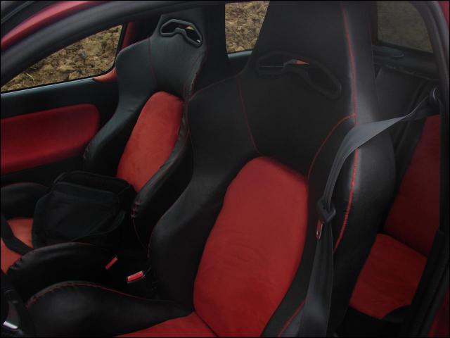

Since the last time, i've finished to make my new interior. I' can't explain all the pics because of my poor vocabulary but a lot of pics will make you understood how I 've make it!
The starting of the bucket seat:
Without cover
the cover
The back seat which I cut:
And after 7 mins with a rotary grinder
the new foam
with the glue
Then I've make the shape with grinder
with cotton above
And the new cover
The new cover of the back seat
and the cover in the car
the second started
and the Starting of the lower seat
the foam like the back seat
glue
the cover
and the seat finished
on the seat
I've bought big foam cube
to make new side for the bucket seat
cut in four
and the shape of the new side
And I tested it in the car, it was a perfect fit
So i make the final shape with the rotary grinder
the second
The first seat finished
And a view of the 2 seats but the second is not finished! Don't take care of the floor but the foam and fasten was everywhere
And I make the 2 bellows (?)
In the car
the rear of the car removed
And the new one
How I made it
The front one
Néoprène glue
the front panel
and another piece
and finished
The second
And the end of the second seat

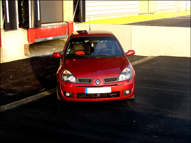

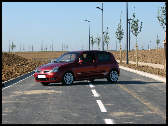

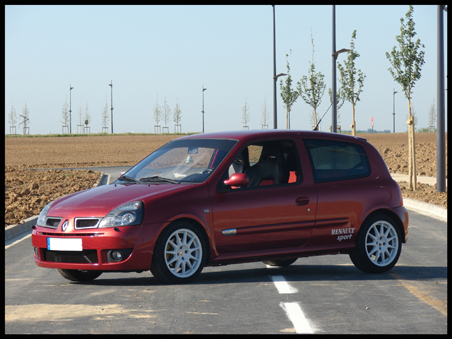

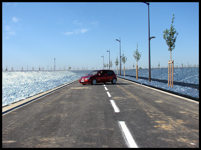

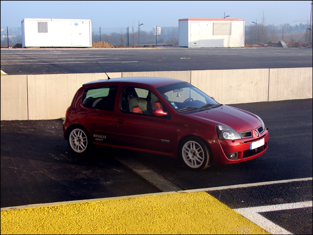

And to finish this long reply some exterior pics:
And with a little effect, you could believe that it was snowing in May!

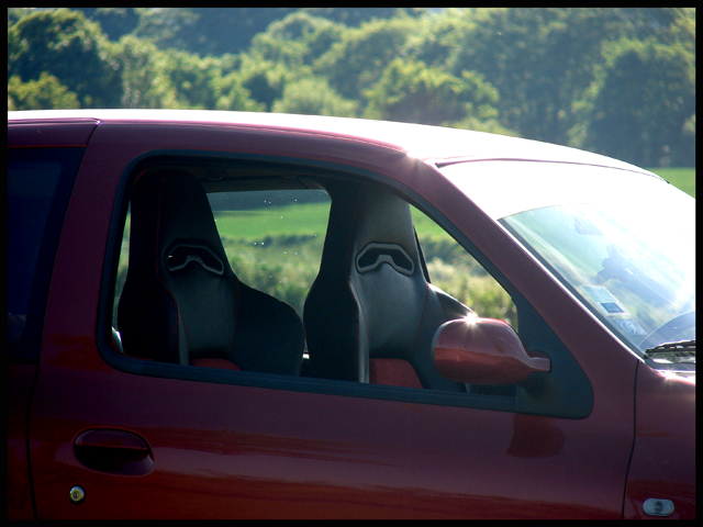

Hye all!
Some news from my ride! :approve:
The interior:

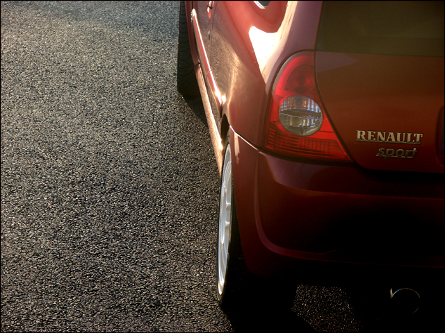

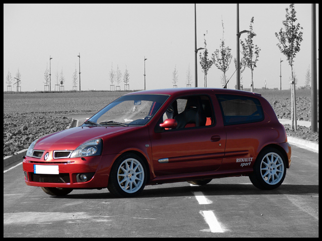

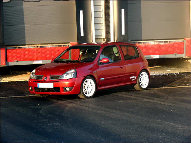

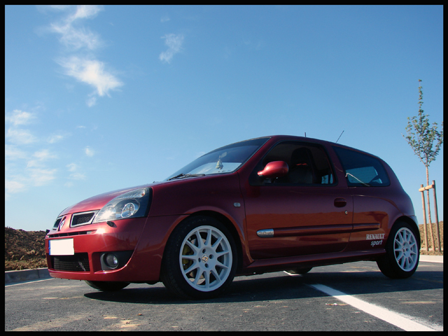

New rims, OZ F1+ in white to change from before! :D
and a last to see the offset (37)
nice! I quite like the interior. Don't like the grill think it should be the normal rs grill. Like the new wheels as much as the old

The foam was too hard and fragile on the leg side! So I décided to remove it and replace it like this and result is better than expected! :)
