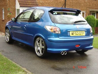

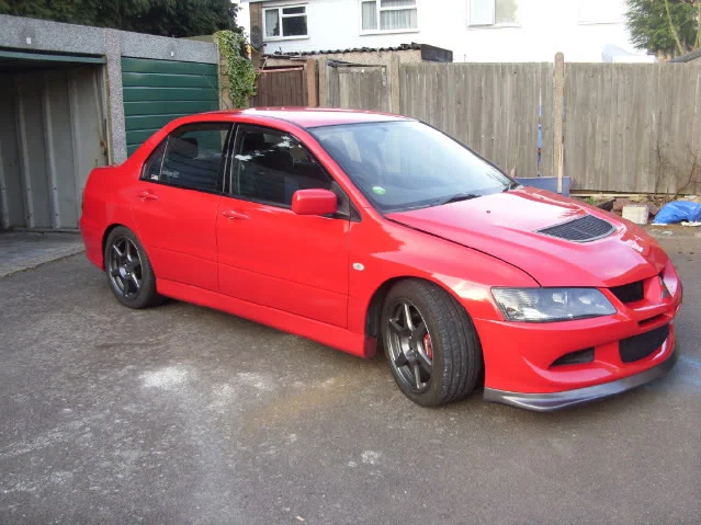

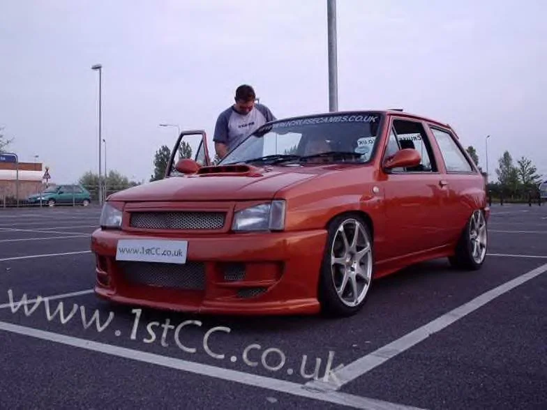

here are pics of my old cars
my nova
my 206 gti 180
my 206 and leon ( daughter was born so family car)
then my evo at snetterton
