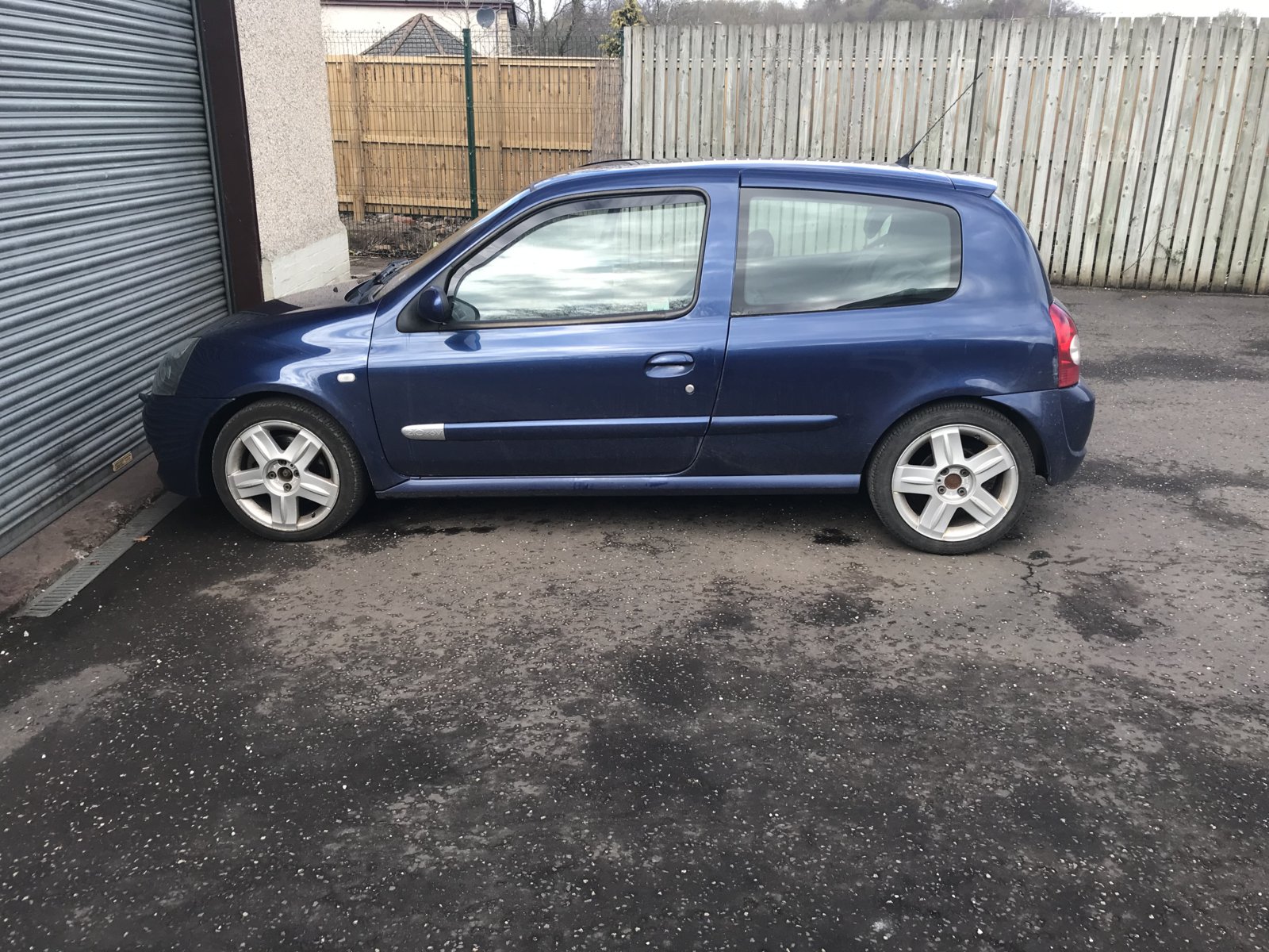

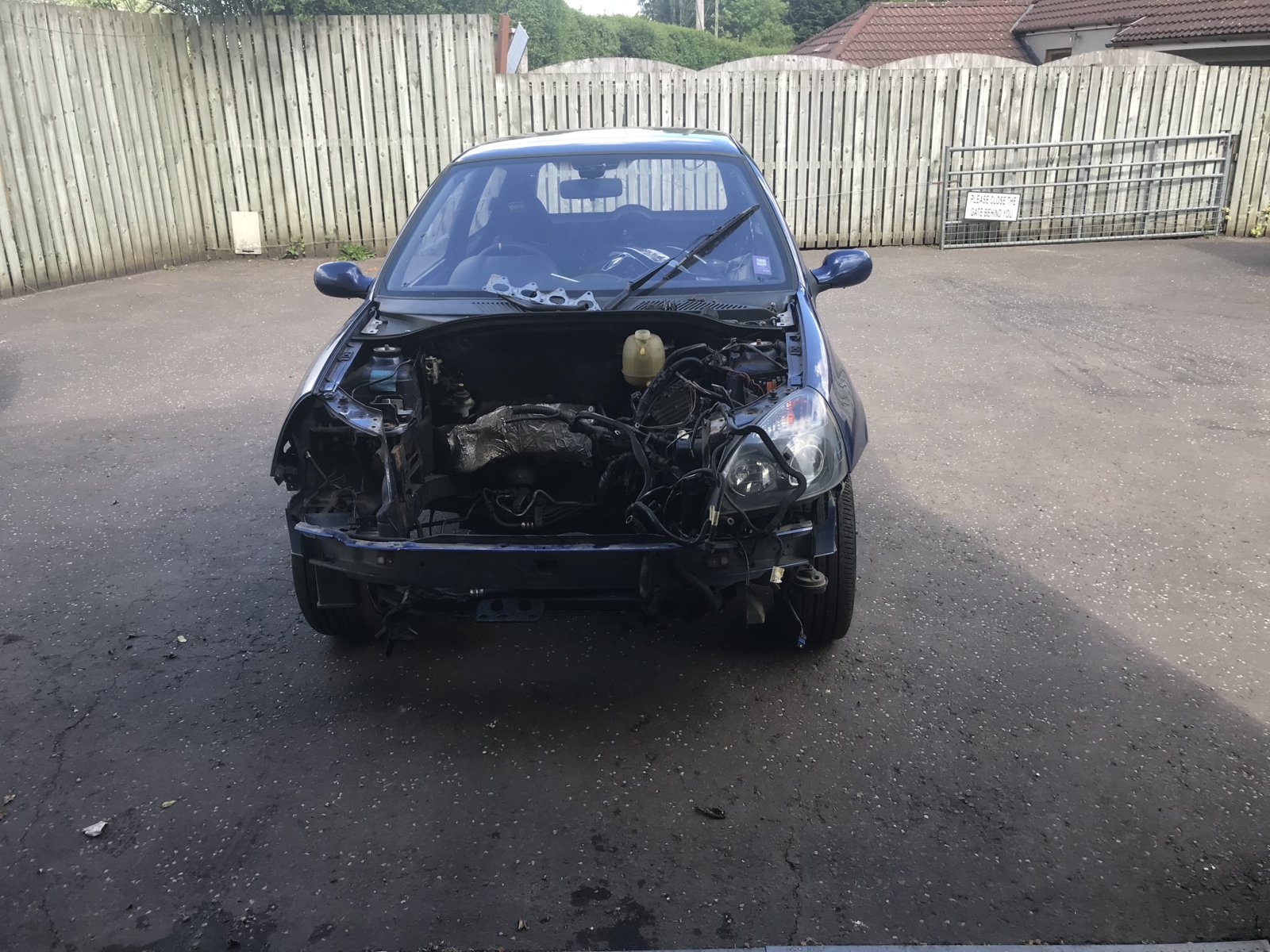

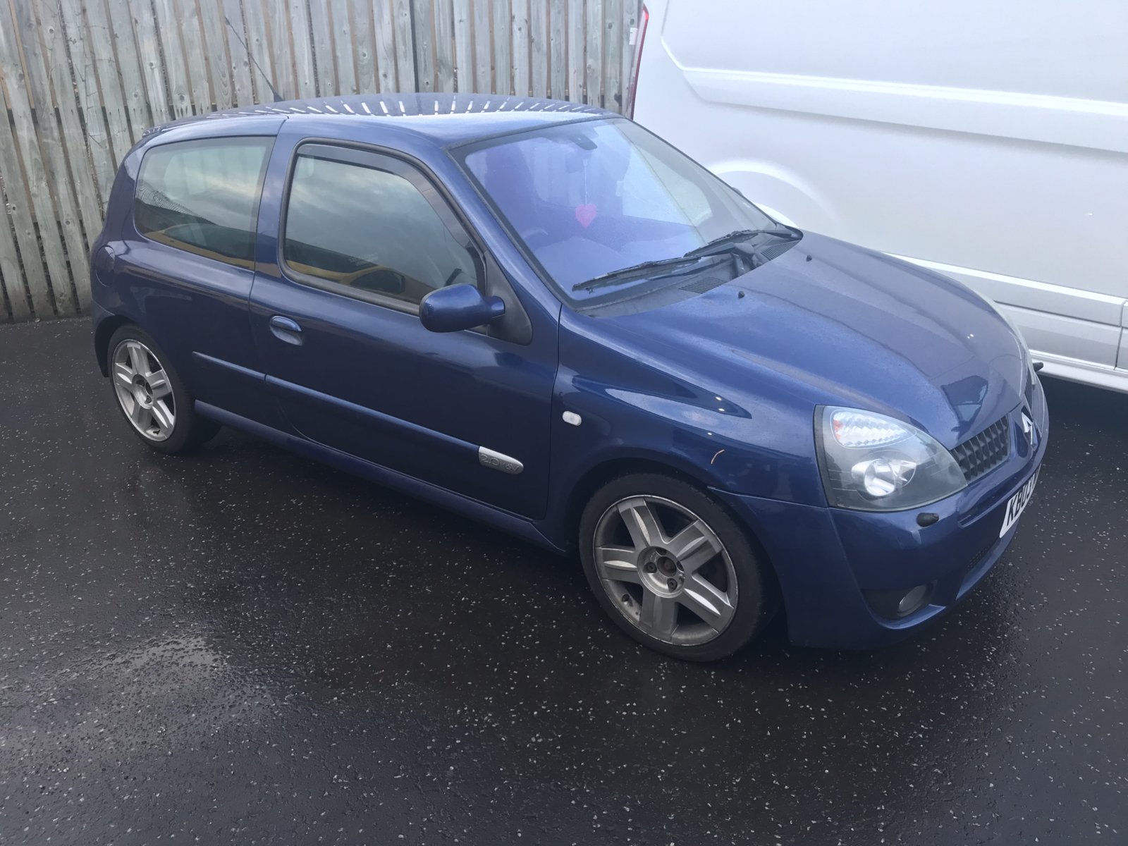

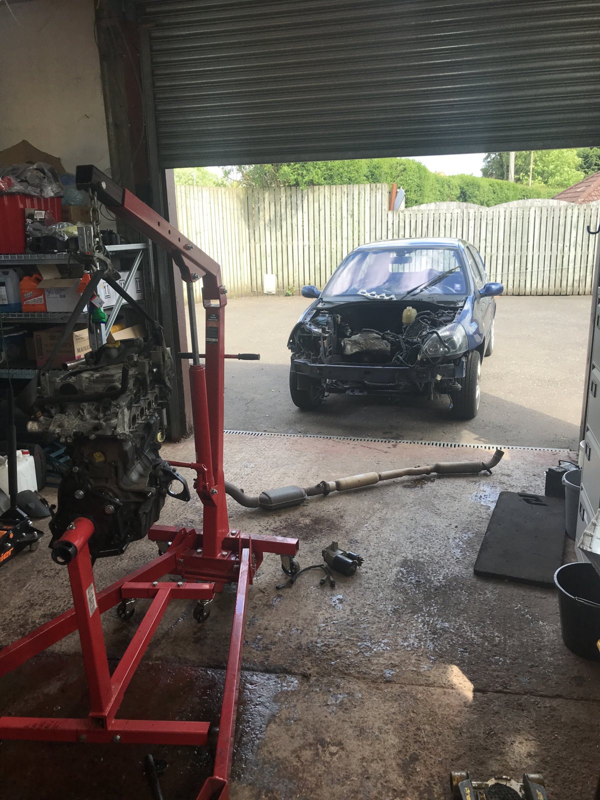

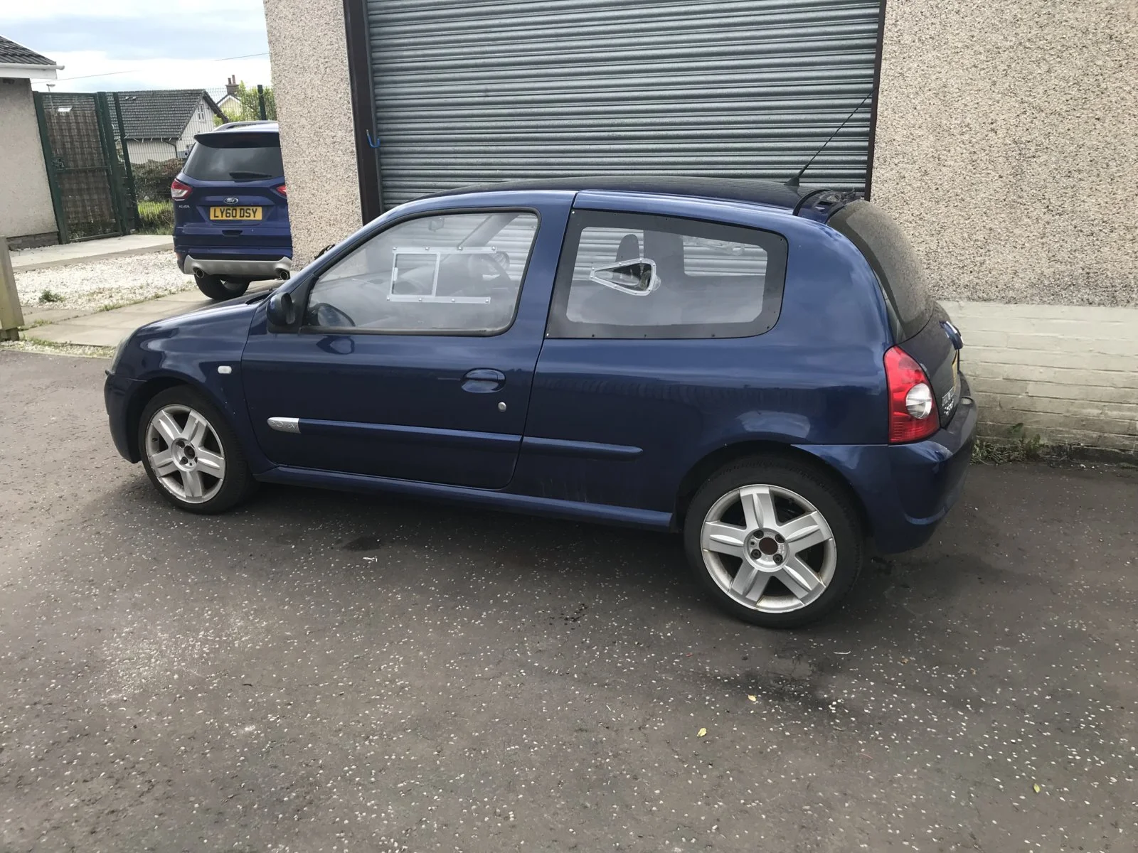

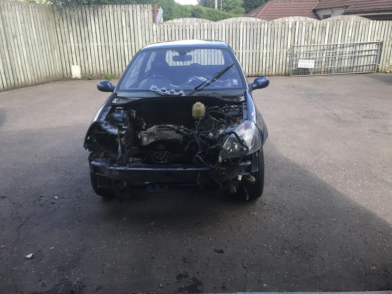

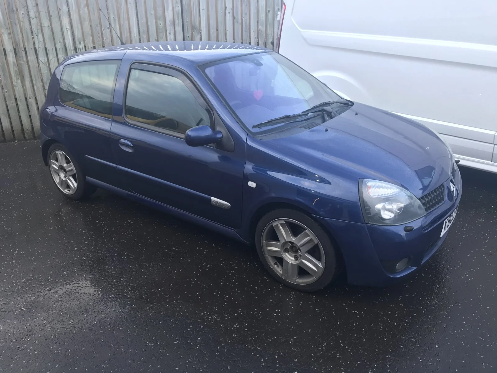

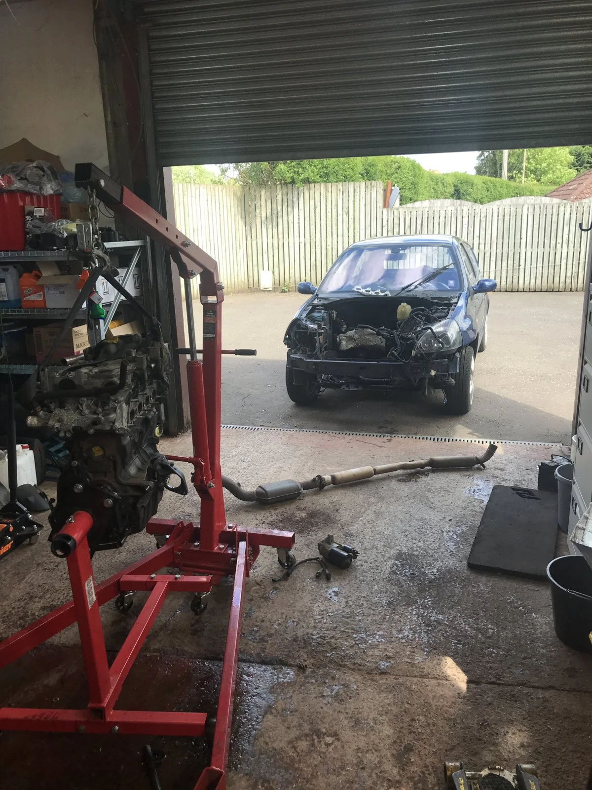

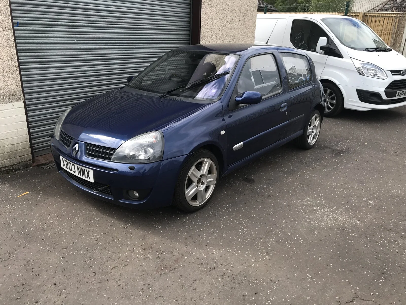

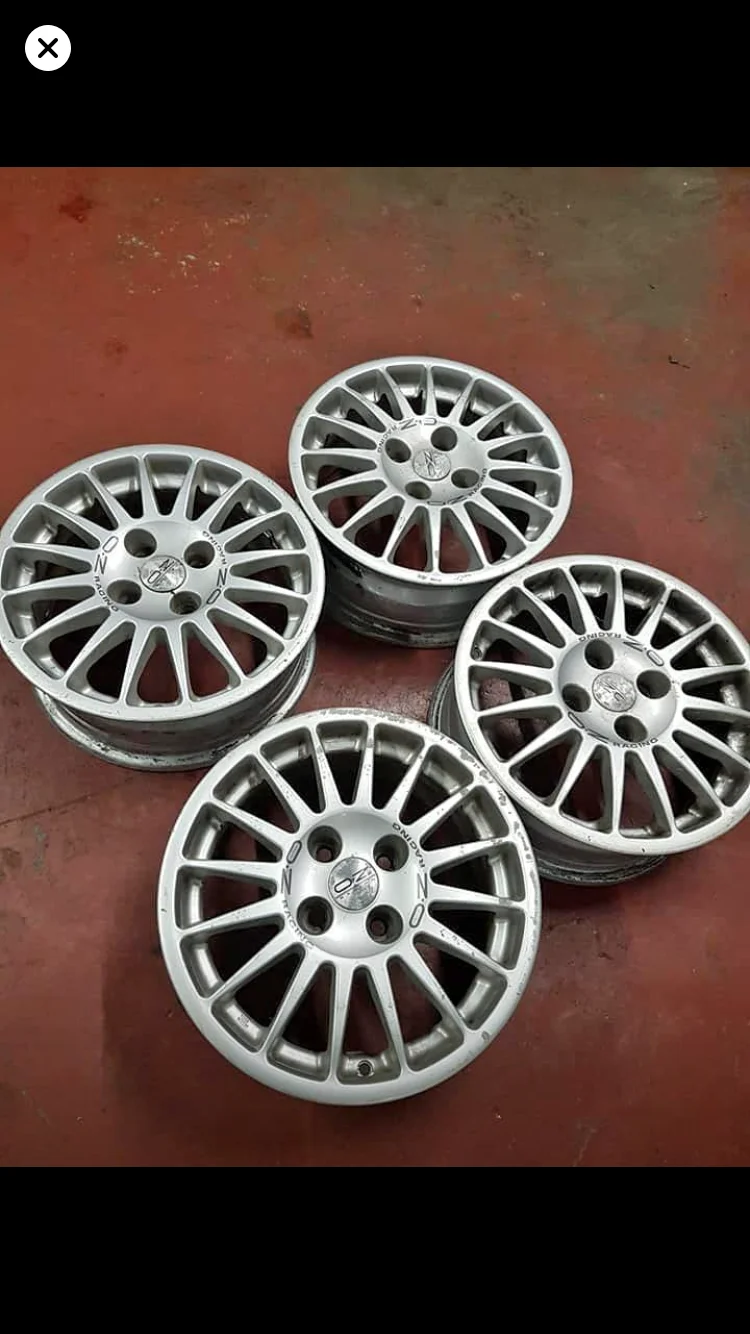

Hi all, Just wanted to introduce myself,
I bought a Clio 172 a couple of months ago and i'm currently making it into a track car for Knockhill.
So far i've got
Poly carbon windows all round,
Full safety devices cage (Still to get it powder coated),
OMP Steering Wheel,

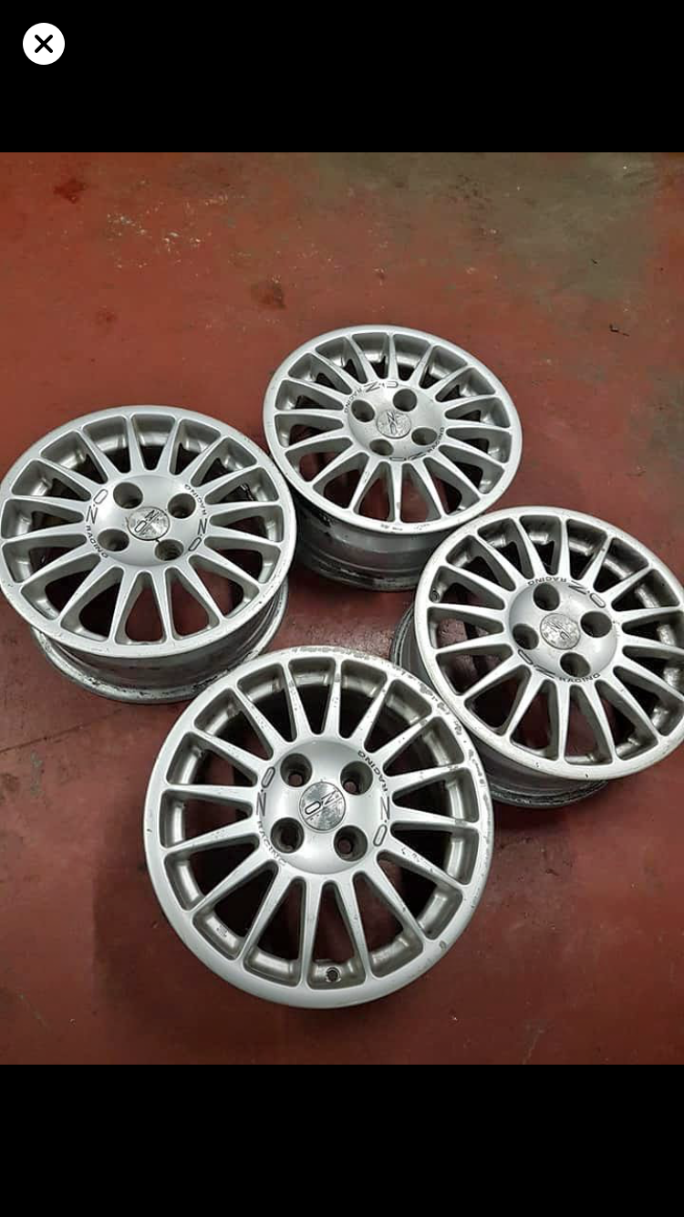

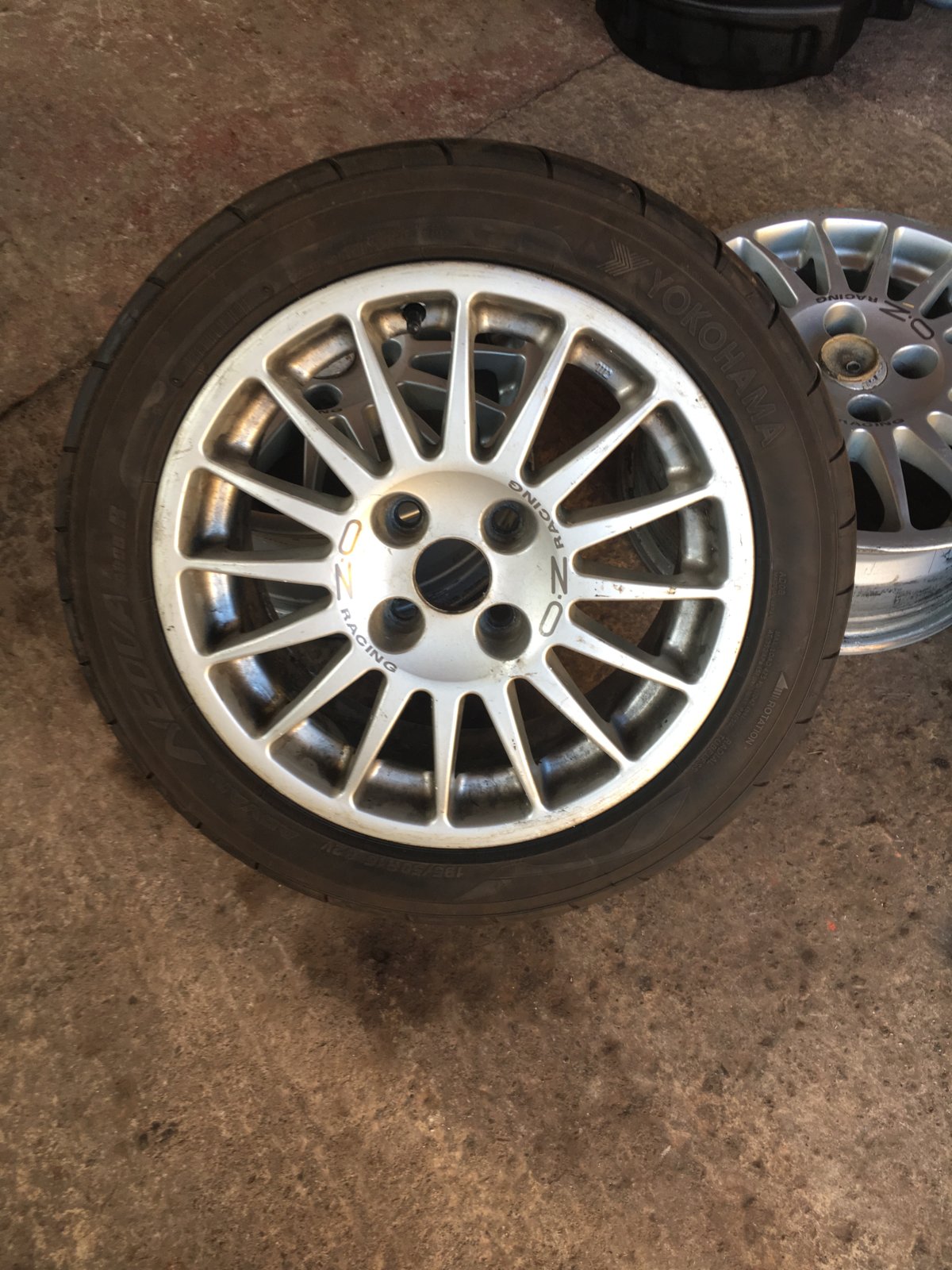

Oz Alloys (Still to get them powder coated).
I've ordered 197 Camshafts and the tool to time them with a 7% Advanced inlet.
TYP200 Brake Fluid (Used to be Blue i think it was)
Im looking to see what brake pads people recommend, I've been told Yellow Stuff Pads ?
I've currently got the engine out as i had a bit of an oil leak (turned out to be the cam cover)
But i thought might aswell strip it and relap the valves back in and replace all the gaskets etc.

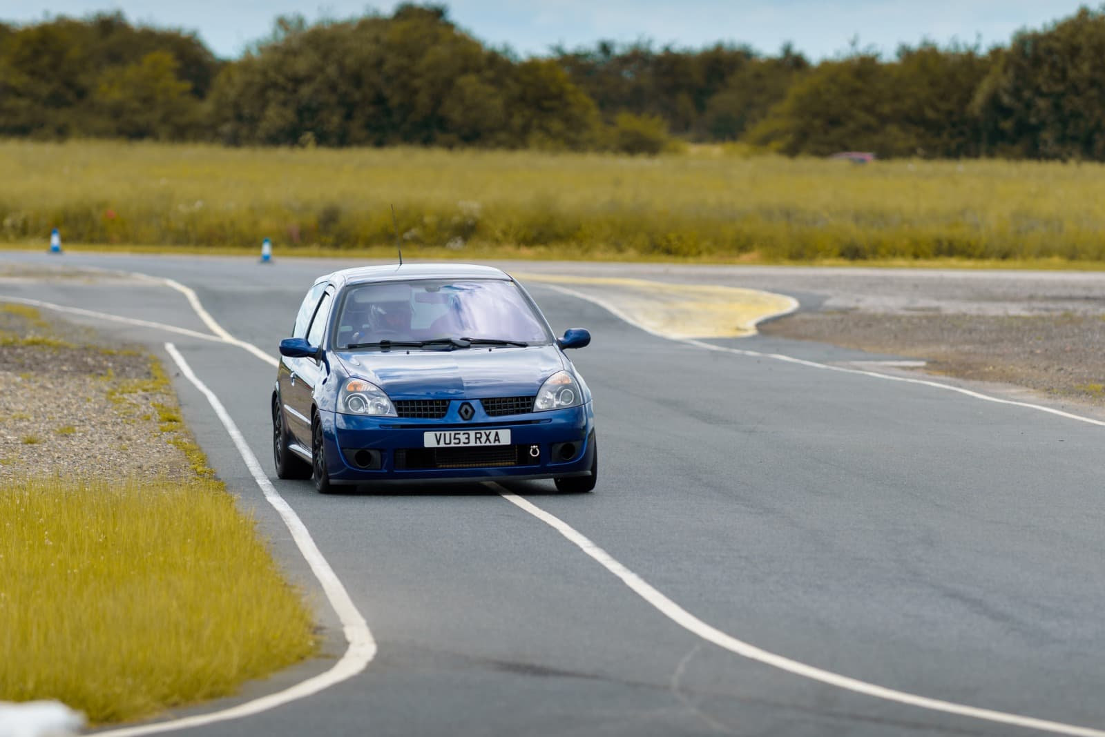

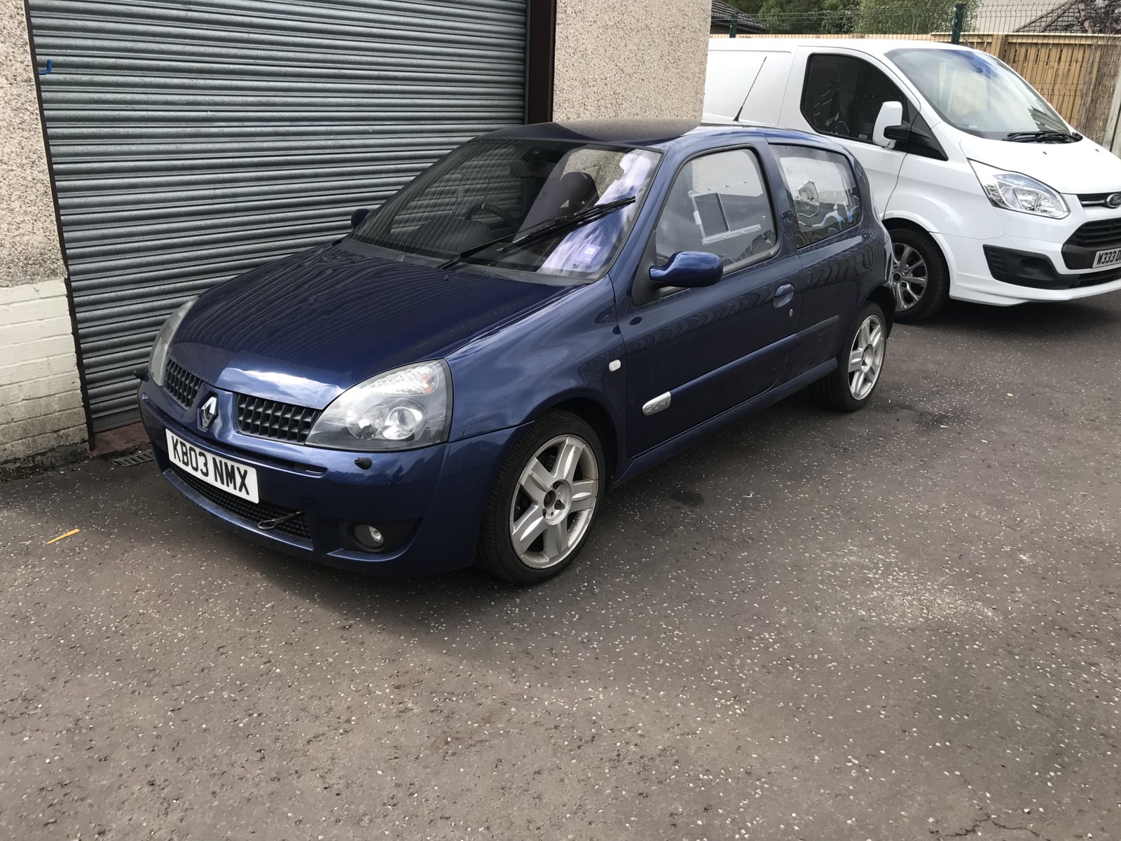

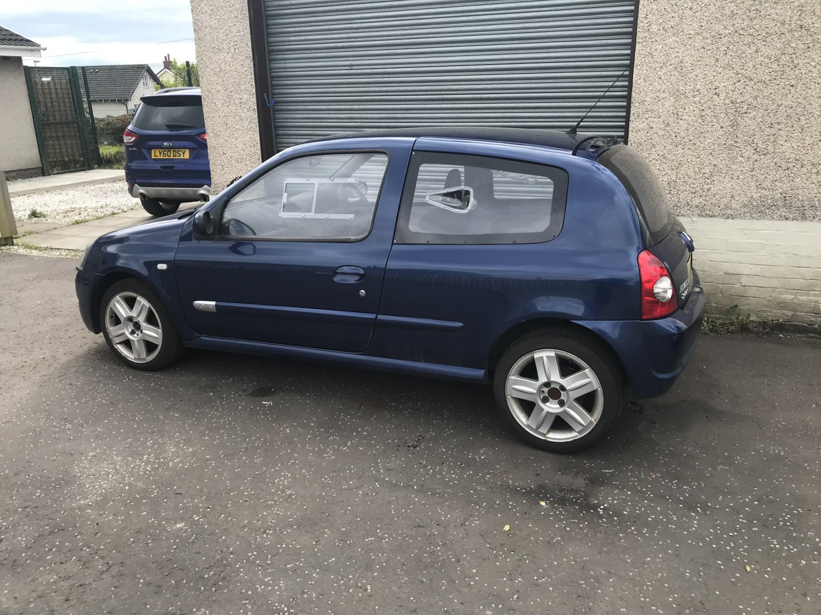

Heres some pictures of the car.
Cheers

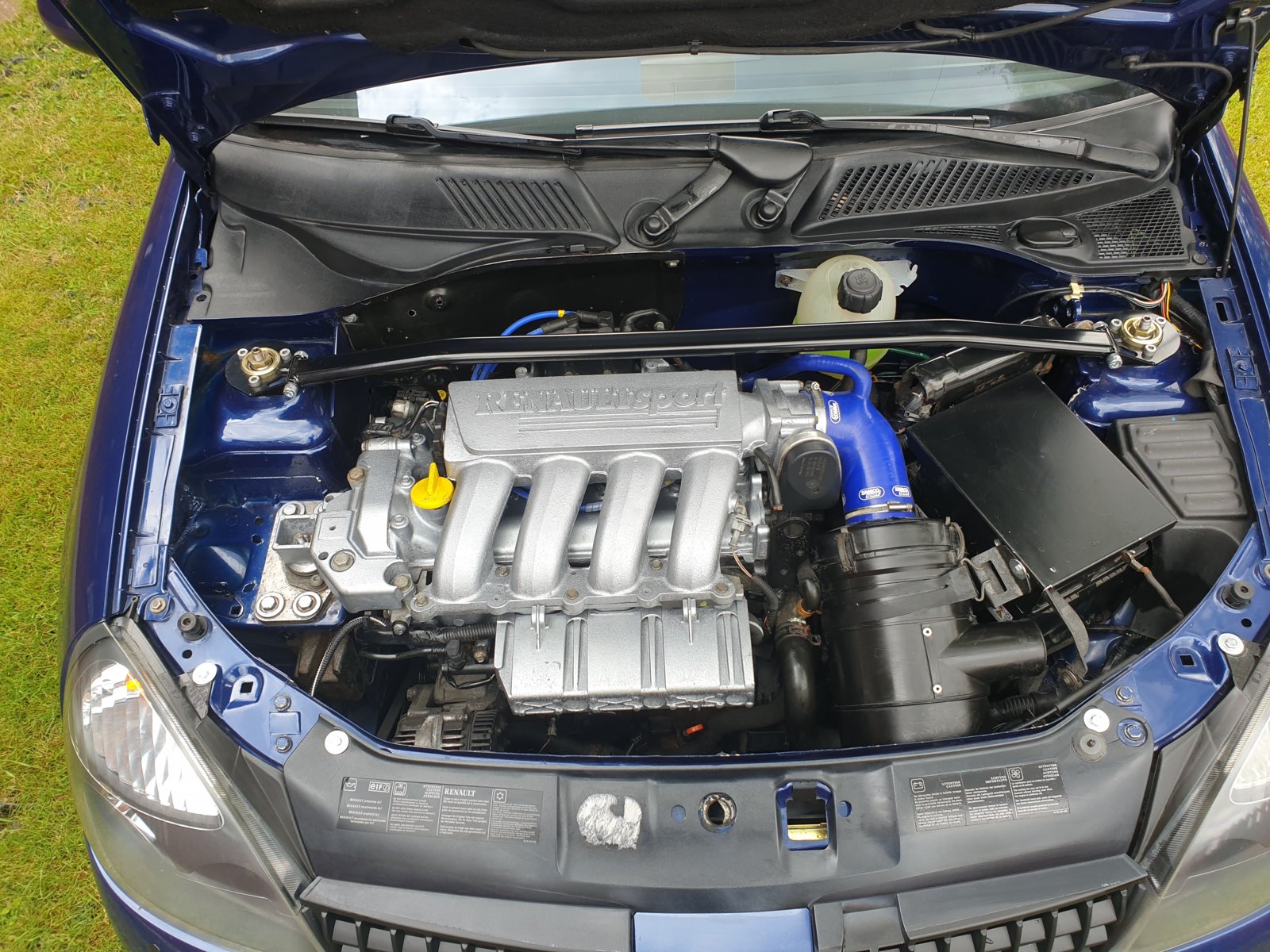

That looks good Kyle, where is your cold airfeed coming from ? also would you be able to show me a picture of your ph1 filter housing set up please.
Thanks
Krarl
Thanks
Got a 100mm T piece from the Foglight duct up to the airbox. I'd much prefer to have a V6 airbox tbh as it has one large opening
1428713
Best pic I have, the air feed comes up in front of the battery
