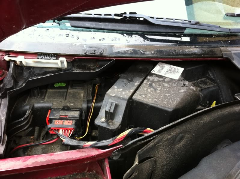

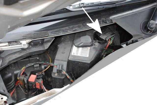

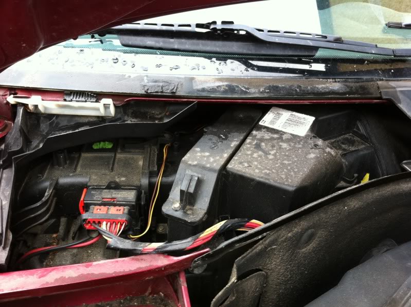

But I'm having some trouble with the heaters. On a normal clio 182 the resistor pack is usually the culprit, on a clio 182 cup, there is no resistor pack, does anybody know anything about this?
Clio 182 FF:
Clio 182 Cup:
So Ref the heater blowers not blowing anymore.
There was a loose connection between the heater resistor and the blower motor. Tried to fix it but the connection would not work when back inside the housing so a new heater resistor and a new blower motor were installed. Working fine now :)
