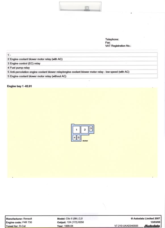

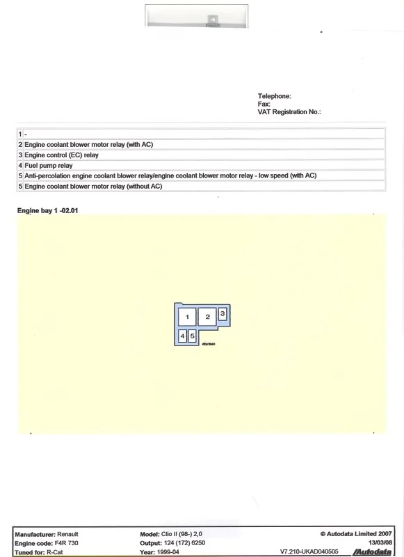

i take it the relay is one of the smaller relays in the engine fuse box?
cant remember which wire it is on the coil, use a multimeter to find which one it is
yeh there will be a big yellow relay and 2 smaller black ones, as per this
relay is clicking under the bonnet.
