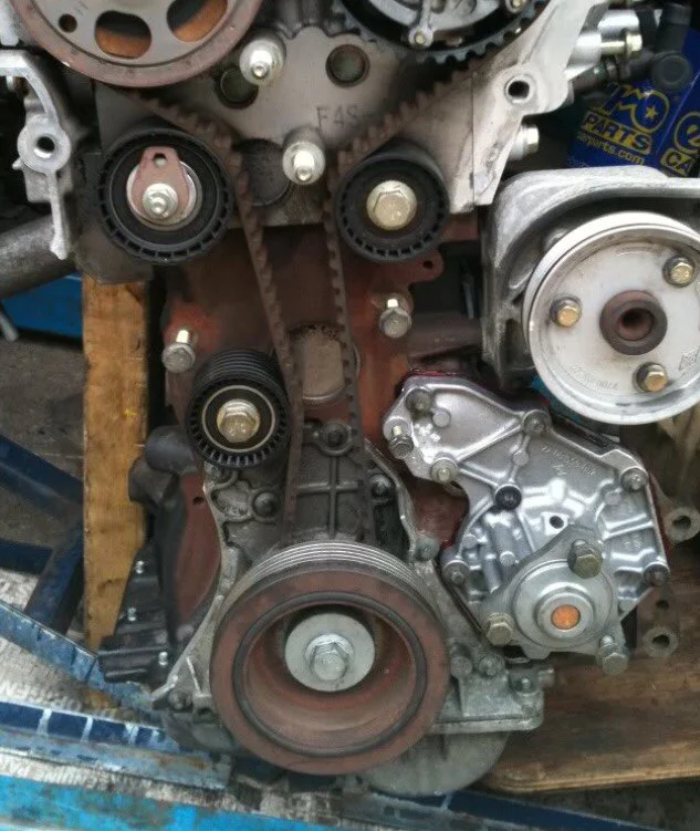

I have just replaced the timing belt, tensioners, dephaser etc with the gates kit on my clio 182. I used all correct tools, both ends of cams, and very carefully tensioned and timed the engine. All rotated perfectly - I was very happy with myself.
When I started the engine I noticed a slight squeak at idle - it is not noticeable at higher revs. I took it for a quick spin but the noise is still there. I have now taken the upper cover back off the engine and I notice that the outside edge of the belt has threads starting to appear. I have read else where on this forum that the tensioner can give trouble and hit its stops, fred raised this before. The belt sits on all pulleys correctly. Would the signs I mentioned be an over tight belt and if so would a re tension cure? - just when I was please with myself!

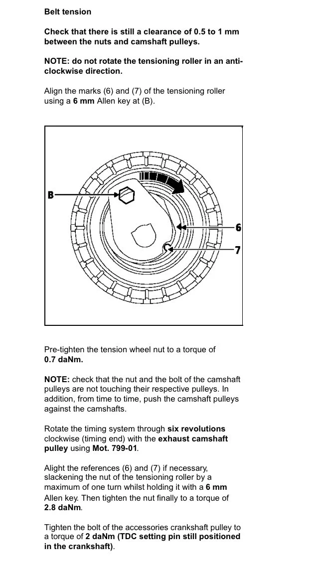

Follow this procedure if it helps , make sure the tensioner is rotated the correct way .

I followed the precedure as per renault instructions , and above. I rechecked and studies as the engine was running afterwards - tensioner working within its range. I even adjusted the tensioner with a little less tension to see would it make a difference - it didnt.

The sound is comming from the lower crank end.

So, feedback: this week I've had many things done to the 182. The noise is gone. I changed belts, water pump and dephaser.
