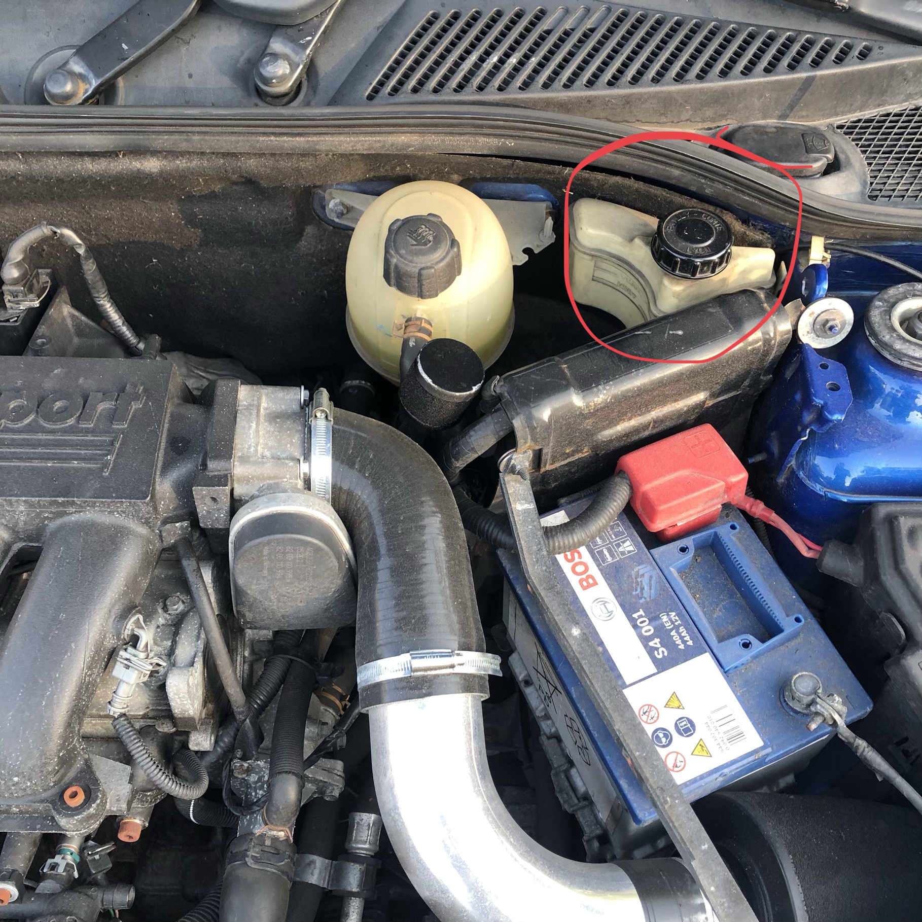

Just had a look under the bonnet and trying to work out where it’s coming from and appears to be from here...

What is this and does it look empty??

Yes it does.(look empty)
It`s the PAS reservoir. so you have a leak somewhere.

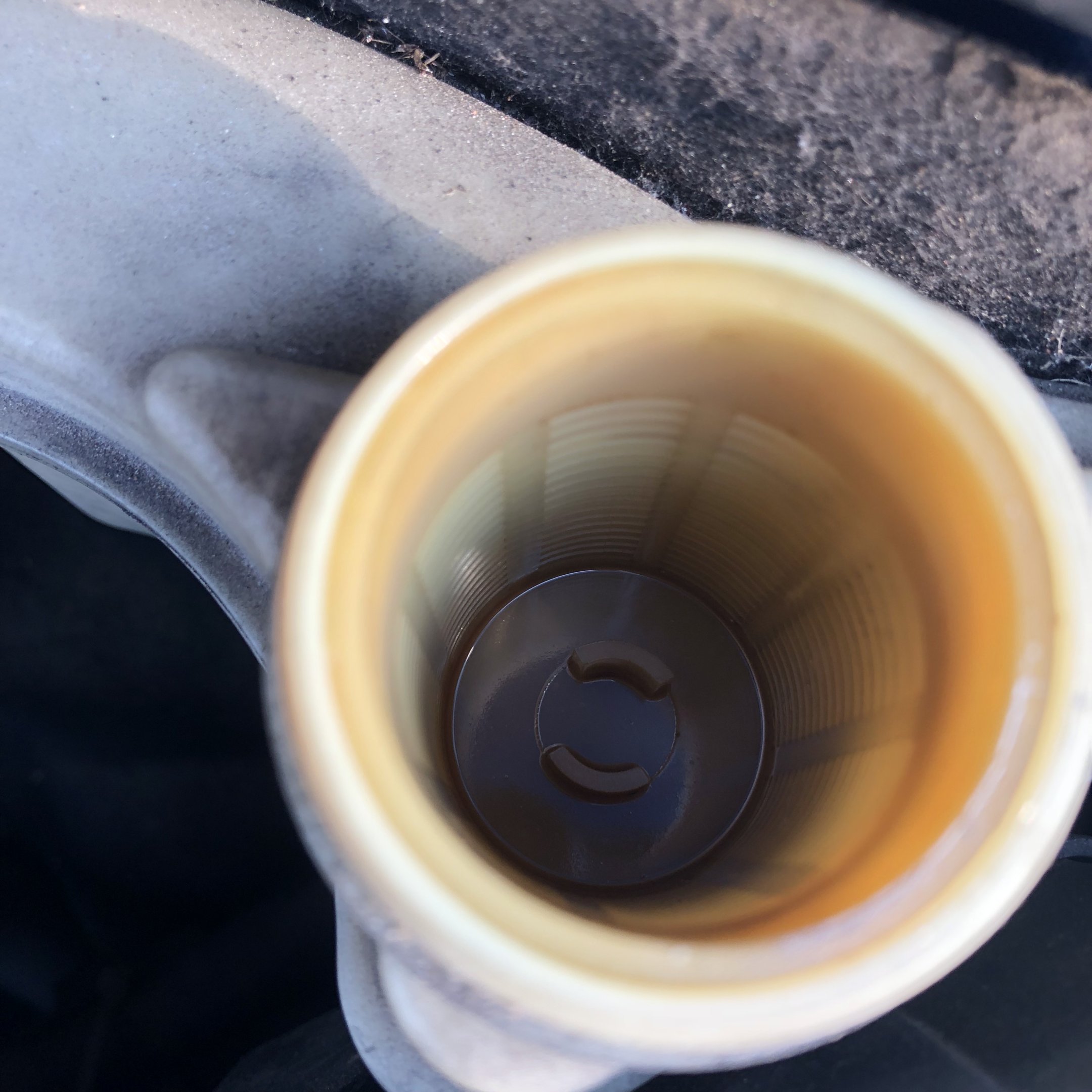

That pas tank does not look empty to me, when cold the fluid should just be below the two prongs on the filter.
You can pull that filter out of the tank and inspect the fluid, if it’s dirty get it changed. Don’t run it without the filter or it’ll spurt out the cap

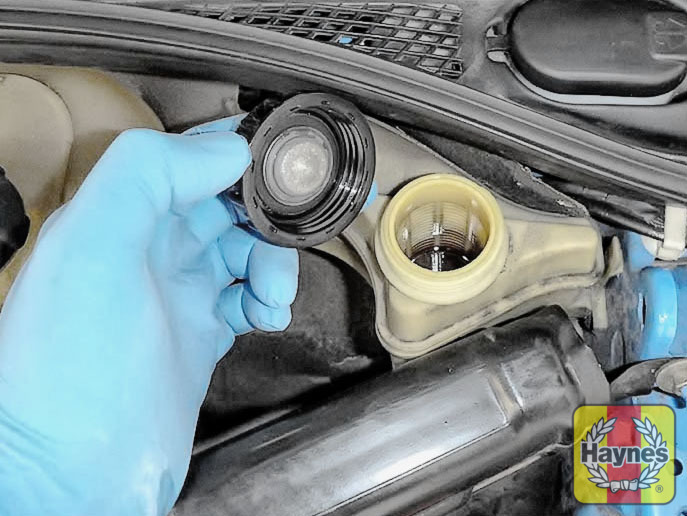

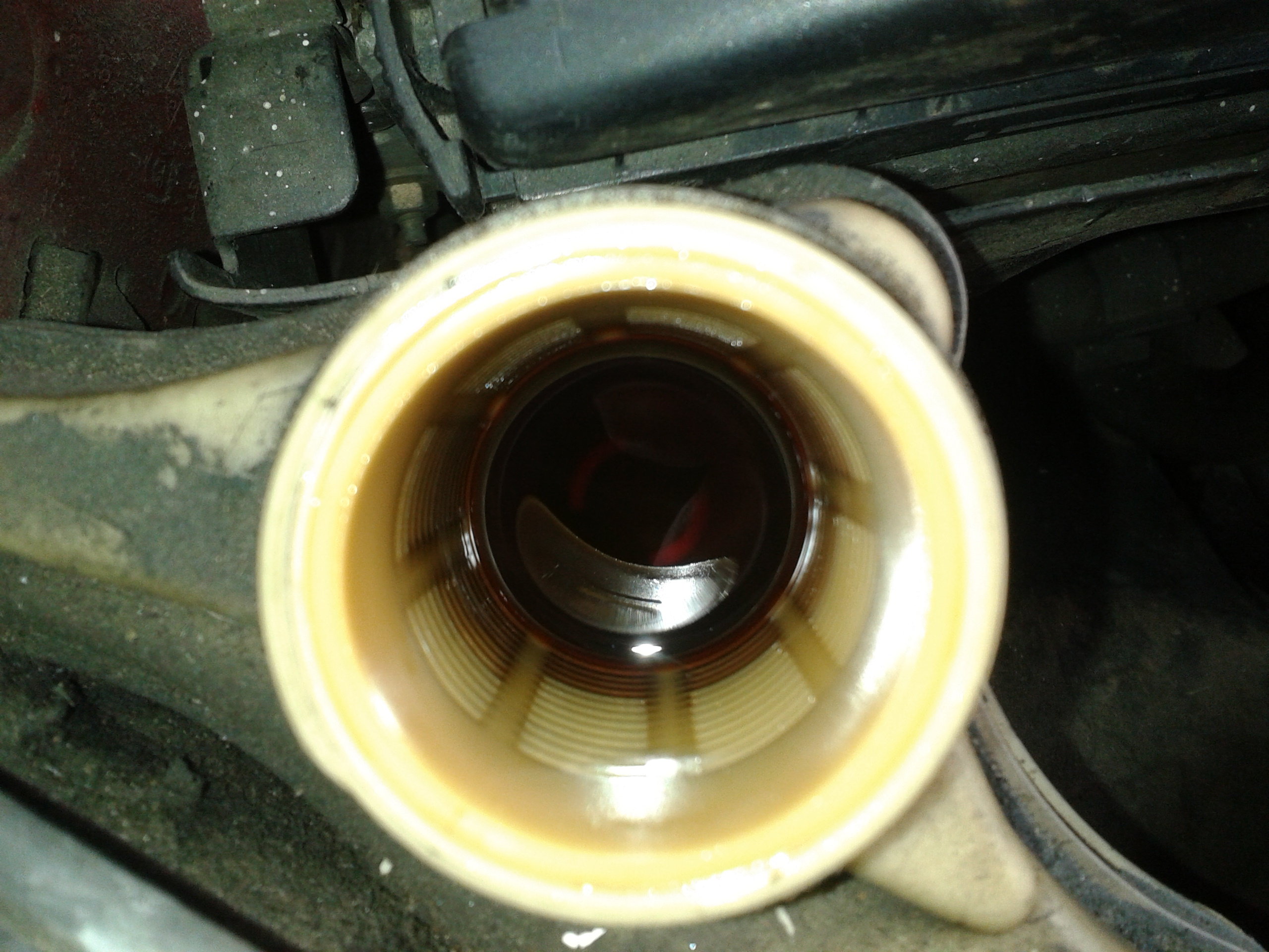

This is the level mines been at for the four & a half years I`ve owned it (about 10mm above the floor of the filter) and the other pic is Haynes recommendation.
No prongs visible.

Went and bought some more steering fluid and took out the (what I would call) filter and the table as basically empty. Filled up and it hasn’t made the noise since so putting it down too that.
