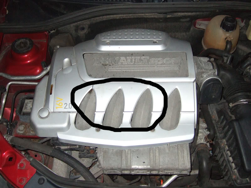

Here's a pic of the engine bay. It sounds like the noise is coming from the centre of the engine. Not coming from dephaser at all.

Fred on here had one of these noises. hes a renault specailist and he could even figure it out. his noise was like yours and it comes from the inlet manifold area

my clio does exactly the same when cold its fine when it heats up it sounds like a diesel power is fine just noisy. i had an engine flush and then had correct oil put in fully synthetic about 60-70 quid a gallon and it still does it sounds like its coming from centre of head when i listen down a screwdriver. renault didnt have a clue and were going to charge 700 just to take rocker off and on a new head from k-tec seems like a good idea 600 quid at that price
