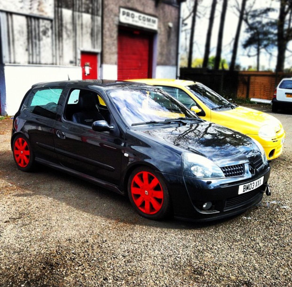

Identical shells if you get one without a sunroof, myself and @aldo_87 have done a couple of reshells with ours, much better condition shells on the non RS cars now. As brigsy says, only worth it if it's a long term project so future resale isn't a concern

I had a flamer that was hanging with rust so it ended up stripped bare. Found a 57 reg black Campus that had been garaged for the last 10 years which was £800. The shell is in really nice condition.
I used the complete wiring from the 172 and laid it into the Campus. I think that was the most different area of the reshell.
Hopefully I'll have mine running in the next month or so.
