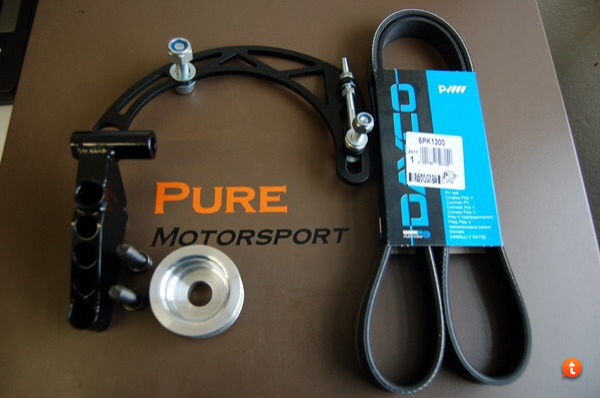

I know people who run the PMS kit and have had no problems. Just in my own opinion it's looks cheaply made and weak in comparison.
This bracket (You use your original alternator, it's just positioned lower down)

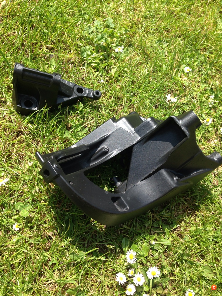

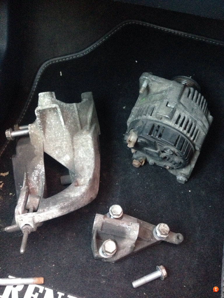

Compared to the OE one + alternator
Just looks more substantial.

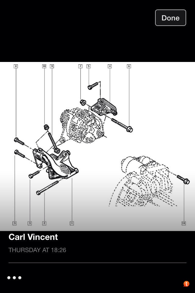

This is everything you need + the Cup aux belt and high pressure pas hose
