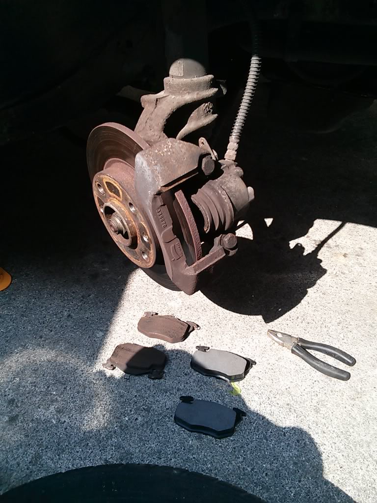

Today I set out to change my front brake pads all by myself , I had my Haynes book ready and had watched some videos etc so I was all set.
I was pretty sure I would have some problems along the way as its a 15 year old car plus I didn't know exactly what I was doing but actually it went really smoothly and took me by suprise when I finished :)
I was particularly worried about getting the piston back in but that turned out to be really easy just a long screw driver and levering it back in. I had the brake fluid cap off and had to empty some of the fluid to make sure it didn't over flow.

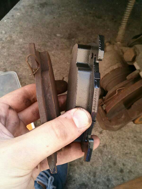

The biggest problem was one of the retaining plates holding in the pads was pretty stuck, a bit of hammering and it was out.

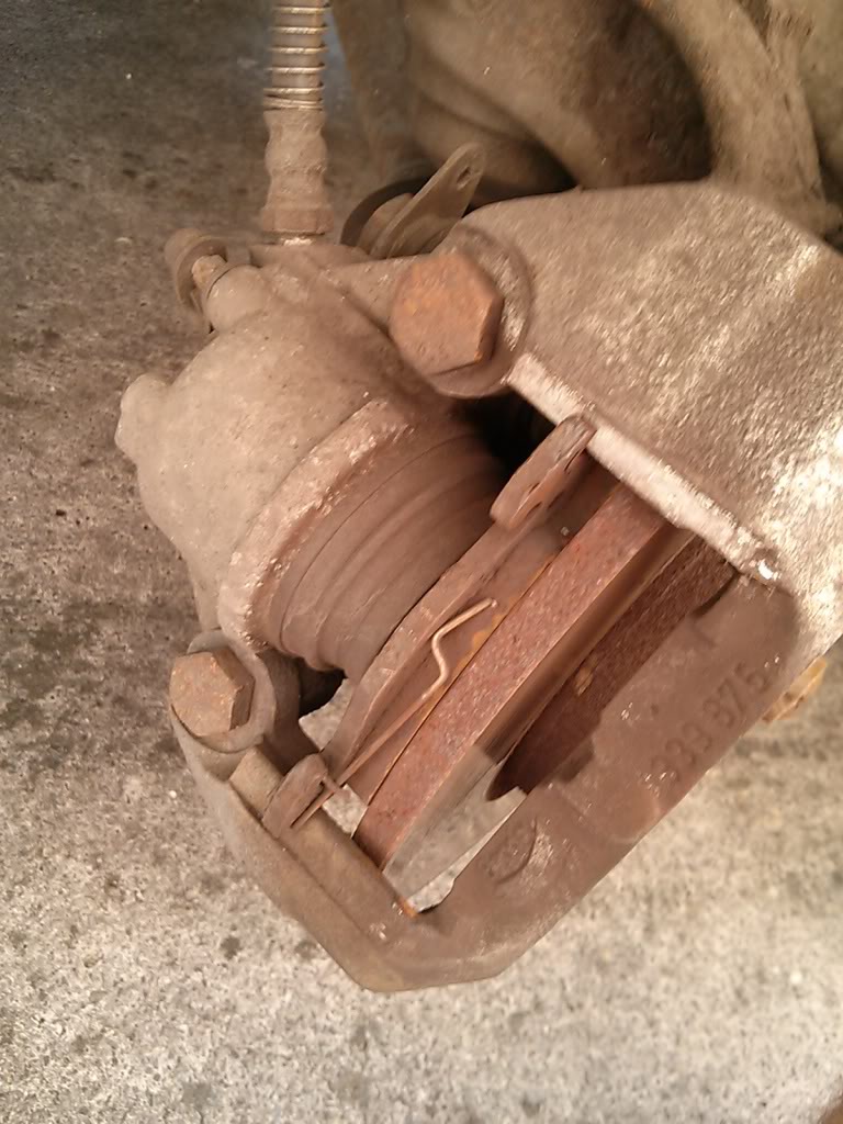

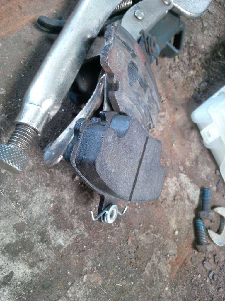

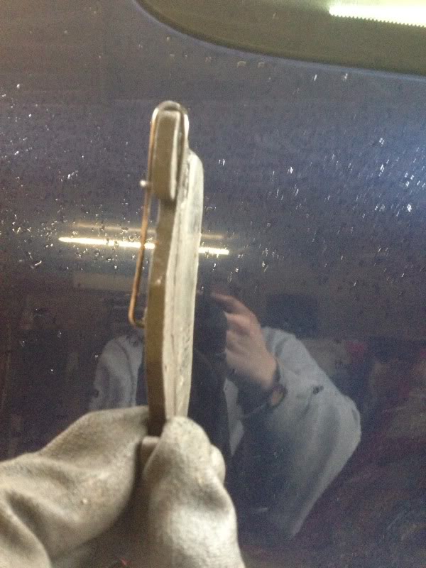

I get the first pad out.

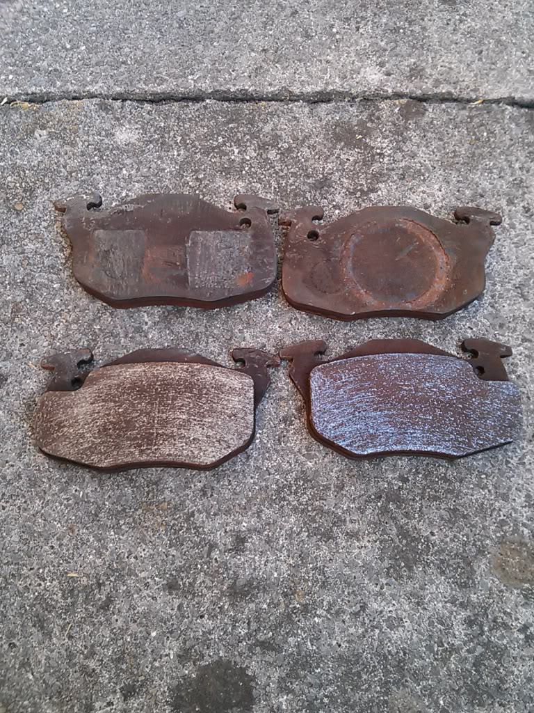

As you can see the old pads were pretty old..

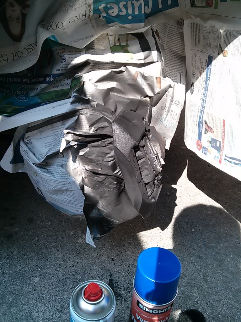

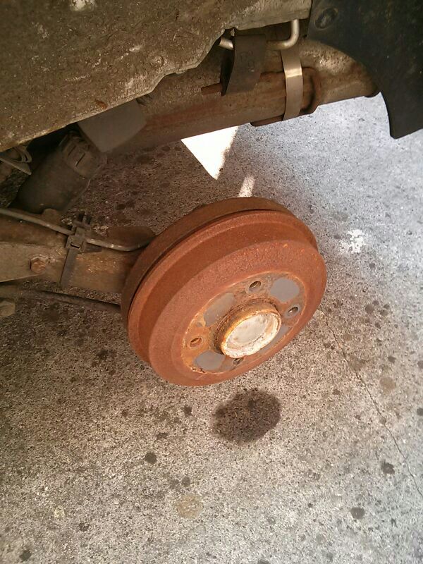

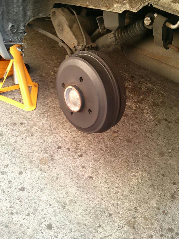

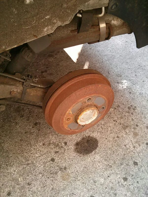

Then I decided I shouldn't stop there , I had some high temperature paint so I sprayed both the callipers and rear drums in black. I didn't want anything too chavy like red/yellow as its only a 106!

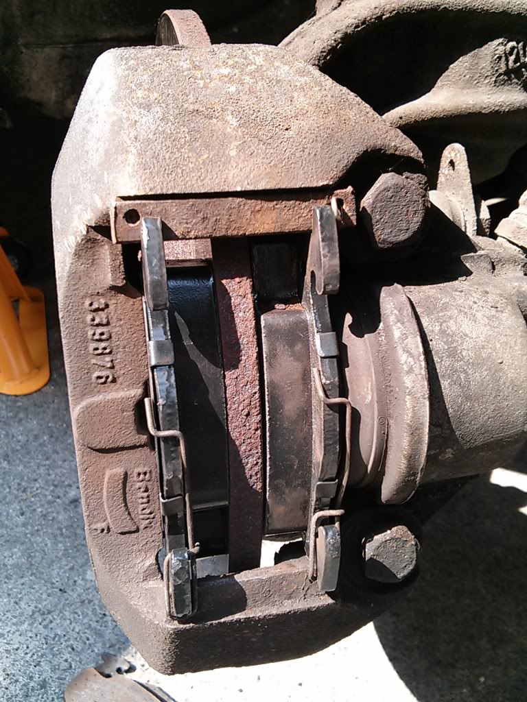

Something looks wrong to me in the 4th photo? Or is it just a shadow. Plenty of life left on those pads too should of seen my old ones haha.

The L bracket holds the pads in place with a small retaining spring on the inside. I don't know if you can get away with it as I've never fitted at the top lol.

Ah i called it the retaining plate ? well it was on the top when i took them out and its also at the top in the haynes book so should be okay:)

the plate needs to be at the bottom or the pads can fall out. also the tension clip nearest the piston is fitted wrong.

think i sorted the tension clip, in that picture i hadn't compressed the piston against the pad yet so there was still a bit of room. should be okay now but ill look tomorrow cheers for pointing it out

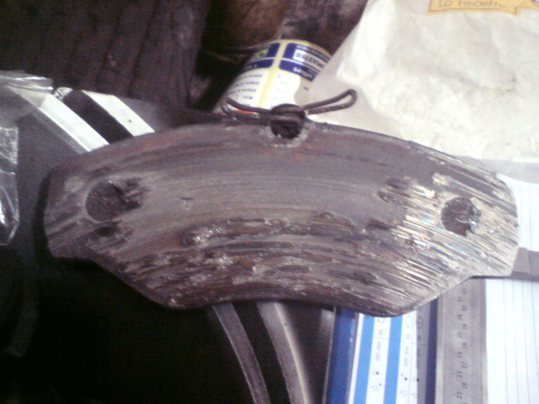

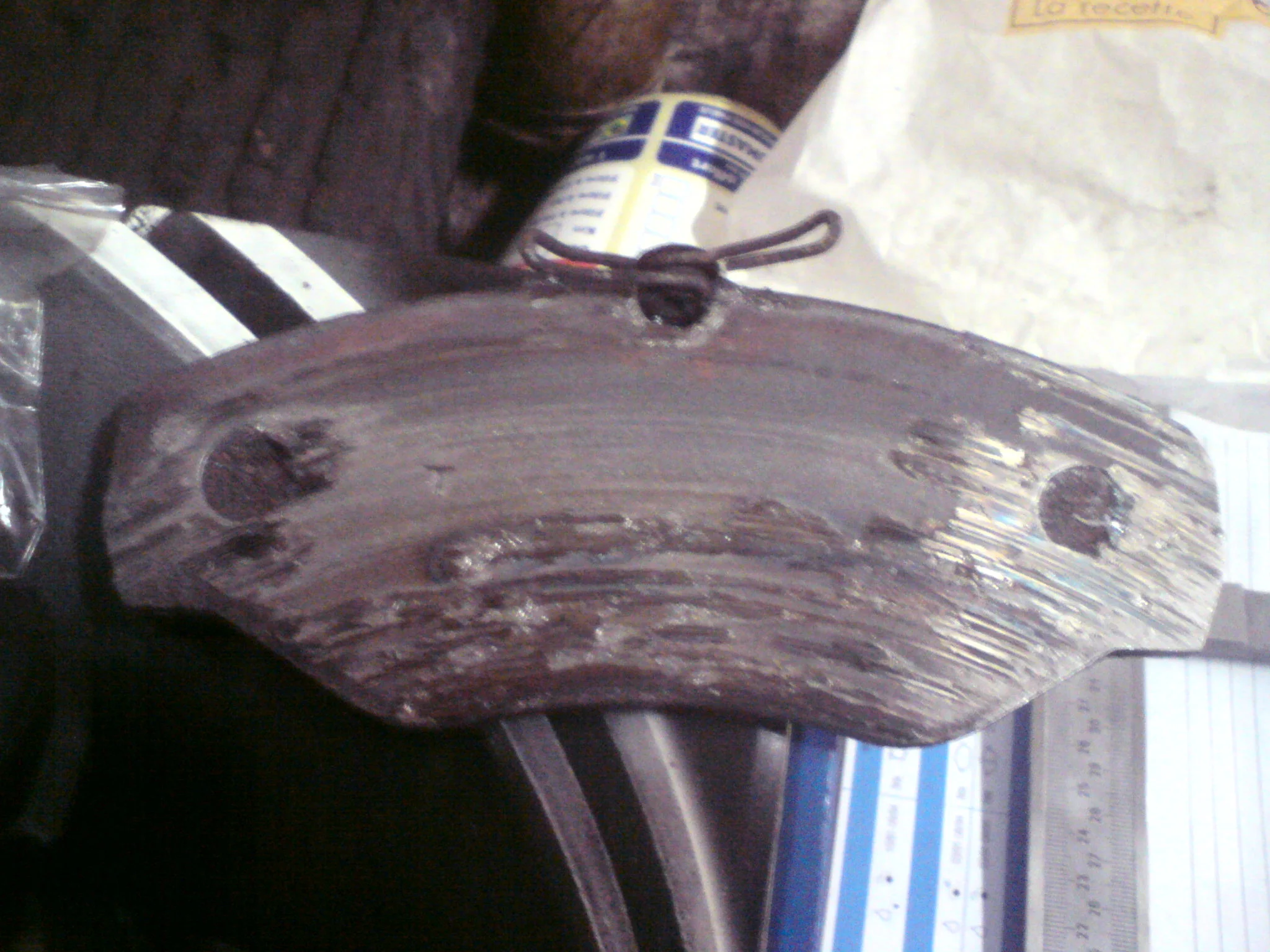

Tempted to dig the laptop out and find the pics of the brakepad/disc from one of the Renault trafics transfer vans I drove last winter season in France. Scraping... mmmmmm.
Edit: I dug the laptop out!

It's on the top of my 106 aswell, it came out the top when I last changed the pads, so it went back in at the top, done 20,000 miles like that and never shown any signs of moving.

Those pads you've fitted appear to be massively thicker than usual, I think you've been supplied front pads for a small engined 106/205
