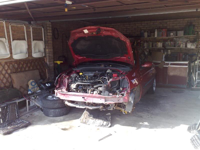

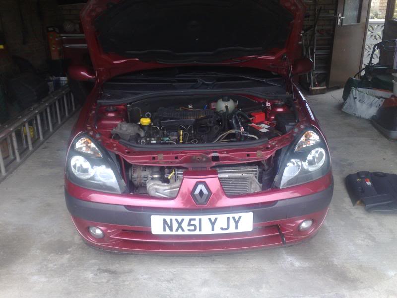

Not bad for 45mins work! - DCi Stripage!!
Martin_172
from this......
to this.....
full guide with plenty pics comeing when its done. its getting an uprated clutch, new flywheel (the reason its getting stripped), 2 ARB drop links and new dampers all round along with a few wee other silly bits here n there!

Martin, i see this is the perfect occasion to install a dci100 intercooler and a decat :D
The standard splitter is held in by staples aluco.
+ there should be some rivets to drill aswell
if i can find a cheap 100 cooler i will but only paid £30 for the 80 intercooler and pipework so dont want to spend an extra £200 for a brand new cooler!
decat worth while?
decat will give some decent gains, a few bhp at least. looks like its coming along well, did you find out about those clutches from AP or sachs?

aye it was ment to be a runabout but i love the fact you can hammer its nuts in everywhere and it still gives 50mpg rather than the 25 the 172 gives (obviously not near as fast tho!) it suits my "always late" style lol never need to change gear just pulls in any gear so fancy clutch bigger injectors and a remap and it will be sweet lol
Macester, looking into it, ill sort something out or find out if i can use a 172 one or something just waiting to see the damage box will be off it friday morning!
Sach's do a clutch for the dci but it doesnt say anything about being uprated or what it can handle etc?
