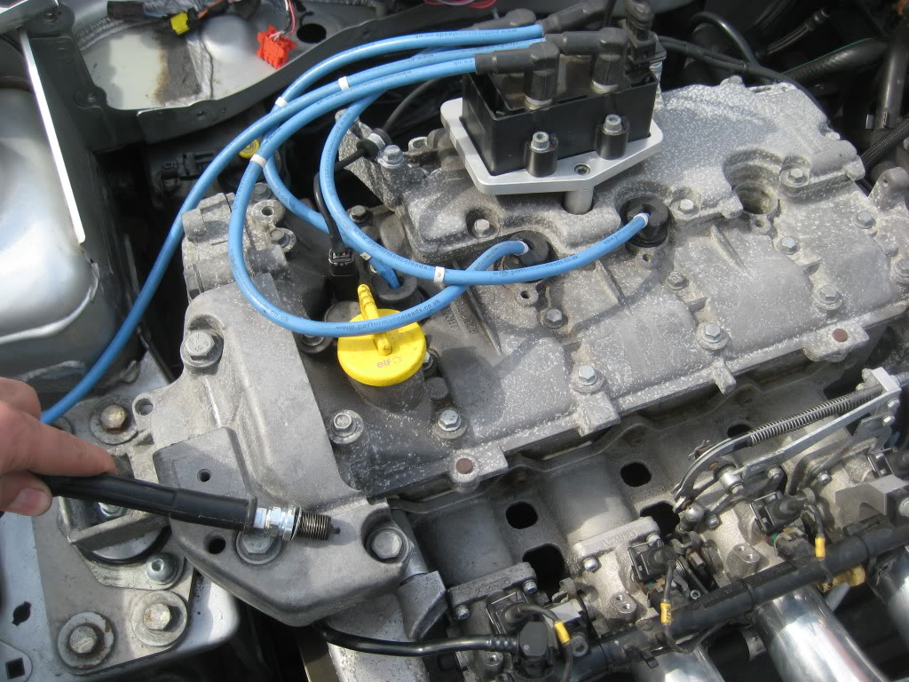

I pulled a spark plug out and earthed in to the car and turned it over but it didnt spark at all.
Am i doing it right?

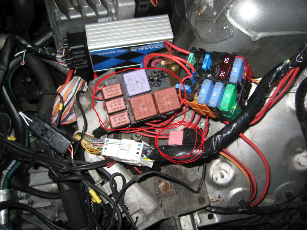

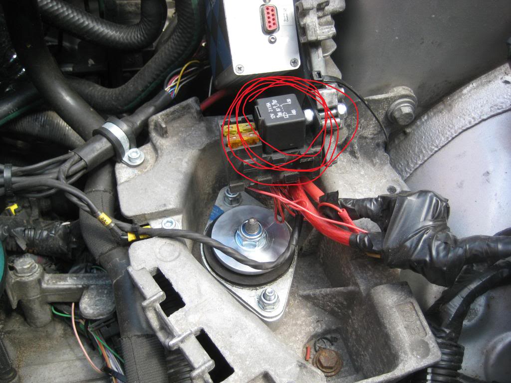

When you turn the ignition on, all these relays in the engine bay click a few times
But this one doesnt click at all
I checked that the injectors, coilpack, fuses and some other parts are getting power and they are.
What else could be causing it not to start? Someone please help the car has been dead for over a month :(
  Golf GTD Mk7
The ones you've circled chris are the starter, ignition, fan and fuel pump relays. There are large and small ones for fan and starter iirc. Not sure what the black one is? Is that a bodge job from your adjusted loom?
