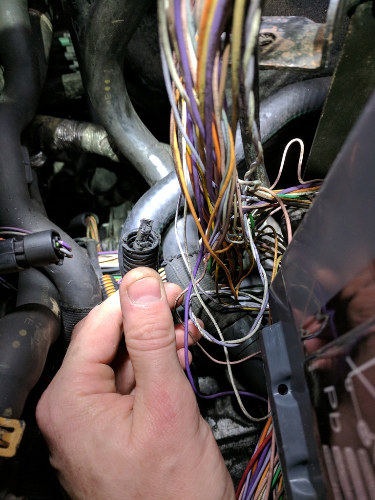

As you probably had to move the loom about to get to the starter bolts, I`d go straight for this on the back of the box being snapped/corroded.

You could 1 or 2 of 2 possible problems here.
The one I pictured broken is at the rear of the gear box, and is the earth for the cabin loom.
I am assuming the earth strap you referred to is the woven braided item, continuity with a meter does always mean it will work under load.

Found it! The earth on the back of the gearbox was barely making contact, the connector was snapped.
I know I need an 8mm connector but does it matter what I use as long as it makes good contact as I can't find a similar one online
