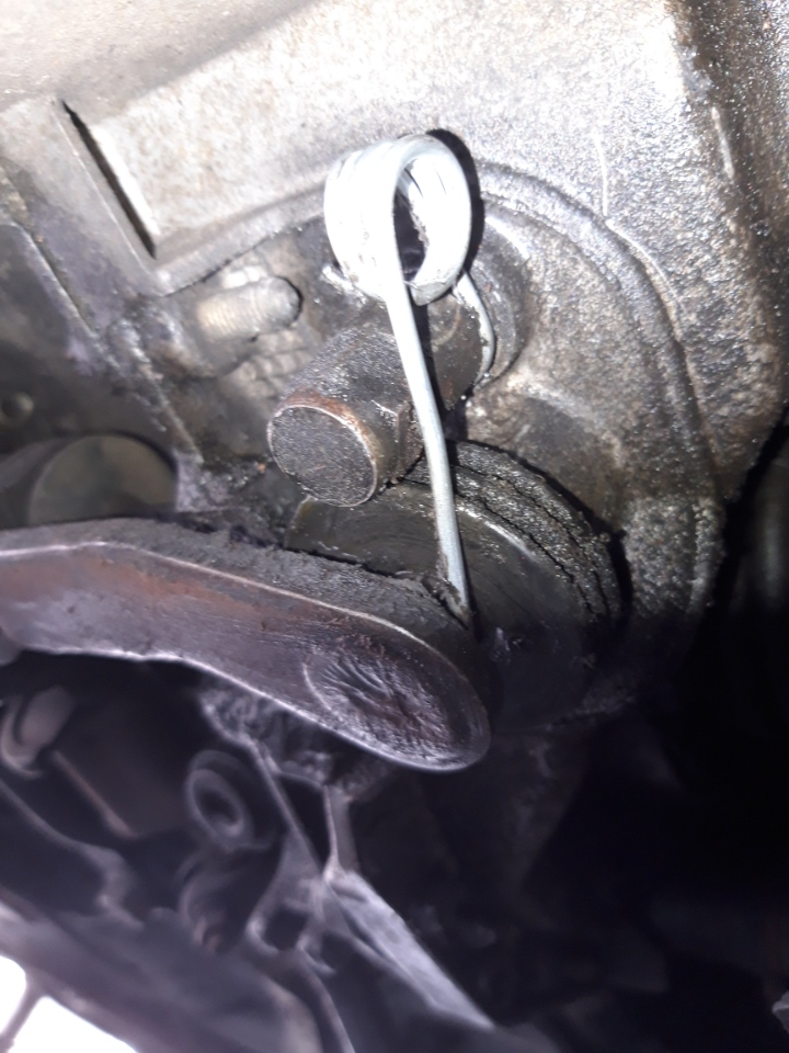

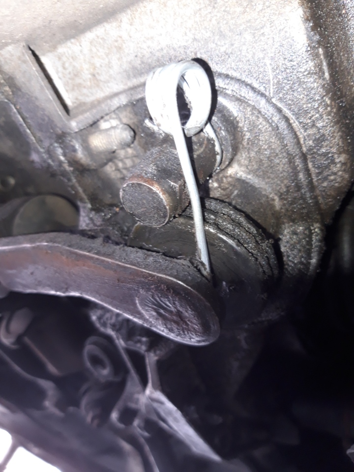

I have also been reliably informed a broken spring will cause this issue on a JC5 gearbox so be worth a look too.
