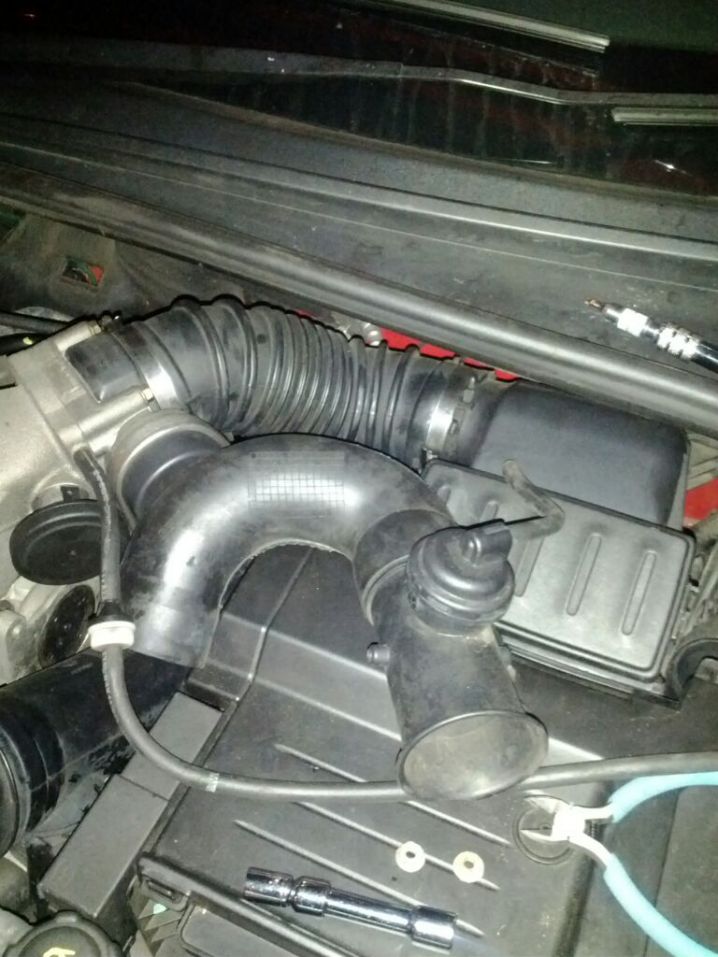

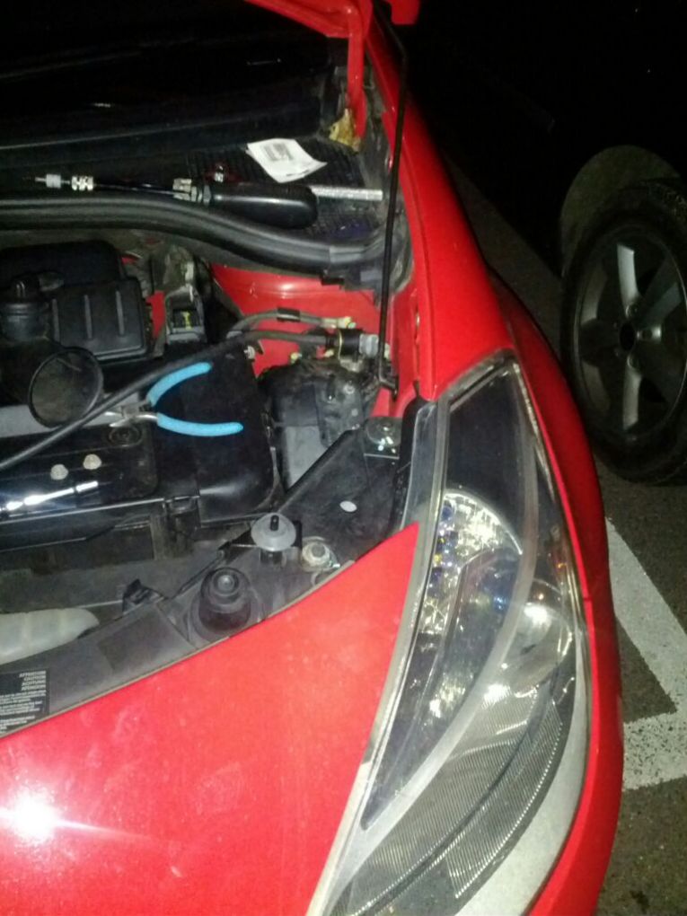

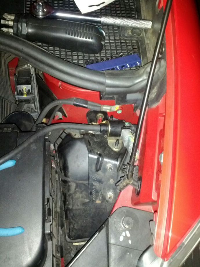

All fixed here are some pics of the pipe and where the box is.. hopefully it will save someone else some time its a red 10amp fuse too.
