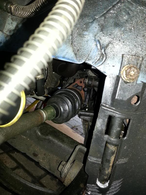

o/s inner boot
  impreza wagon S2000
I have a small split so bought a replacement boot from GSF, got to this point and am a little stuck...I'm guessing remove hub nut to free up both ends and remove it that way.
Thinking I fooked up as I don't have a pneumatic boot stretcher either...so perhaps a new drive-shaft as those tools are £80 :(
Advice and ridicule welcome :D

I don't think you get to replace that inner boot buddy
If its the same one im thinking of (which it looks like) then it is an inner fit boot which forced me to get a new d/s
Sorry to be the bearer
A
Cheers for reply, weird as I was able to buy the boot separately...in fact let me rephrase that; f**k you f**king car :D
I'll be needing a n/s driveshaft walking distance from Chelmsford in Essex then :(

Just wait till someone else confirms that bud as I am by no means the master of these cars........but i think that's right

It is a serviceable part but I could only get one direct from, Renault at a staggering £43 :(
It does include a new surclip fro the tri-lobe bearing though...anyways part number if anyone is interested; 77 01 209 884
