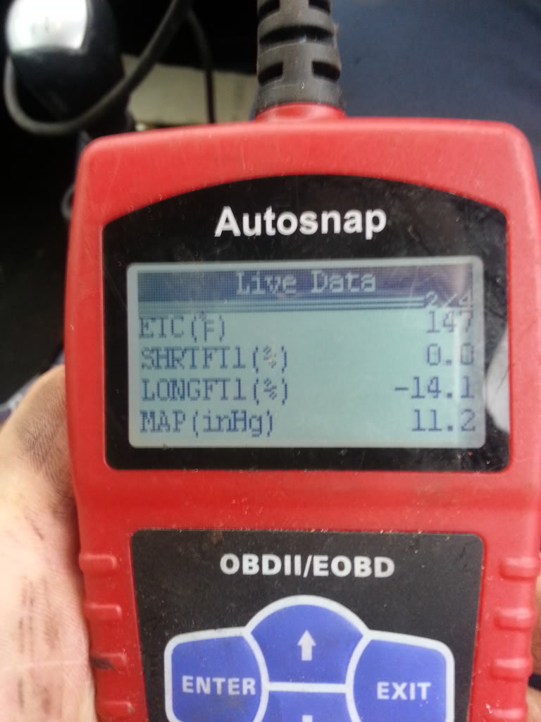

this is mine here
i know the other cheapo ones wouldnt work on my phase 2 but this did so id assumed the ph1 would be the same
