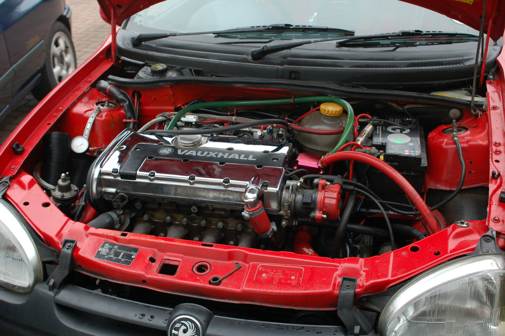

I have a cheap one from ebay on my throttle bodies XE corsa.
It used to breathe a lot before I rebuilt the engine and I had to get the sight tube fittings replaced by a local hydraulics place as they were crap so when it filled up a bit it leaked. So budget for that too when weighing up what it will cost you versus a decent one.

On the corsa before I rebuild the engine it used to actually FILL the catch tank during a trackady, now it just ends up with a few drips and I havent needed to empty it even worse in 18 months or so.
