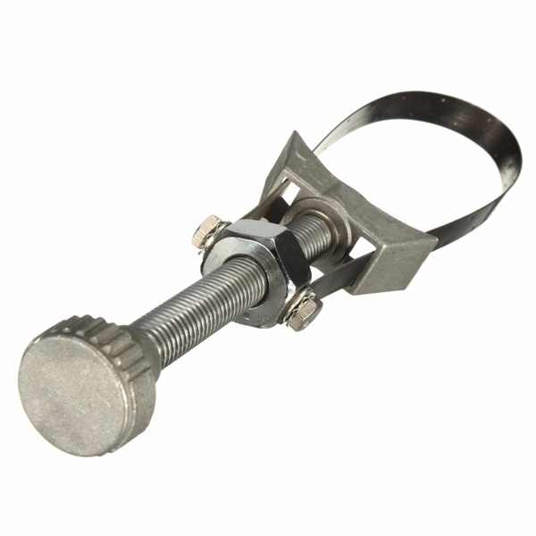

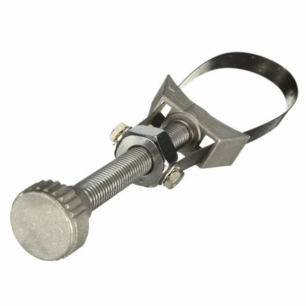

This was the only tool that shifted mine the first time around
When everything is dry and cleaned up, this can be used properly and you can get it super tight and off in no time. I was almost using this like a ratchet the first time lol, ridiculous what some people get up to!

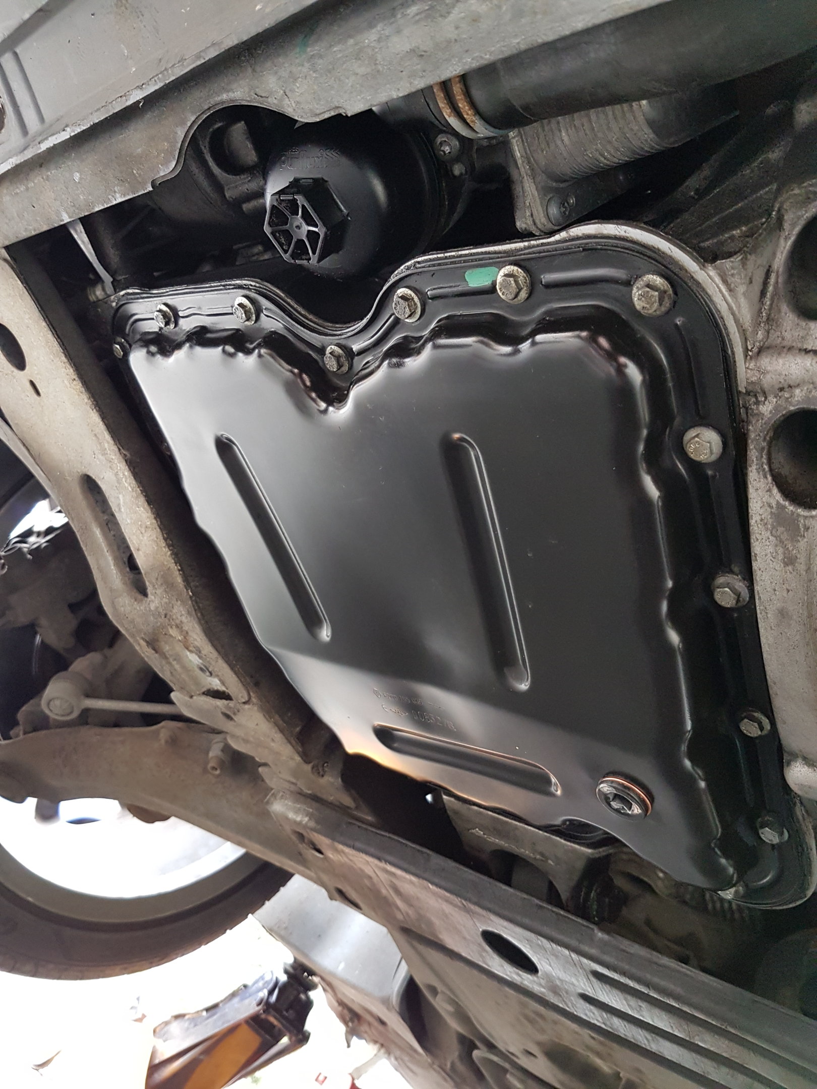

Btw I was under the bonnet again earlier and noticed there is very little access to the oil filter from underneath so it doesn’t look possible. Looks like I’ll be removing it from the top again in the future, although no injectors will be harmed in the process nex time

Yeah that tool would’ve be better than the one I used. Perhaps just as much leverage as a flat bladed screwdriver jammed in the side though ;)
I’m envious of that Megane dci filter location :/

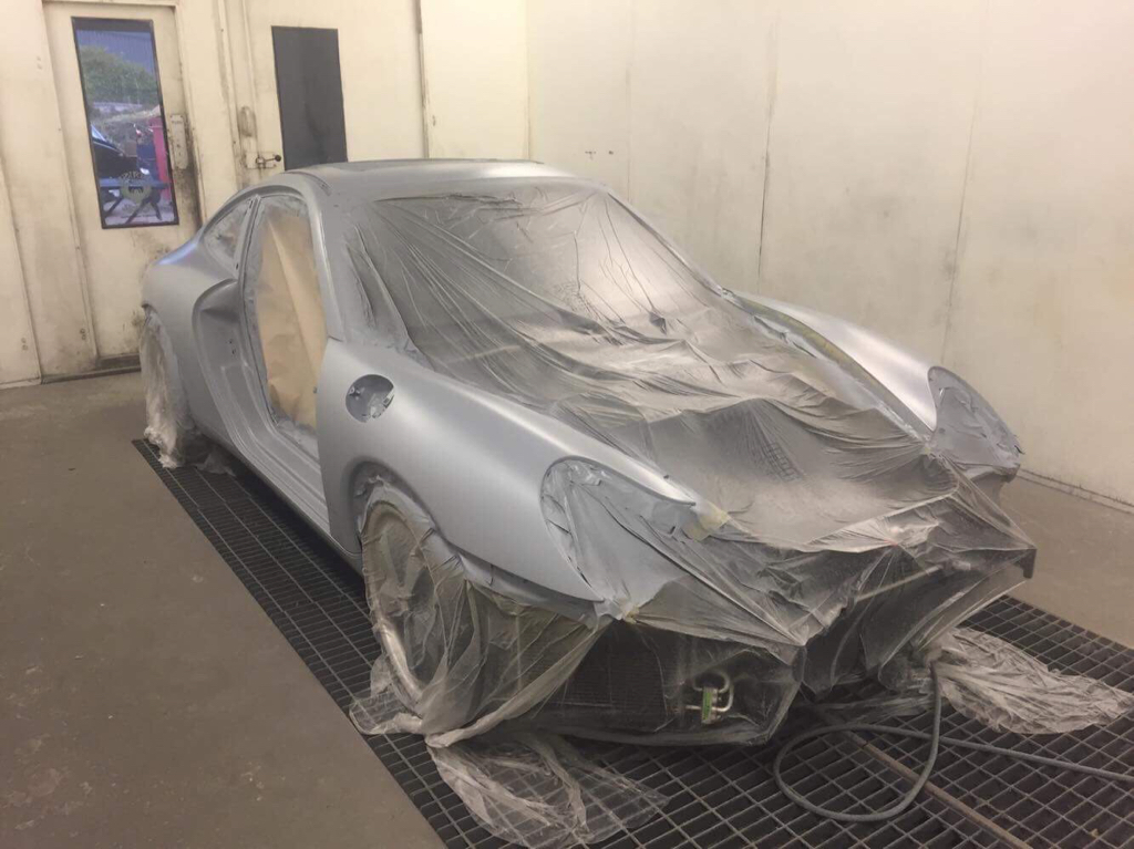

I was doing a simple brake bleed and ended up with this
Lol, Not the whole truth but during a simple service I had the car on a ramp with a power brake bleeder in the frunk, realised I hadn’t cracked the rear wheel nuts off, lowered car to ground and the front lid slammed shut on top of the power bleeder putting a nice outward pimple in the bonnet. Dam and blast I said or words to that effect, then I opened the bonnet to find the the nipple at the top of the bleeder which remember was under pressure had snapped off spraying dot4 everywhere!!!
2hrs of cleaning later..... brakes bled.
To be fair it cleaned up ok with no paint damage and I lived with the dent for a year until this winter. I took it in to be repaired and by the time the painter had accessed the car only the roof didn’t need painted so full respray ensued.
The joys of motoring....
