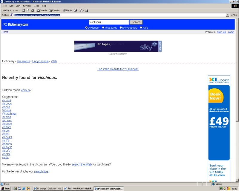

did he mean viscous? lol :)
Now you see thats where peoples opinions are divided there are those of us that spell it my my (me) and there are those who spell it like you just did. Who knows whos' right
Arr wheres the spell checker function.
ant
  yep.
lol :)
i typed vischious into google and got nothing about runny fluids.
viscous on the other hand.........................................................
ant
  yep.
:approve:
