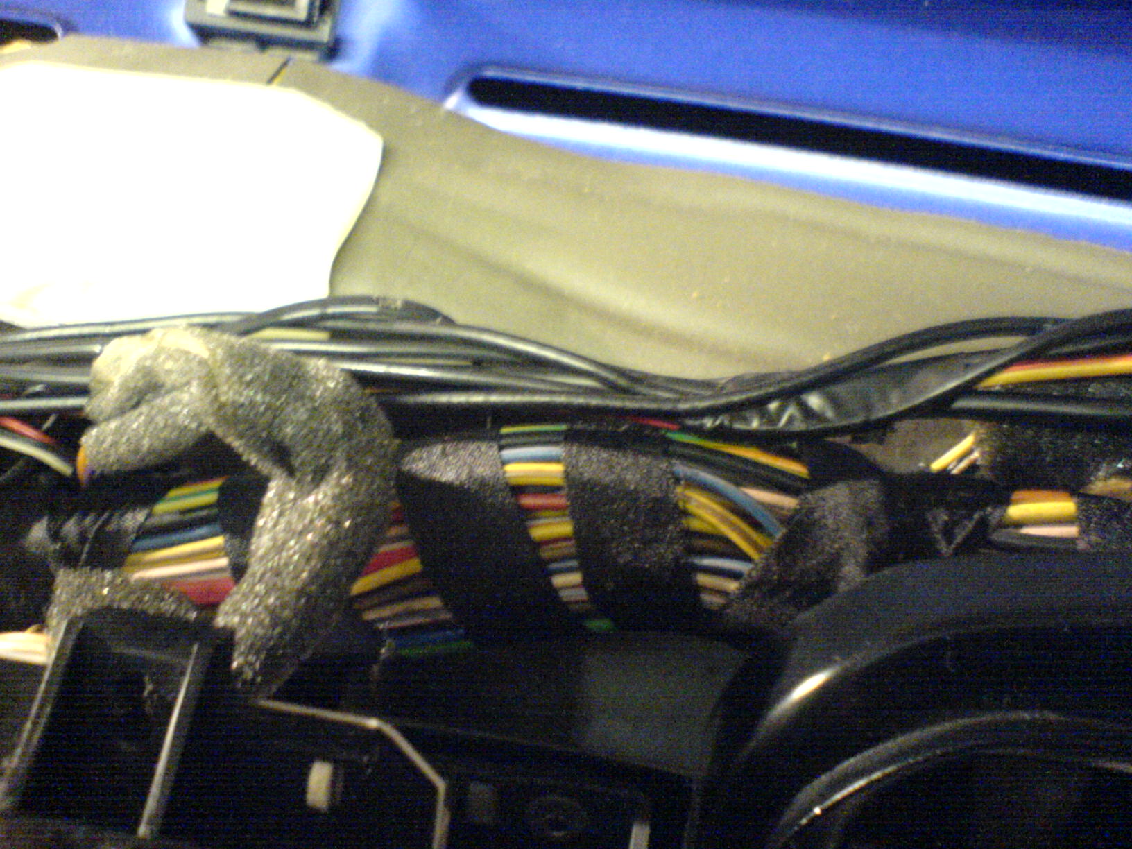

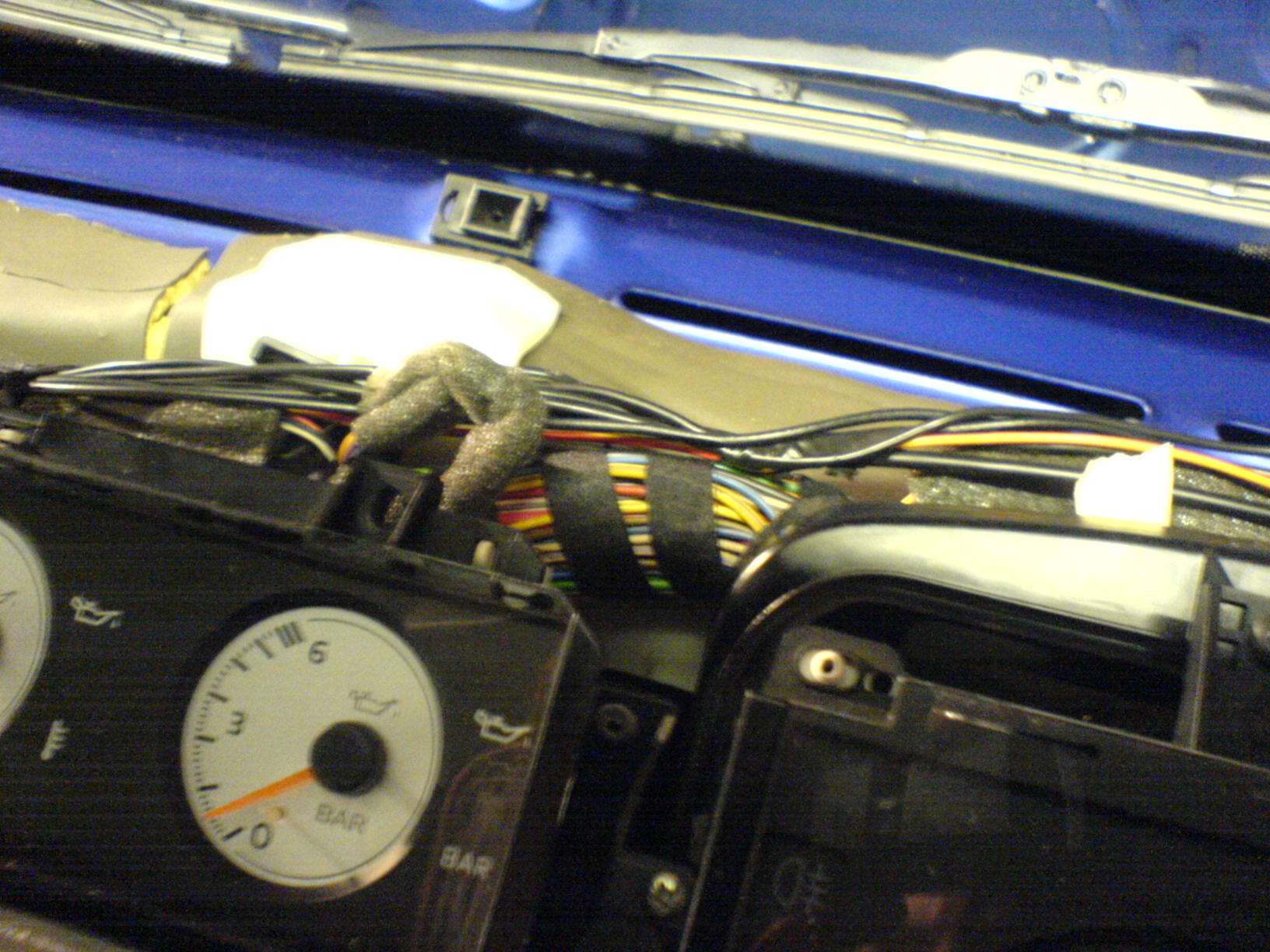

Here is a rough guide to where I found them. The wires with the foam covering is the oil dial lead.

cheers for that dude!
i take it the wiring is covered in that brown s**t lol?? will try and find it i guess. big help tho dude!
