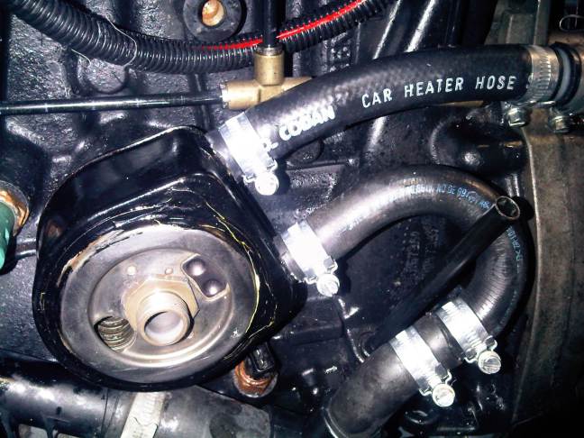

We didn't until this year, but we have one of those cup racer ones, think it's off a Ren 5.
It has the coolant runing through it, so it warms up quicker, it looks like a sandwich plate with two hose connections coming off it.
I'll try and find a picture.
Ordinary ones are very vulnerable at the front of the car, we have seen so many go pop, then it's race over.
This works fine.

Similar to a laminova then, pretty sure my 197s like that
