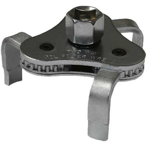

these are the best ive found for removing them up to now the chain ones are rubbish
invest in one if your going to be servicing your car yourself, can get alot more leverage on the ratchet then the flimsy chain job.

What about these?
I just bought some the other day to do mine and they worked perfectly.

I used one of these. Just took the fuel rail off to gain enough access. Put a rag under the filter, however it did still leak
makes life so much easier for the sake of removing a couple of bolts
