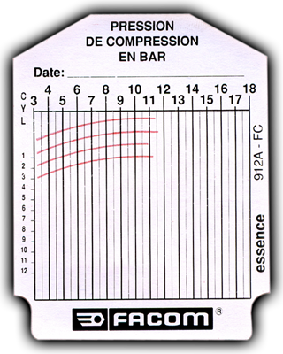

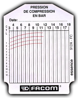

My Trophy is breathing heavily and has done for a while, and it's getting through a fair bit of oil compared to what it used to. It's also down on power and a compression test I did recently found that the compression wasn't exactly brilliant (results pictured below)... I don't have the results to hand of previous tests but the compression is definitely on the way down.
I also think I might have problems with the stem seals and a couple of oil leaks... LOL! Luckily I am getting the engine rebuilt by the very gentleman mentioned in this thread (Fred at BTM) so it will see a whole new lease of life, but I am beginning to wonder what Fred will find once he takes the engine out and apart.
