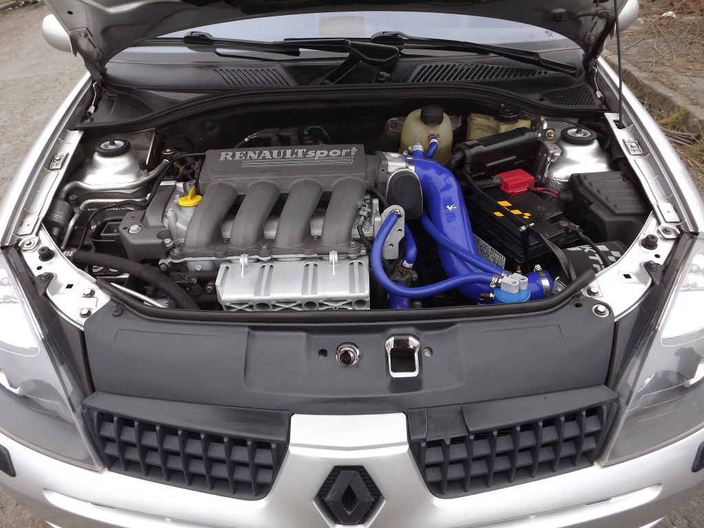

Here is my cheapo ebay version not completley finished due to no little breather on the end so stuck the end into the lifting eye for the time being.
Its not using oil but remember reading a post from Chip i while back saying its better not having oil vapour mixing with fuel etc. plus i hate the k-crap breather set up (Tacky)
