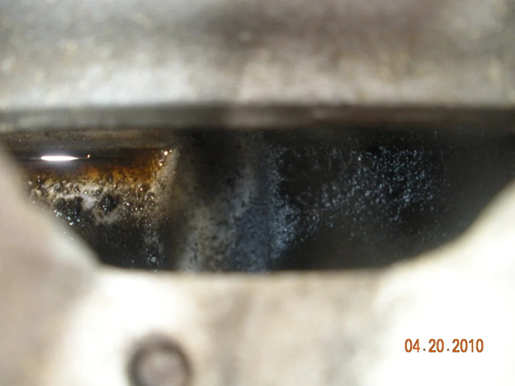

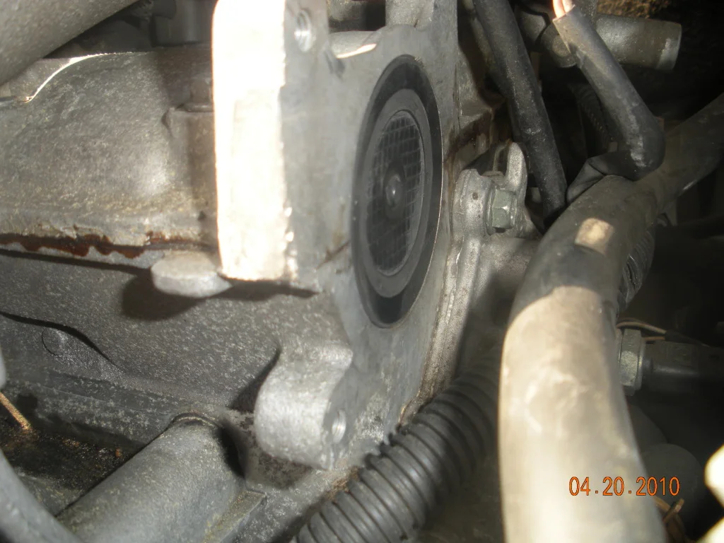

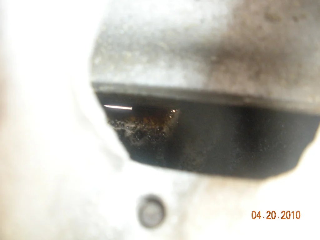

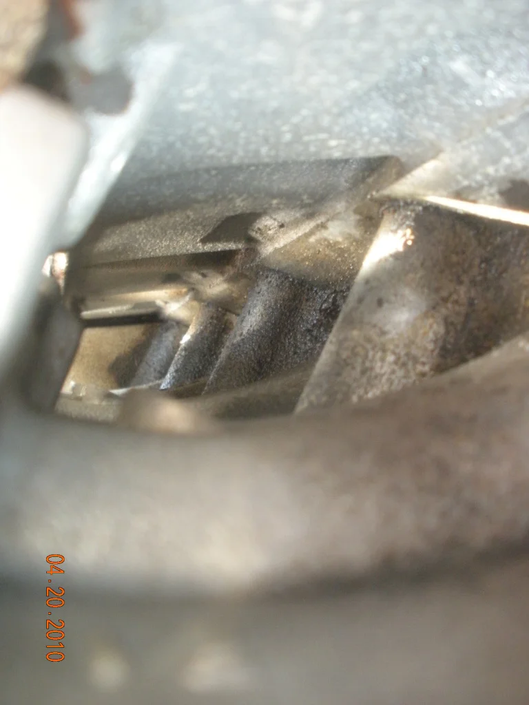

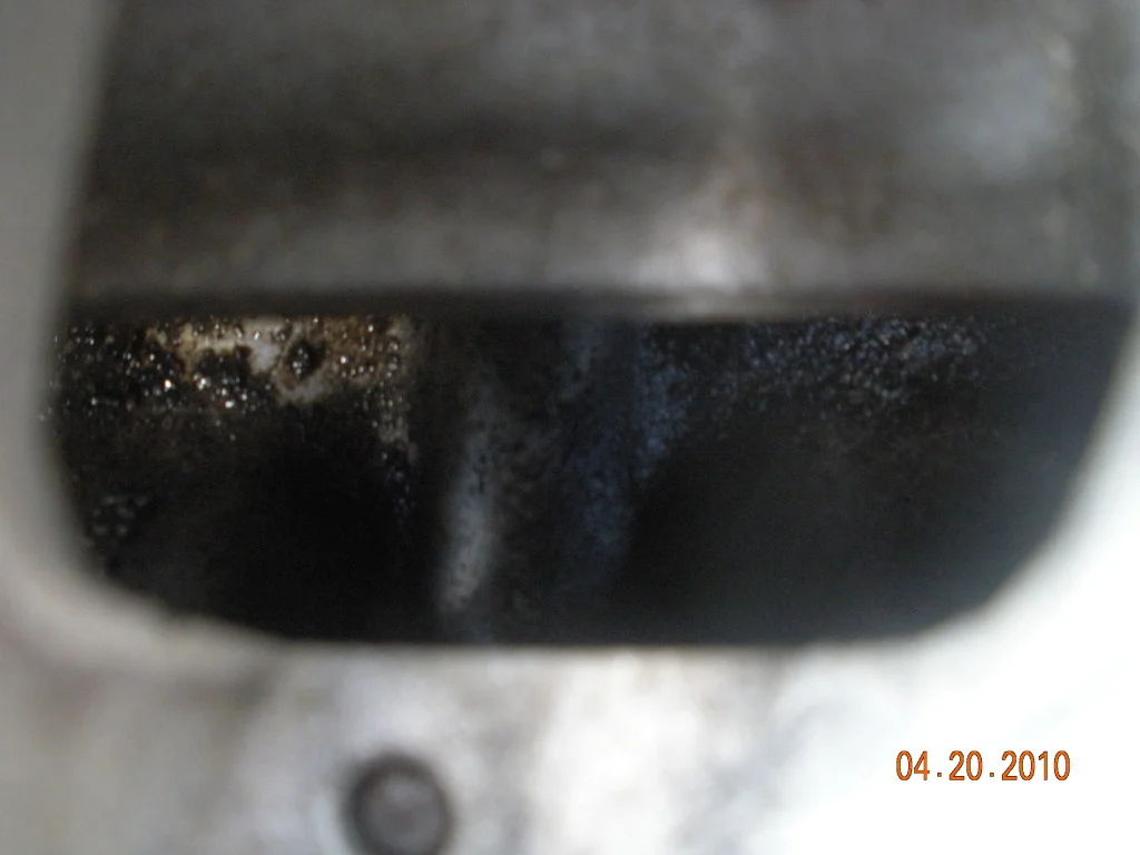

I have noticed oil sitting underneath the manifold, then inspected futher and found that oil is seeping out of the join all the way round the engine block
any help on what has caused this and what i need to do to fix this

you'll see oil pooled round the bolts, whip each one out (one at a time! NOT all at once) silicone the head and mop up the oil and torque it back in (14nm)
if it is the bolts then would you still get the oil leaking out of the join in the cover, surely you would only see it coming out throught the bolts? i just think theres too much oil being lost for it being the bolts?
ok but wouldnt the oil jus come out through where the bolts are and not the join in the cover, shown in the first pic?
