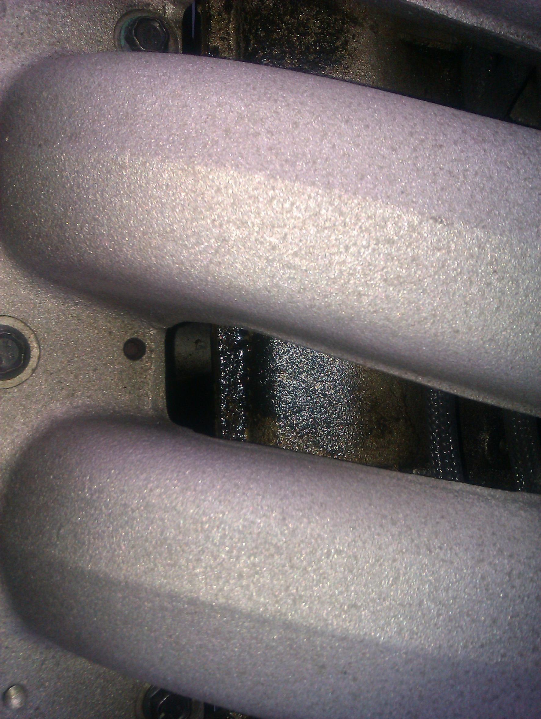

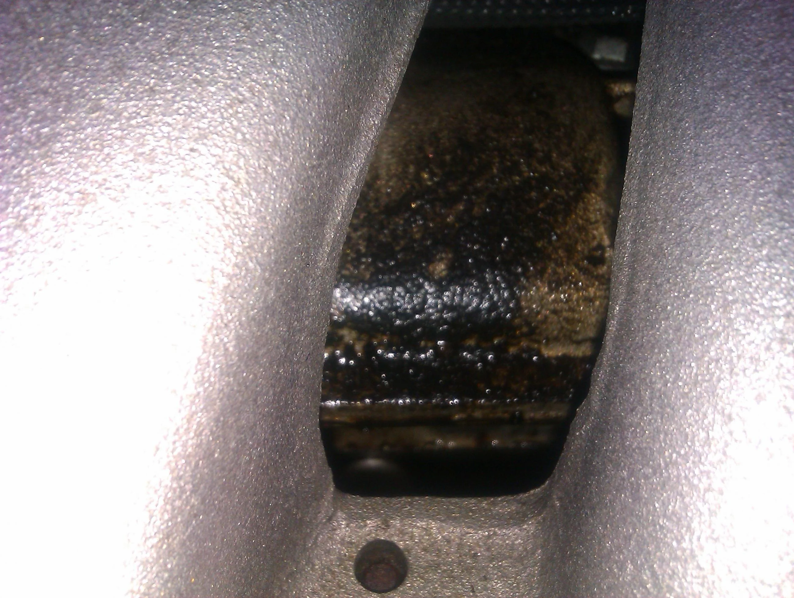

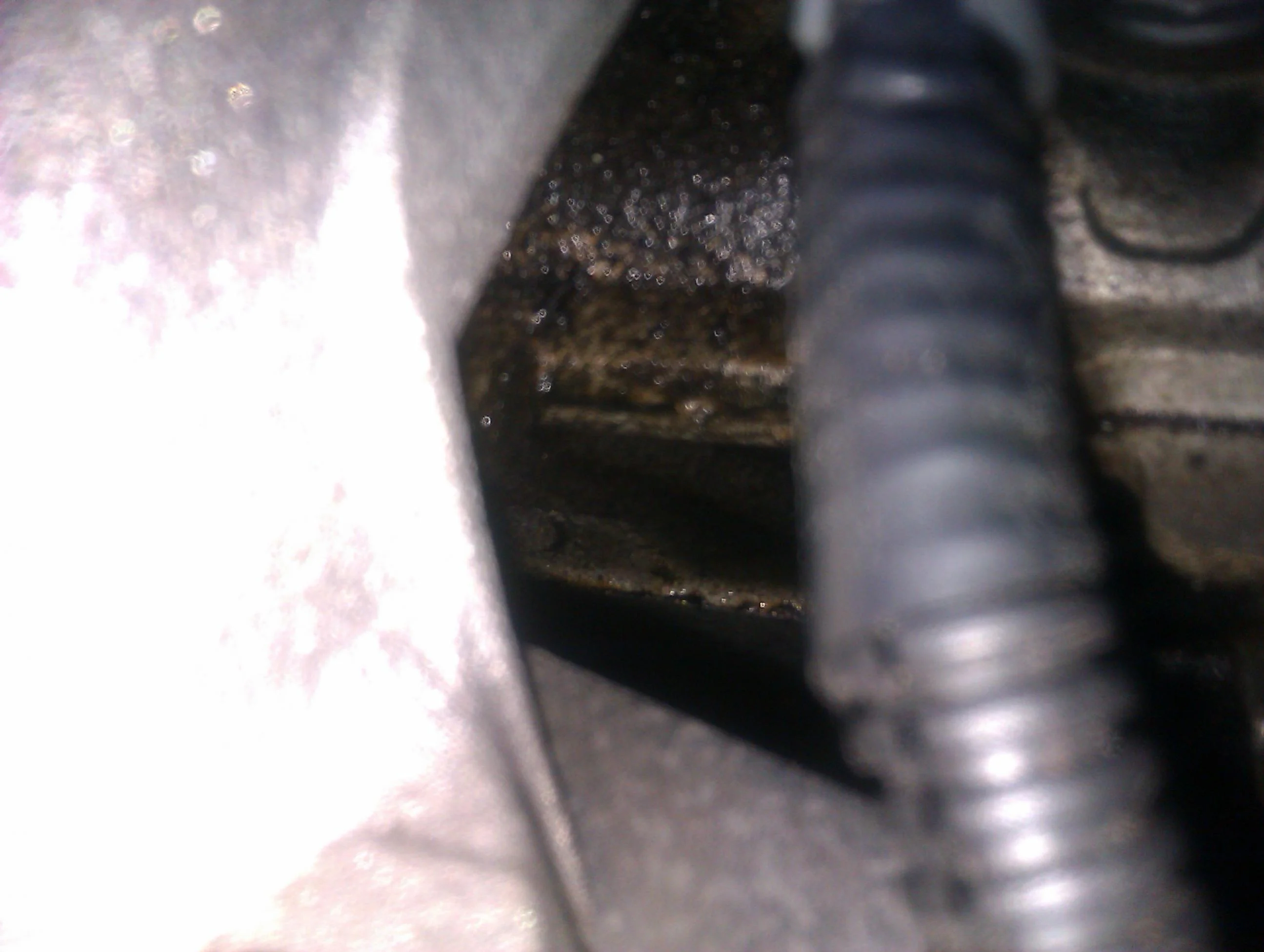

Was just checking the oil today and noticed some oil sitting under the inlet manifold. Any ideas where this could be coming from? Should I be worried. Not going to be able to getit into a garage until Friday. It is due a service anyway
yeah rocker cover leaking, it may just be the odd one or 2 bolts, but "normally" it needs resealing (big and expensive job before you ask!)

It happens a lot,some people have got away with undoing the bolts,putting sealer around them ,and doing them back up.
To get the rocker cover off involves removing the timing belt as you have to take the cam sprockets off to get the rocker cover off. Do the 20 seconds of cleaning and sealing, then cover back on, cam sprockets on a bit then new timing belt and re-time and tension and so on
i dont think its really the end of the world as its not like your oil pressure will suffer with a leak there, as long as you keep an eye on your oil level which will take a while to drop still. Mainly just aesthetic really.
Is it poss to remove the upper plenum and proper clean and degrease around the joint and clear silicone it externally? Not perfect but a compromise?

Took the car to kenneth brown today. He is pretty sure it is coming up from the bolts (all of them). Recommends that I put sealant on all bolts and see how it goes. It isnt loosing major amounts to be too worried about. If that doesnt work it will have to be stripped down and properly resealed. It isnt near the belt either so thats a relief.
