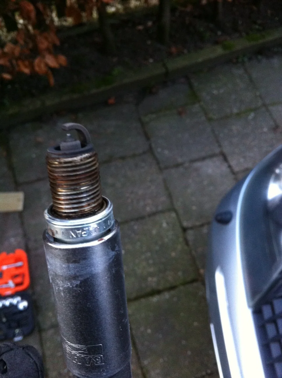

Also made a picture of a plug. They all look like this. The one on the right (so no 1 or 4) was a little wet, but from gas I think because that's what I was smelling.
Yes I mean either oil from a leaking rocker cover seal or water from jet washing etc.
Also its not unheard for the leads to just vibrate loose.
