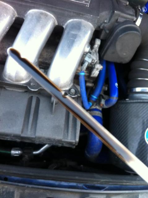

That was 2 weeks ago, I kept monitoring it, all was fine then 2 days ago I dipped the oil - it was halfway up the dam stick! :eek:
Your car likes a little drink Tigger, can you blame it lol.
Signs of a tired engine. A 1/2 litre a month is acceptable depending on mileage but obviously not ideal, keep an eye. Do comparisons while either hot or cold, don't mix them, oil expands when warm.
I mean halfway up the stick, as-in PAST the max marker haha!
And there was me monitoring it thinking my oil-breather plate was throwing it down the back of the head! (which it is)
Quick pic on Thursday off the phone
People forget how long it takes for the oil to get down through the engine. Then check it too soon, put more in, then it's too much.
FFS, no wonder its coming out your breather plate. I'm surprised it isn't passing your rings into the cylinder. I'd get under the car and drain a good litre or more from that mate.

Up until this week it was fine, even when running hot, it was under the max line!
How it goes from normal to overflow without any added oil is beyond me lol :banghead:
Only two way of it increasing when your sure the level was right is water getting into oil but you would see emulsion on oil cap or fuel in oil but it would have detonated or ruined the engine by now.
