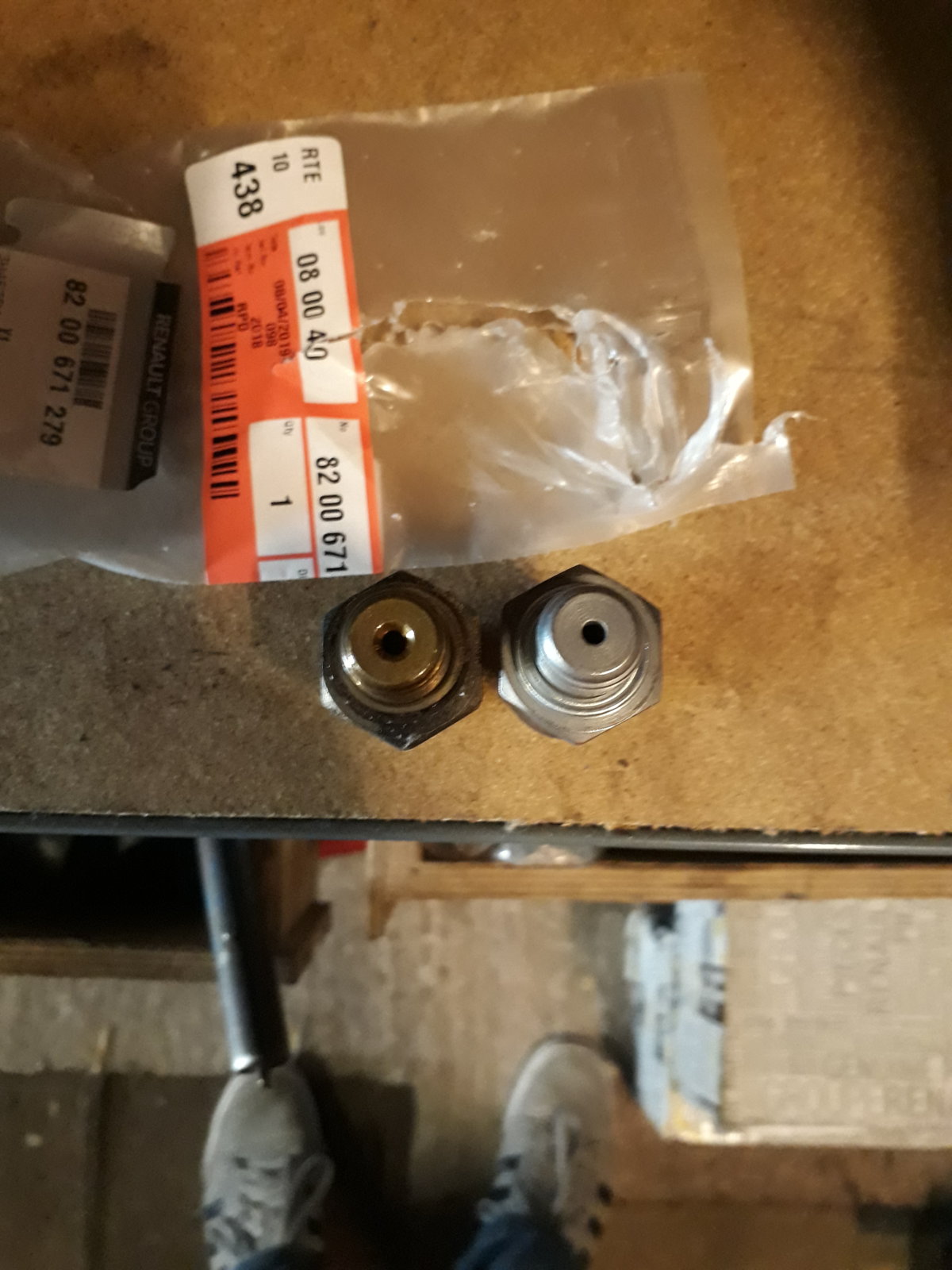

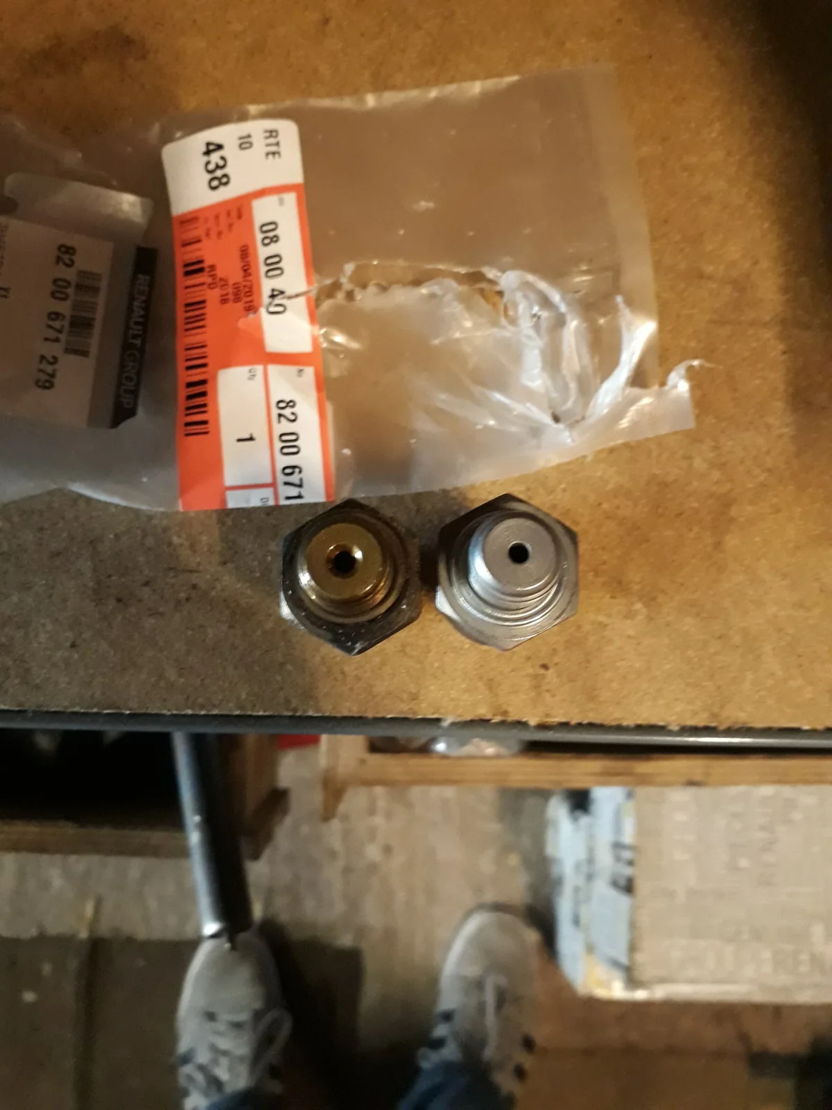

Hi
I resorted getting a genuine 172 / 182 oil pressure switch from RPD. I have installed it however before doing so I compared it to the one which came off the car.
Why does the old switch have a bigger diameter hole in it?
Thanks
