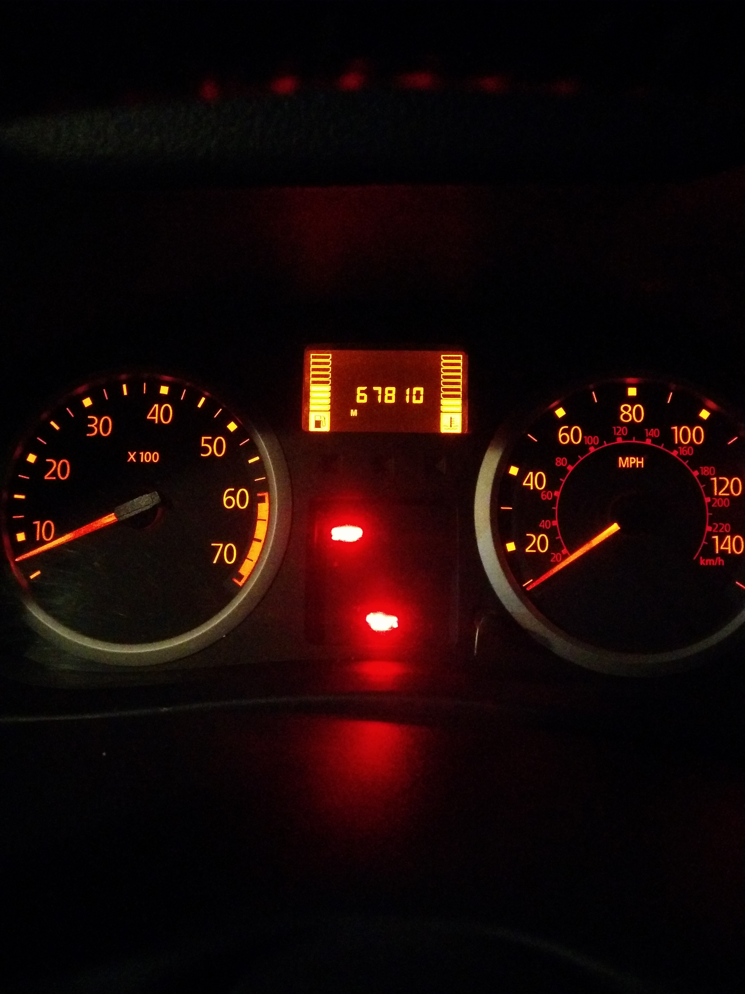

Hi all. Was driving today and all of a sudden the oil pressure light and stop light came on. Oil level is good, as is temperature (sitting between 2-4 bars). Can't say I've noticed any change in engine noise, but when you're concentrating it you just never know!
Lights only come on above 1600-2000rpm and go out whenever car is turned off and restarted.
