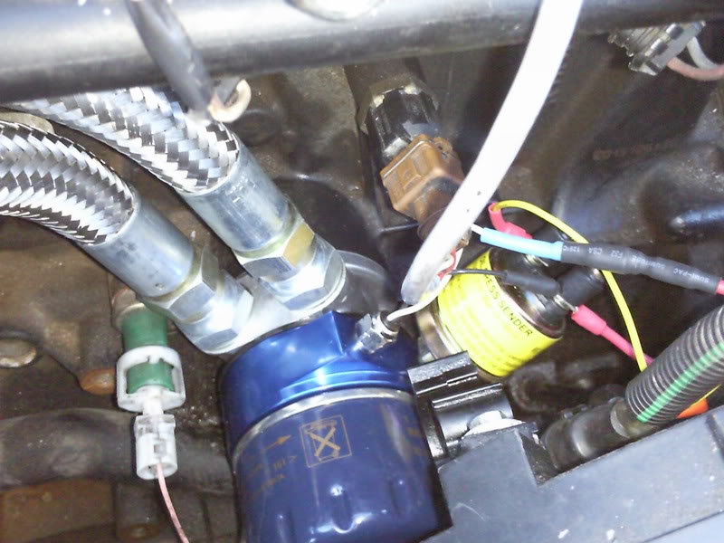

With a cheaper oil sender unit I'd remote locate the pressure sensor so NVH doesnt speed up its failure rate.
no im sure there isnt one on mine either, hence why i had to get another sandwich plate with ports to fit oil temp and pressure senders
Geesus - you got 2 sandwich plates fitted now? Does that work ok?
i have indeed, cant tell you if its ok as i haven't been able to start the car yet (lost a grub screw from the sandwich plate so oil would just pi$$ everywhere lol)

Before I shell out [another] £30, do we know if there is enough space in a 172 bay to accommodate both sandwich plates??
Just worried about BenR's comment:
its crowded enough around the take off, i wouldnt jam anything else into it.
:S
Anyone know??
Sorry, I should of been clearer.
That pic is crowded and there is less space in a 172.
