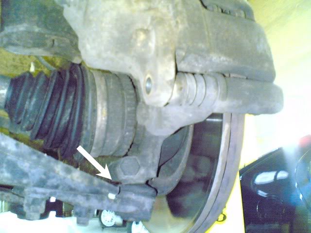

Fubar jack your car up mate, keep the wheel on work the play top to bottom, and at 5 & 10 o'clock. Get under it with a big screwdriver/prybar, get it between the arm and the hub & see if you can pull it down. You'll be able to feel/see ifs its excessive
come again? sorry, im not silly but im also no mechanic.
Where do i put the screwdriver to use as a lever and what am i looking for play in?
Sorry for the dodgy pic
Its basically a ball & socket, and the ball wears, then it can go up and down, and make knocking noises.
