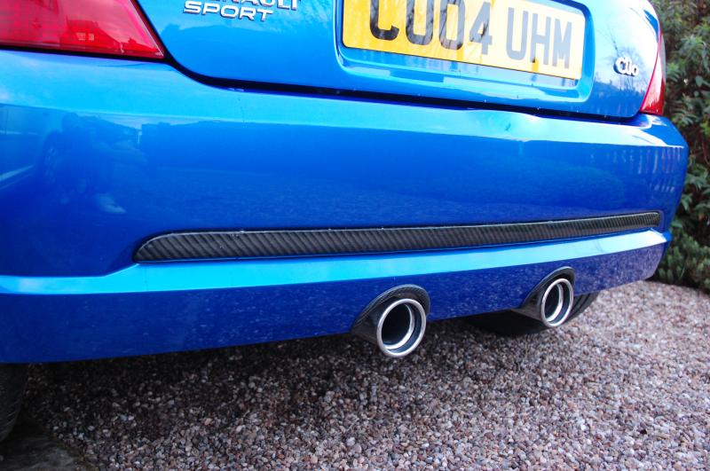

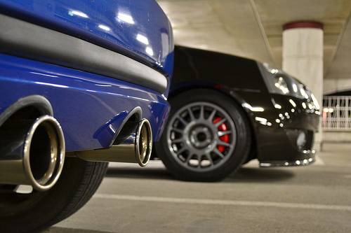

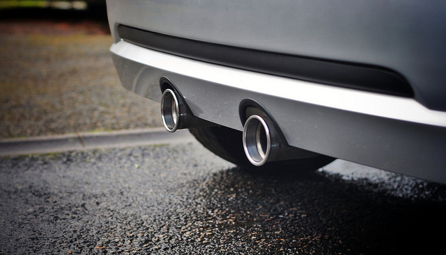

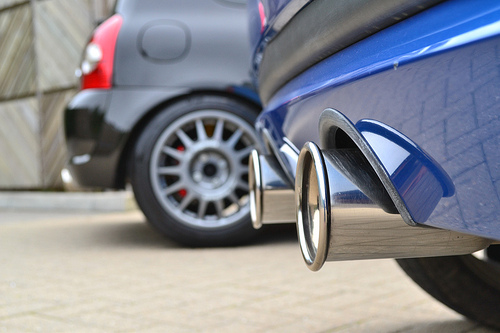

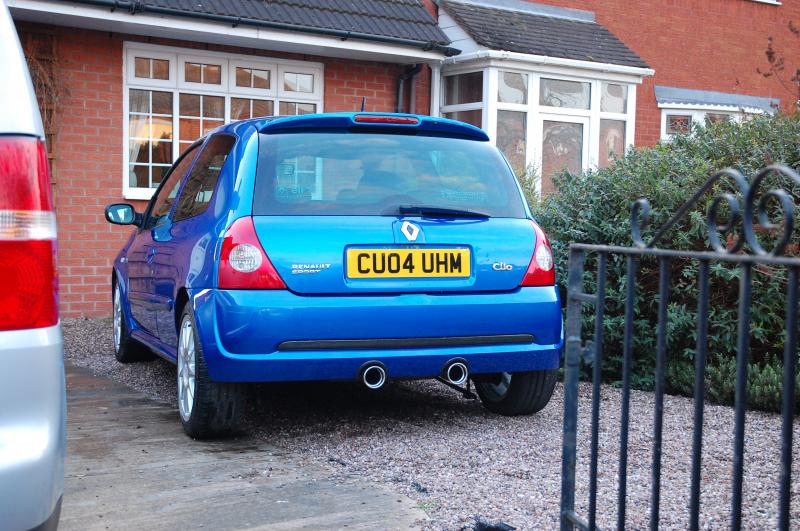

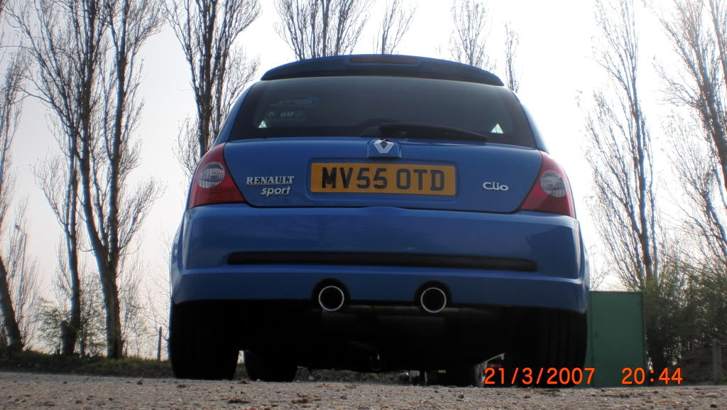

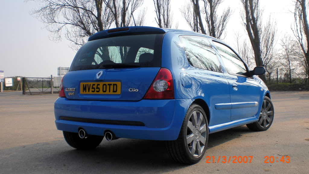

Looking for 2 good pictures of the back of a 182 running a yozza exhaust system.
Looking to get one picture from the back straight on and then either one from above looking down or side on.
Im now going to get my backside in gear and try and sort my exhaust system that sits under my bumper.
Does that help in anyway?
That is perfect !!!
Its picture like this im looking to get so i can see exactly how far it should sit out.
Mine now sits very slightly further out from that as I modded my cat-centre join, wish it was still like above!

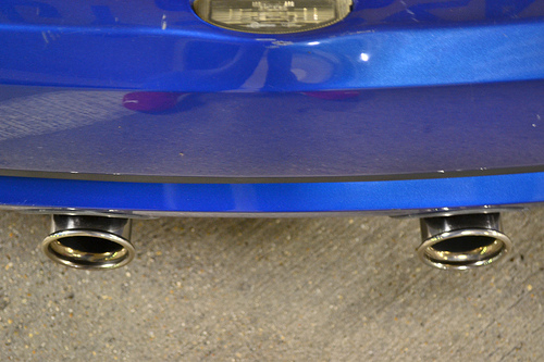

I noticed yours is exactly the same as mine.
Maybe us scottish yozza owners are doing things back to front.
Im going to be changing everything buddy, From the CAT back all new rubbers, nuts, bolts & fitting kit.
Im fairly sure something has been made wrong with yours, as there is no way you will make it come out about an inch with all that.
Im sure I read something about it previously as there has been a few people with that version.
Maybe Fred could confirm?
  Lionel Richie
possible, but i know of only 1 dodgy one that we replaced under warranty (in 8years!)
some you need to adjust the engine mounts and the bumper, others you literally throw it at the car and it fits perfectly!
i can take measurements so you can compare your backbox to make sure its ok

Is the backbox to centre section sleeved or flange? On my milltek it's sleeved so the amount it sticks out can be easily adjusted this way ?
  Lionel Richie
It could be possible to get a 10mm spacer made to put between the two flanges which would move the backbox out a bit!
doesn't need it, as you can see from the other photos they fit perfectly, just some cars seem to be "friday afternoon" efforts ;)
