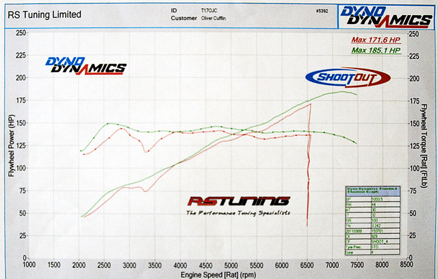

The initial run (standard map) it went in at 171.6 HP.
Paul then did his thing and it produced 185.1 HP.
A standard 172 would be around 165 I imagine? So I've seen a pretty solid increase from the RS2.
It's really shown how important the mapping is for these kits too; the torque in the mid-range especially has picked up nicely.

It actually made 187 during one run iirc, but then it was adjusted slightly to give more torque in the mid/top end.
But, as you've said, considering a 172 is around 165bhp; I've effectively gained around 20bhp from the package. :)

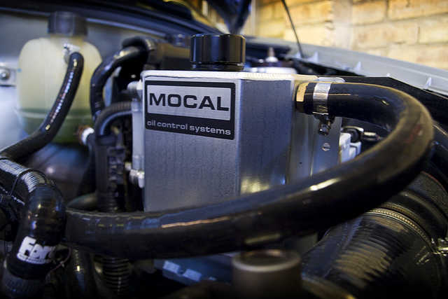

Alongside this, the lads also fitted the black silicone hoses and mocal catch tank I'd bought to supplement the manifold. There was no real reason for these additions, other than aethetics and tarting. :cool:

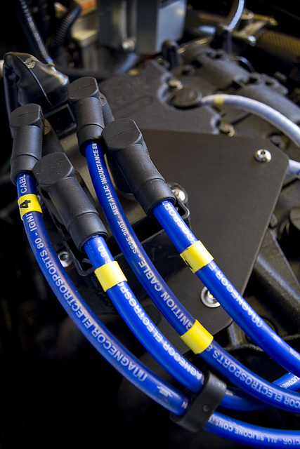

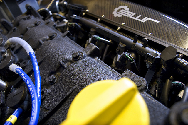

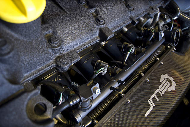

So, to throw up a few photos of my engine and the RS2 finished. Some I've posted previously, some not;

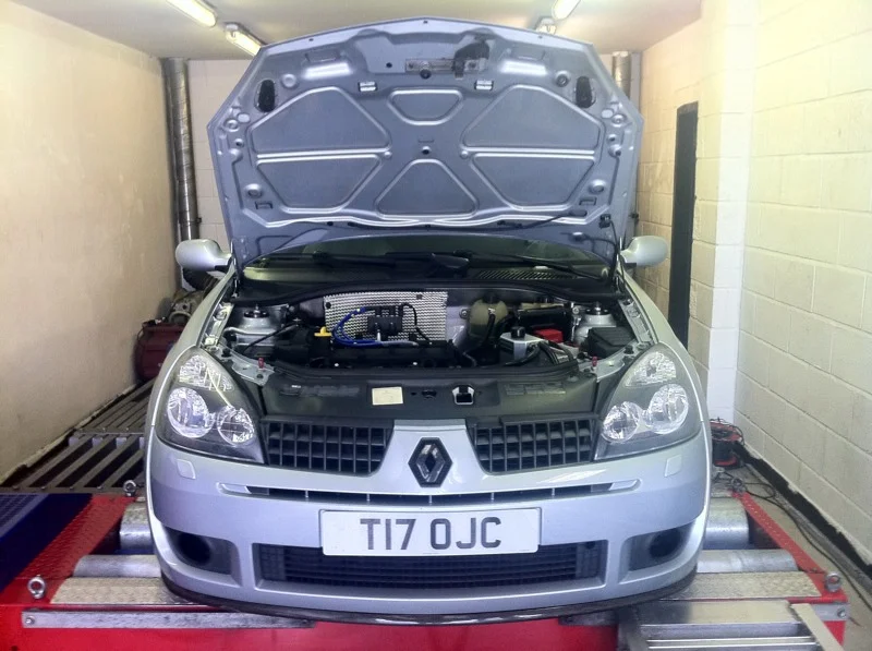

I ran unmapped like this for almost a couple of months, before yesterday, I took a trip up to Leeds so that Paul at RS Tuning could work his magic.
A quick iPhone snap from yesterday, after the car had just been pulled onto the rollers;
When it went in yesterday, on the standard map, the car produced 171bhp.
About an hour later, with Pauls mapping, it was up to 185.1bhp and the torque was looking much better. :D

Glad your liking the car Ollie, what torque figures did it make? mine peaked at 150lbs and ran at around 145lbs throughout the rev range, drives so much better and pulls from way down the rev range, as paul said i could of had a little more bhp with decat and exhaust but the extra few bhp i would not notice, but it produced the nice torque figures what the product achieved, mine ran around 160bhp standard so i have gained the same as you about 20bhp ish from the RS2 and remap
Re: Ollie's Silver Cup - JMS RS2/428s/Wilwood/2118
Peak torque was 150lbs at a fraction over 2500rpm.
Like Dean's it then runs at around 145lbs throughout the range, before dropping off slightly at around 6800.
It's completely eliminated the flat spot I had mid-range.
I do have a print out from Paul of the graph, which I'll post up when I can; I don't have a scanner at home anymore though! :dapprove:

Think this is about the best post of the graph I'm going to get without the use of a scanner. :)
Did you also have that flat spot between about 2750 and 4000, before mapping? :)
I can't remember how your original graph looked.

How come you dropped the cams? Or didn't you?
Also, why does your pre run drop off at 6.5k revs? Cold limiter? If so it might of had more in it pre?
Cams were dropped and sold a few weeks ago; they never actually got fitted in the end.
The long and short of it is, it didn't look very promising that they'd work well alongside the RS2. My understanding is that the RS2 was designed around the completely stock engine; ultimately, it proved better to keep it that way. :)
It must have been the cold limited; surprising though, as I thought it would have been up to temperature easily.
It probably was up to temp, the sudden high rush of water caused by full throttle on the dyno probably blew some slightly colder coolant past the temp sensor, causing it to hit the cold limiter - it takes a fair while for the whole coolant system to reach a level temperature
Probably not the most accurate graph then...
Just checked mine, and power did increase after 6.5k. Only a few bhp but still, to be a fair comparison it would be better to be a full run.
The pre-mapping figure (171.6) isn't really much use for a comparison anyway, as really it's the RS2 package at a half way stage.
It does go to show how important calibration/mapping is to the RS2 though, especially looking at the torque curves. :)
It's a shame I never had the car on a rolling road when the car was standard before the RS2 was fitted; then I'd have had a definite before and after for comparison.
I think typically standard 172's make around the 165bhp mark? Given that the car's now 185bhp, I'm really happy with roughly a 20bhp gain from the package. :)

I see, i presumed it was from before everything.
Yeh, would of been interesting to see a genuine before and after!
No mate, sadly I have no standard results for a proper comparison.
The pre-mapping figure was as the car arrived at RS Tuning yesterday, with the RS2 fitted. :)
