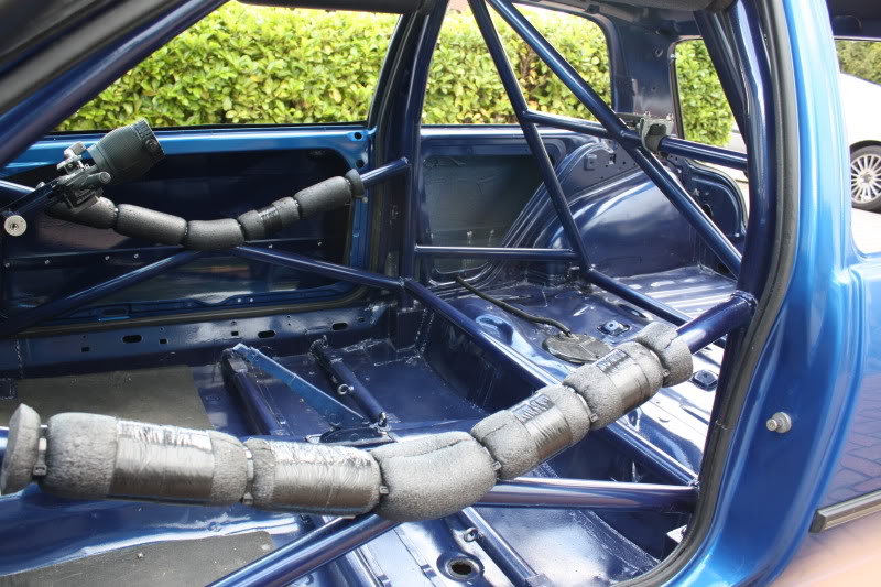

I used the supplied door bars to make a removable harness bar on my old one

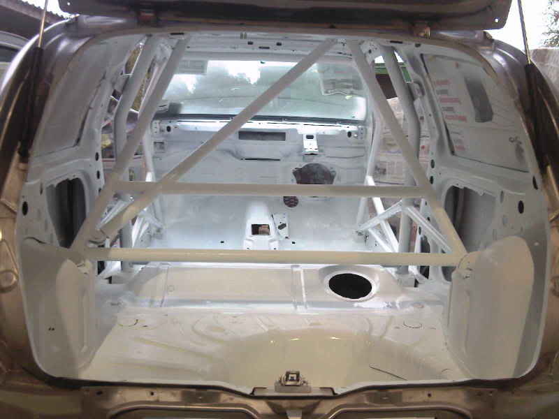

Yep - this is mine
Started off as the OMP 6 point cage - had another diagonal welded in to make a full cross and then 2 harness bars :)
I personally wouldn't want one where the one is in the pic above - it's too low really
