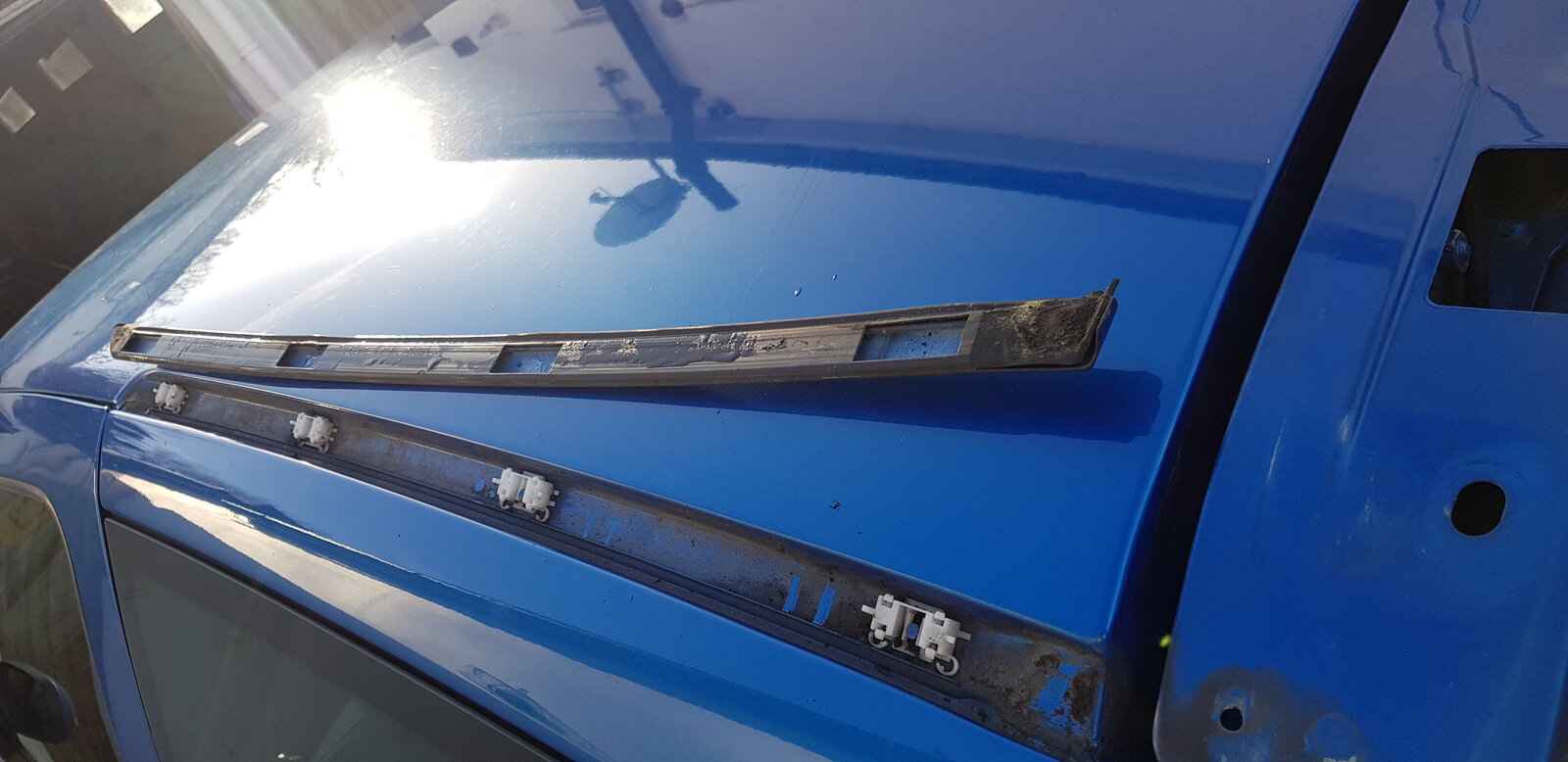

I read (maybe on here) about a guy who found a gap in the welded seam between the roof/side panel which is accessible by removing those bits of trim/strips on the roof. I also have a small amount of water coming in from higher up and I can only assume this is where it’s coming from as everything else like all the seals seem fine. Need to inspect it but I’m having a right game trying to remove the strips.

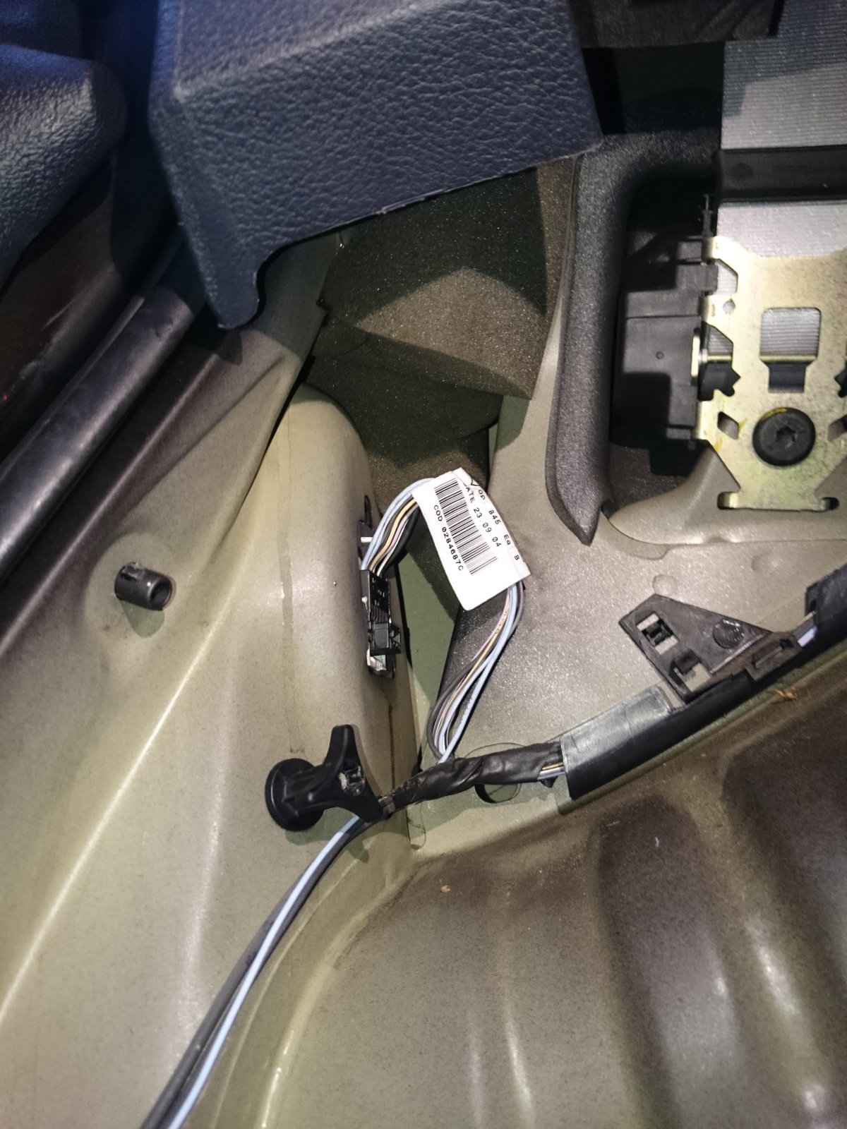

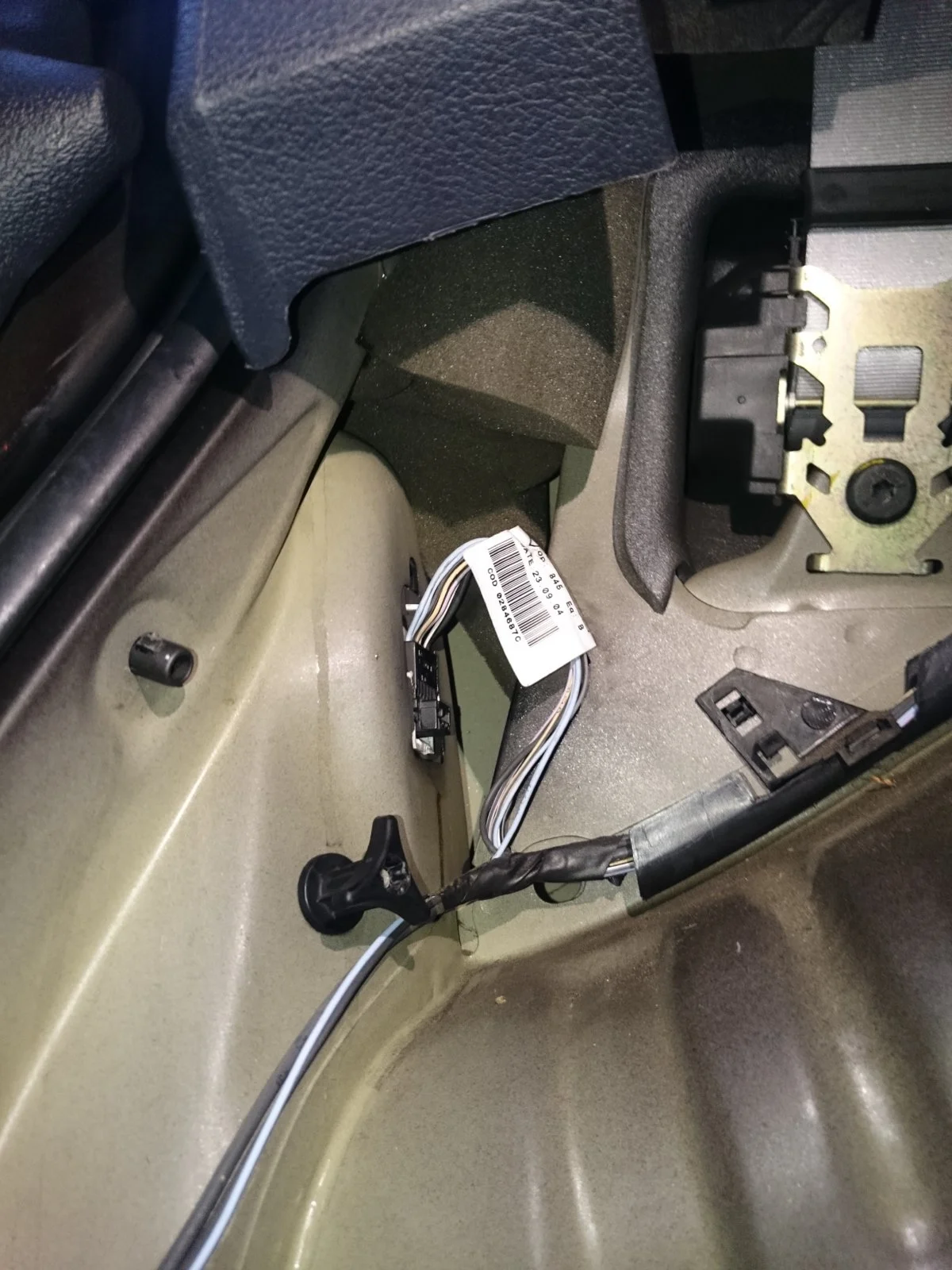

Worth checking to see if these black grommets are loose whilst you're there. Bit of silicone around them and it all good

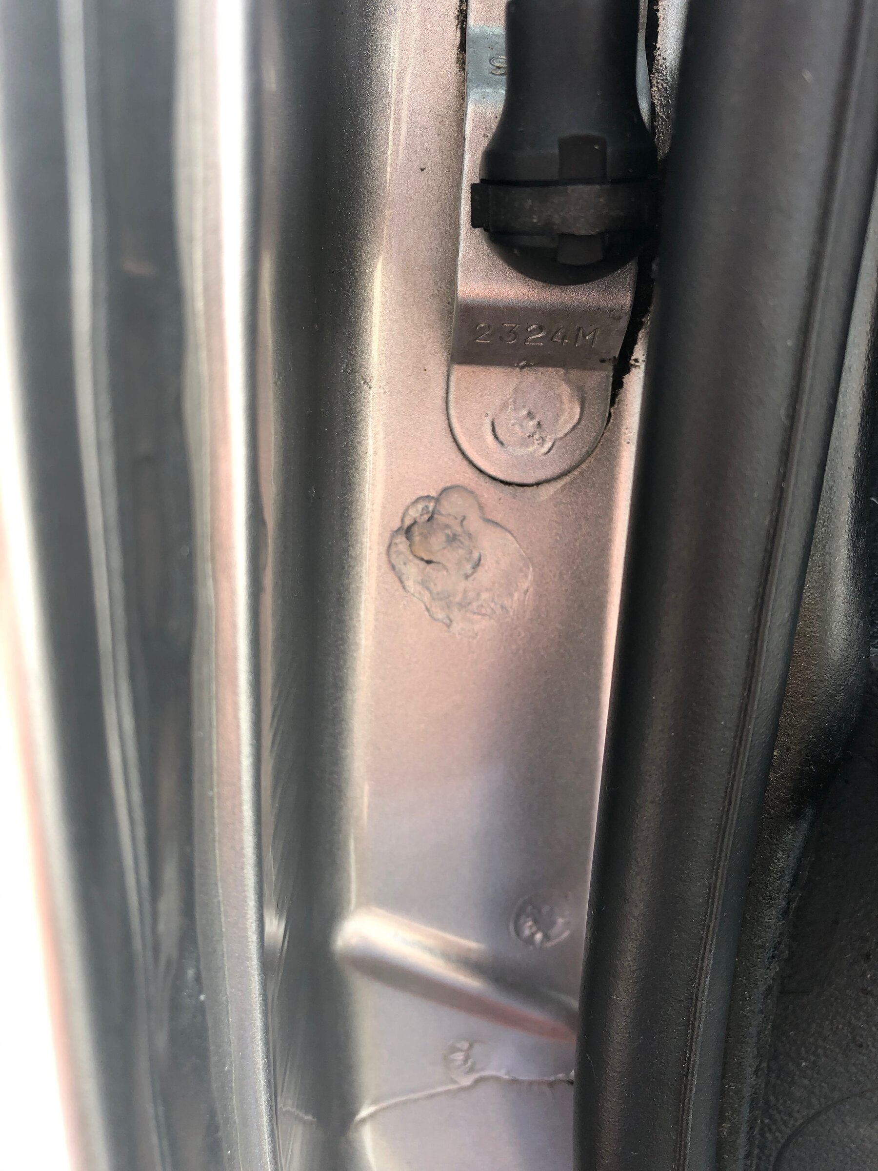

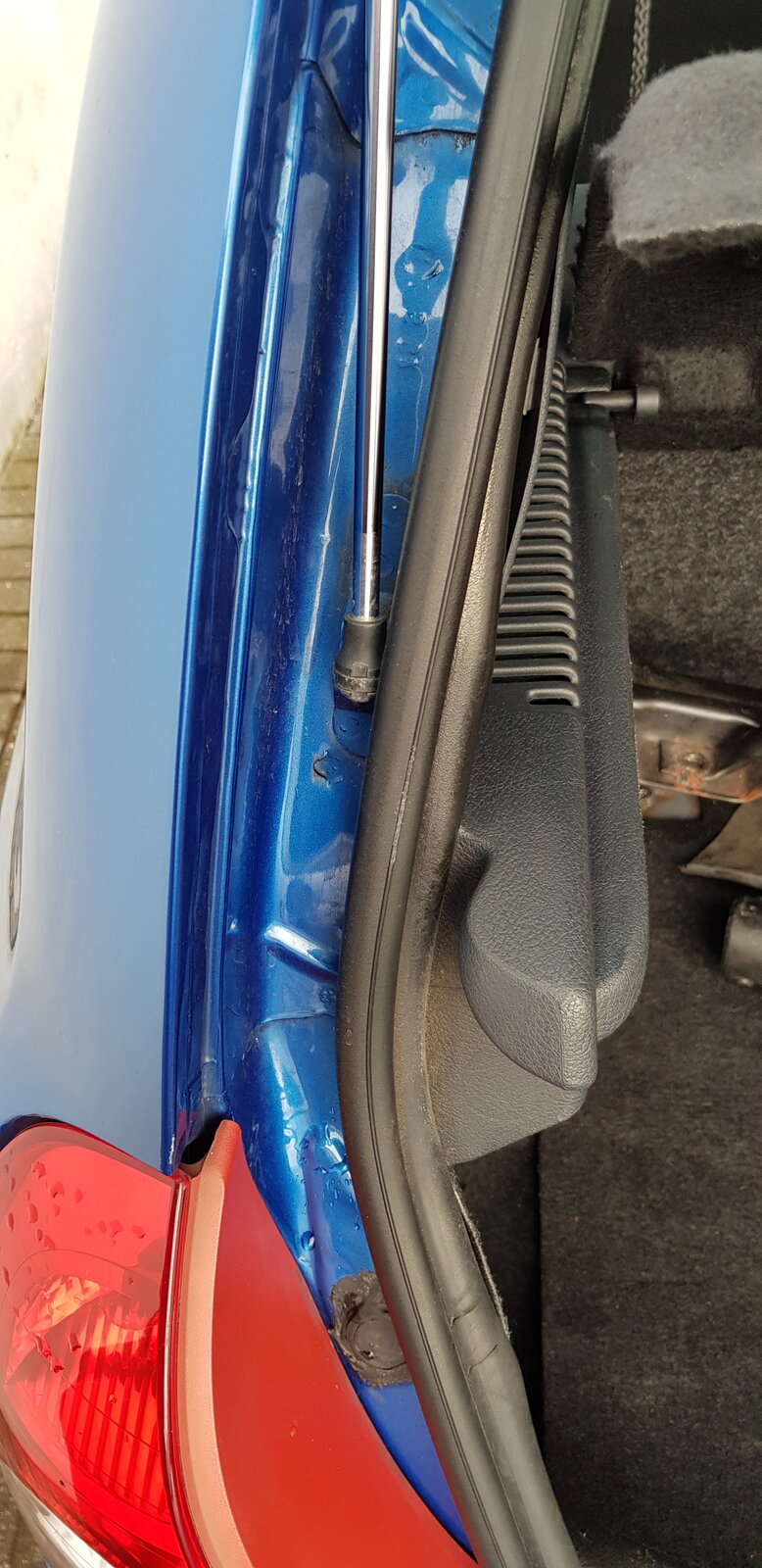

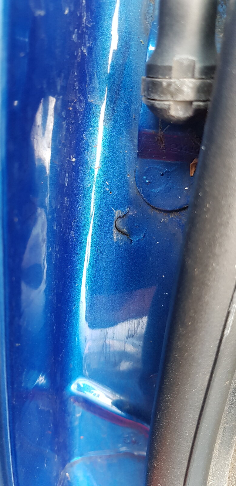

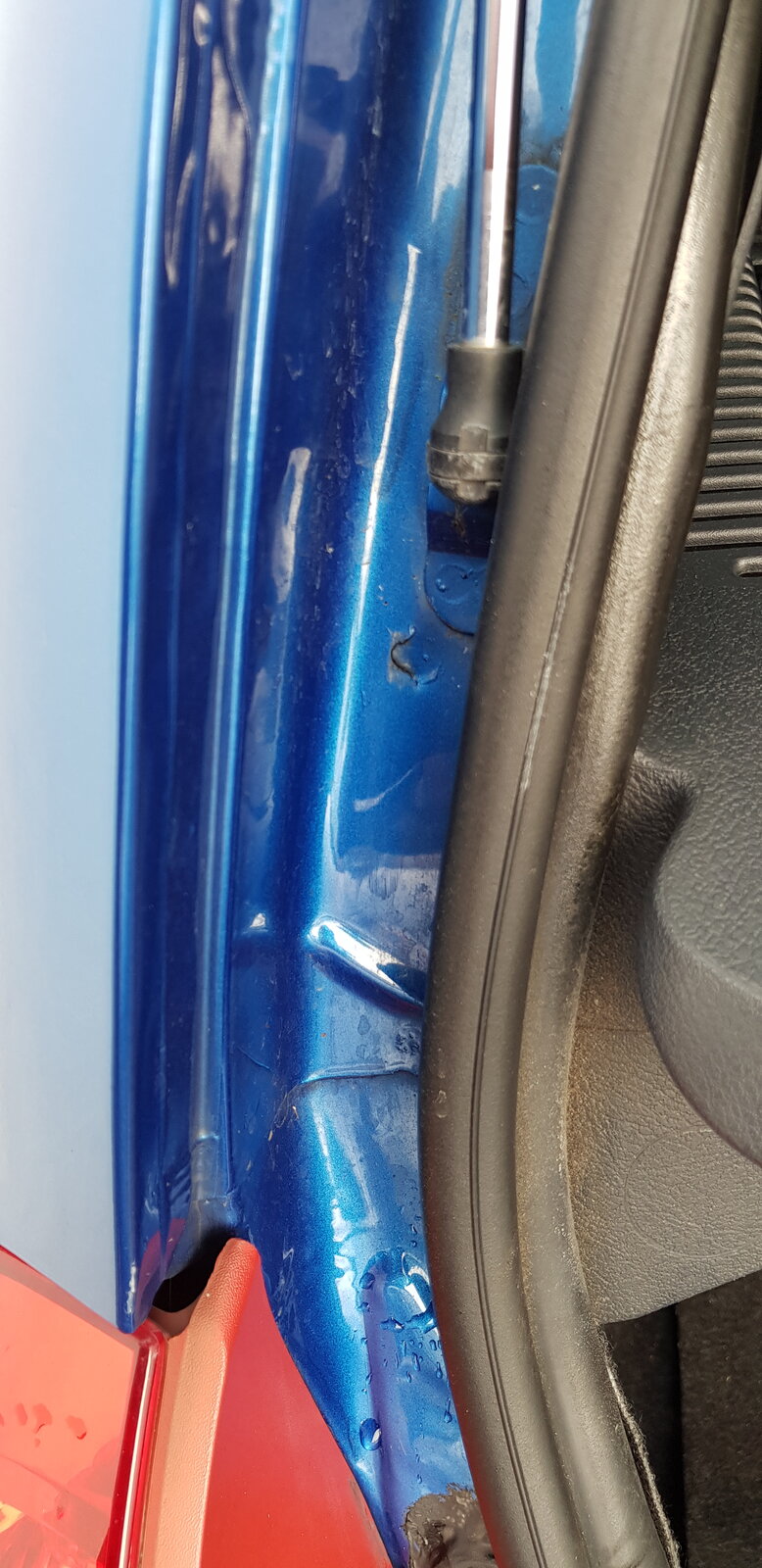

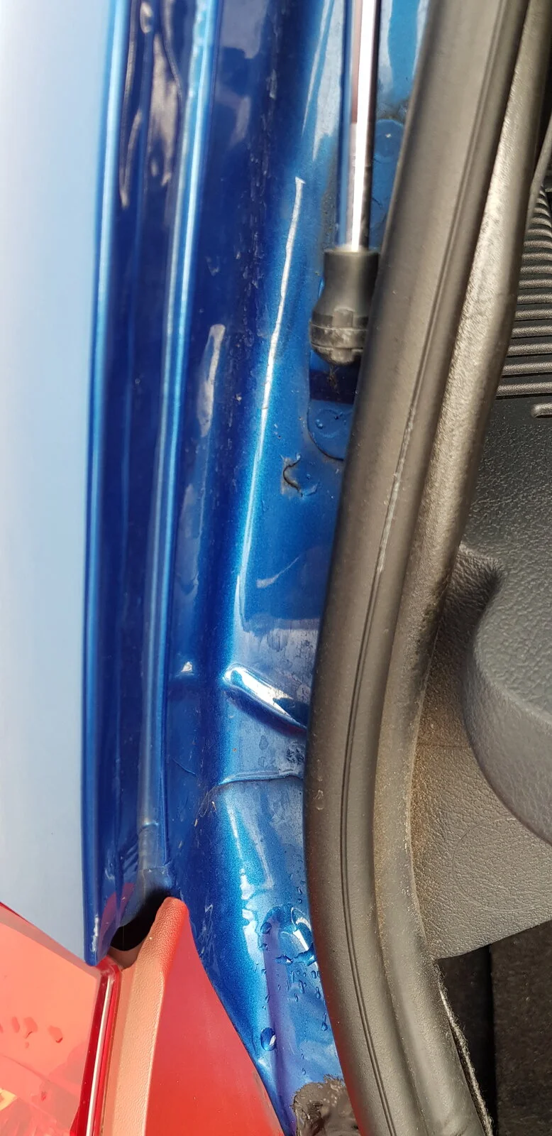

I had a similar problem in my track car. Sealed the grommets up, checked the lights, checked the spoiler. Turned out to be one of the spot welds in the panel near the boot seal either just below or above where the boot strut mounting is. Was letting in water pretty much where yours is.
Check around the boot strut mounting too. I just put a small dot of silicon on the split spot weld and not leaked since! Took me a while to find and not easy to see. It was letting in a good amount of water for such a small hole.

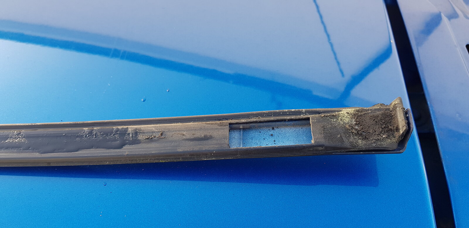

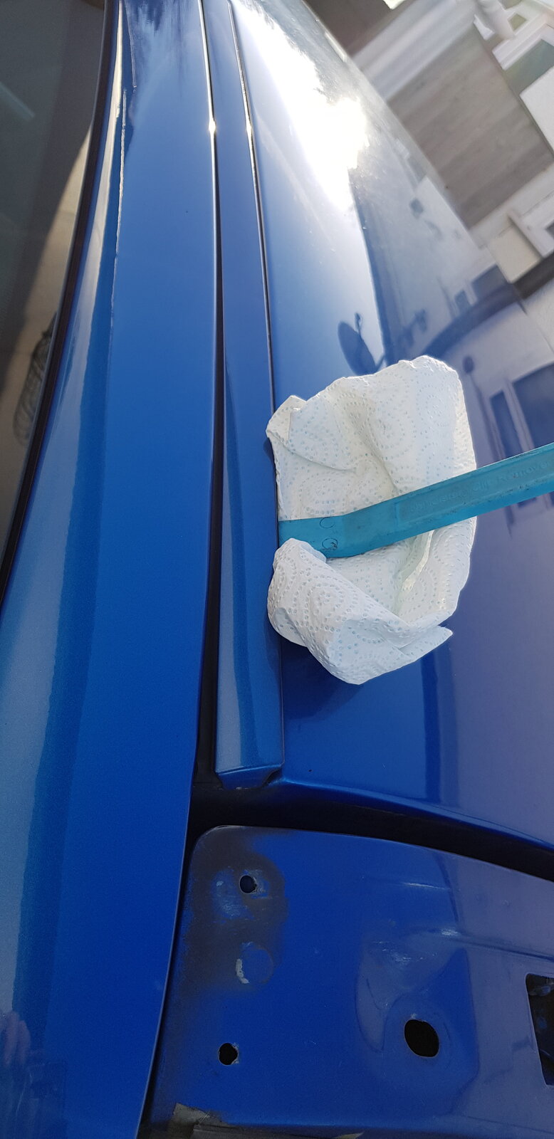

The roof strips prize up with a trim tool. I have a 182 that I am breaking so will try and get a picture with them removed. When I have removed these previously there was no where obvious water could leak in and it would have made the headlining damp if it did. Hope that helps @Stink 182 @Crispy182
A pic would be great 👍 So to remove them, you dont have to slide them back, you can just prise them up away from the rubber?
Pretty sure, have removed several over the years. Definitely don't slide from memory. I will take them off the car I am breaking in the morning to confirm and grab some pictures.
Thanks buddy, that’d be a great help. I’m a bit scared to use too much force in case I break something
Hi mate. Use a trim removal tool. They pull upwards out of the plastic clips. Prob best to do when not freezing cold to save the clips. I worked from the back towards the front. Hope that helps. Pictures should give you an idea too.

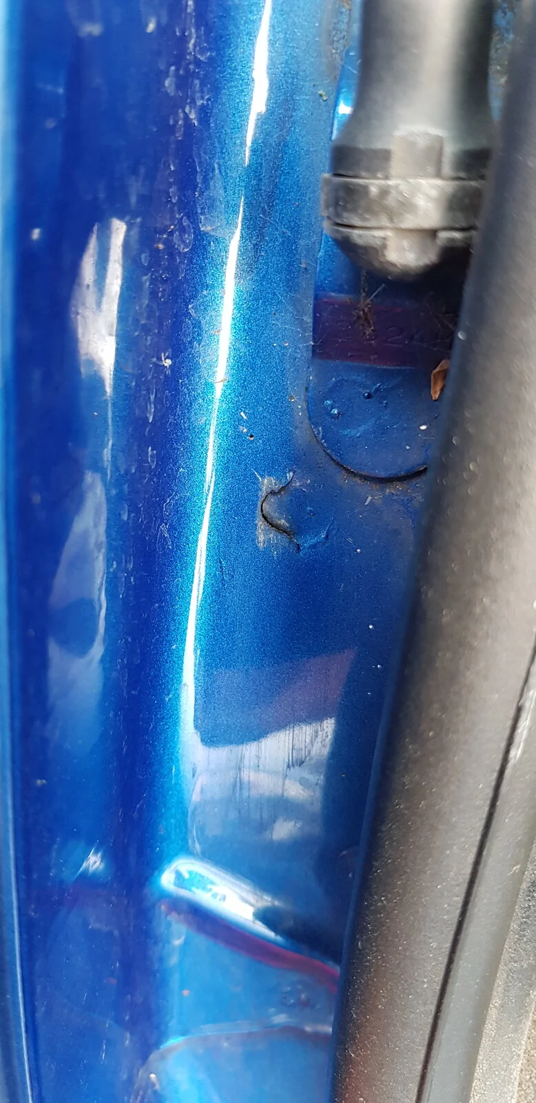

Just to update this thread as I have picked up another 172, which I discovered was wet in the boot this weekend even though the grommets were sealed up. This is the second one I have had with a split spot weld. I have got a picture as will hopefully help a few others out that have the same problem, but not too sure where to look. Just seal it with a bit of silicone.
Thank you for posting this! Hoping this is the source of my leak as I have the same split.
Some of the spot welds are quite hard to see and its generally the ones in and around the boot strut area, it must be the weight and movement of the boot that causes them to split. It's amazing how much water gets in through such a small hole too!! Just use some silicon to seal. Have you done the boot plugs too, that is the most common cause of water ingress. Post how you get on 👍
Been a few months, and even in the recent deluge the boot has stayed dry!!
