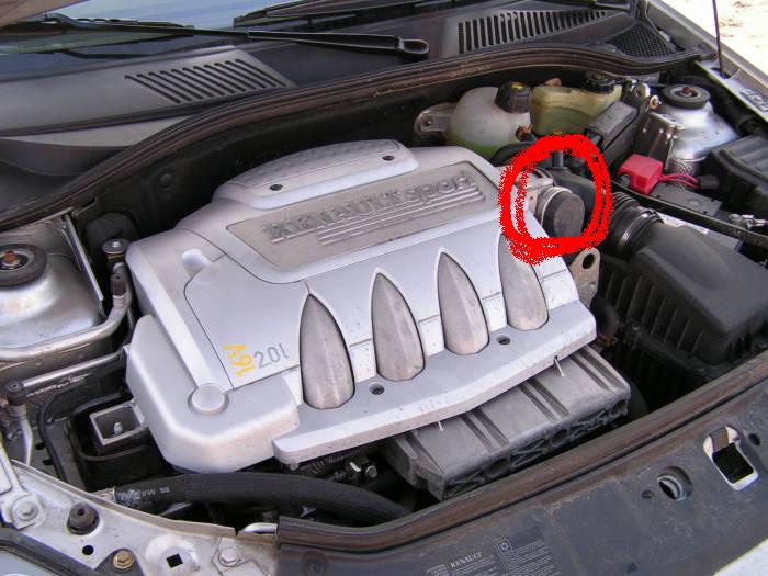

I attached a picture. The thing on the picture made a very loud zooming noise a few weeks ago. Car wasn't running, only contact on.
