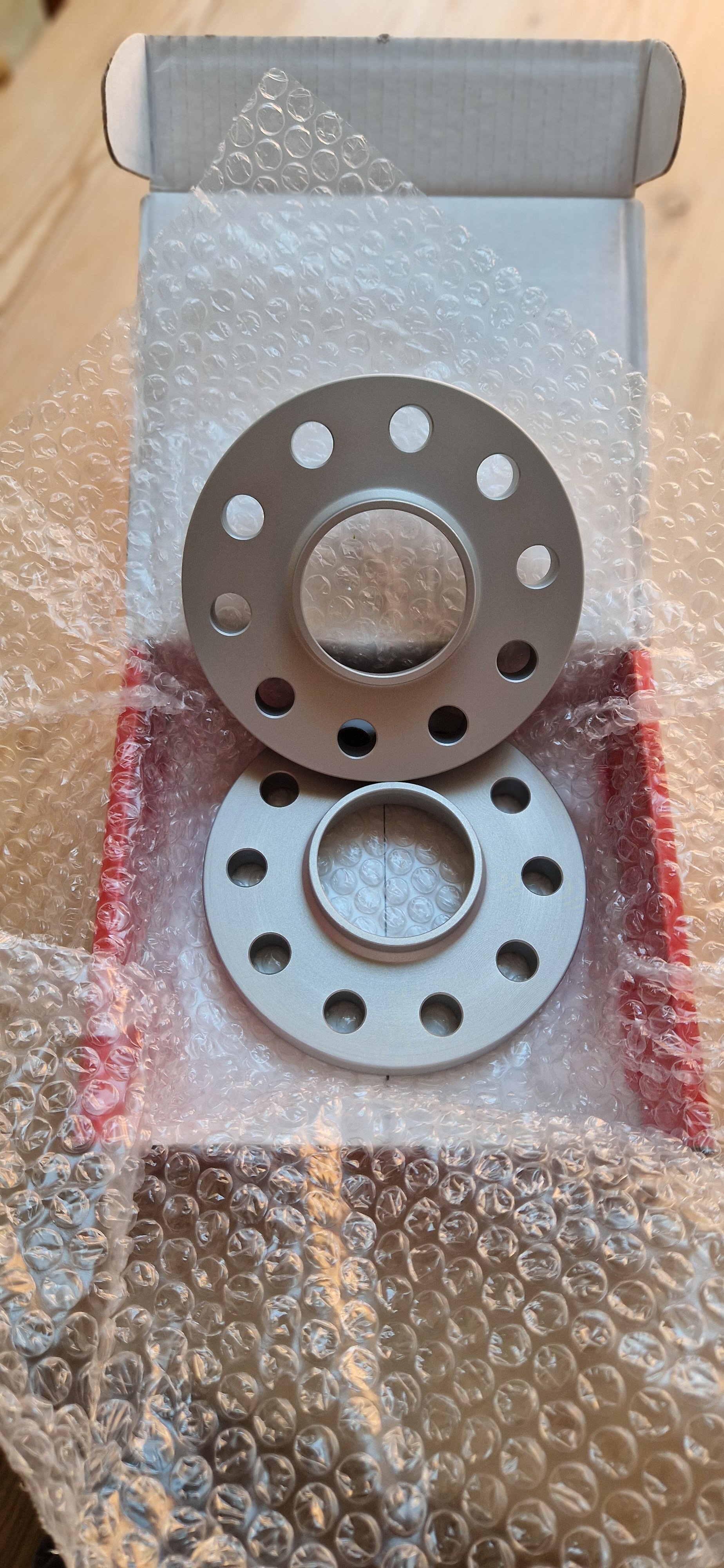

Not too much to update here. I've swapped out the 20mm front spacers for 16mm eibach items. Makes the front track match the rear a bit better rather than having the wheels pushed out so much. Also it feels slightly lighter and nimble, could be in my head though.

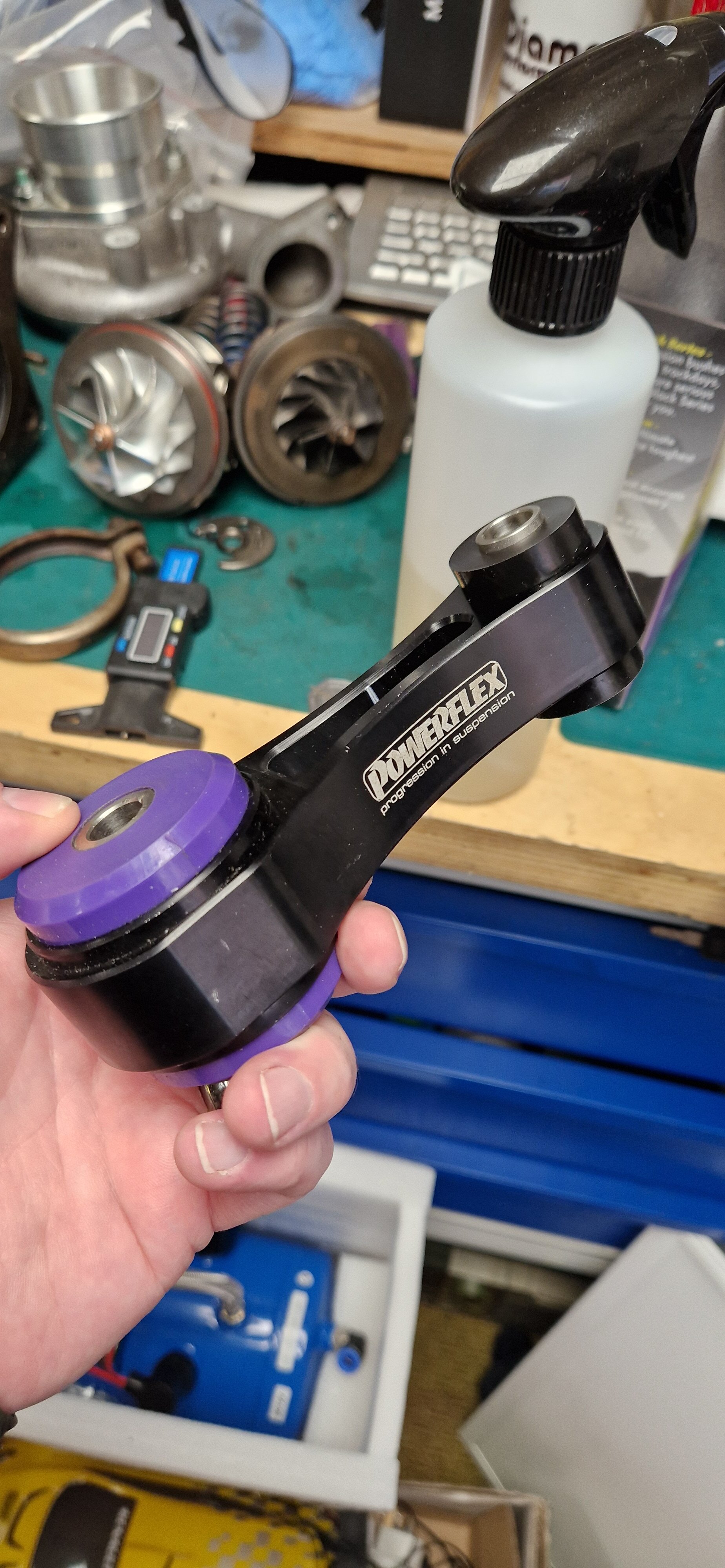

I've also received a powerflex dogbone mount that i need to get around to fitting. Im sure with just over 100k on the clock the mounts will be showing their age, so this should tighten things up a touch (y)
  2014 Clio 200t edc
I fitted the purple power flex to mine, but I couldn’t deal with the feel of it. I fitted a purple one to my 182 and 172 and was really impressed, but for me on my 200t was too much. I was in talks to get a yellow bush instead but didn’t get round to needing one.

Had some spare time so fired on the Powerflex mount. Not actually driven it yet to see what its like but there's is an increase in vibration just at idle, it was expected but we will see how it is once I take the car for a run. Captured a bit on camera so slapped together a quick vid. (y)
Matt Cup
  Leon Cupra
I had a purple gearbox bushing in my first Cupra, would have preferred the red or yellow to be honest as the vibrations were a little too much for that as a daily.
Adey.
I've been told to give it a week or two to bed in. I drove it yesterday and its pretty savage at fast idle and when pulling away. Feels lovely when on the move though and even though I didn't notice much slop, the front end feels more connected. I may end up going to Powerflex to see if I can just get a softer bush for it. We will see though.

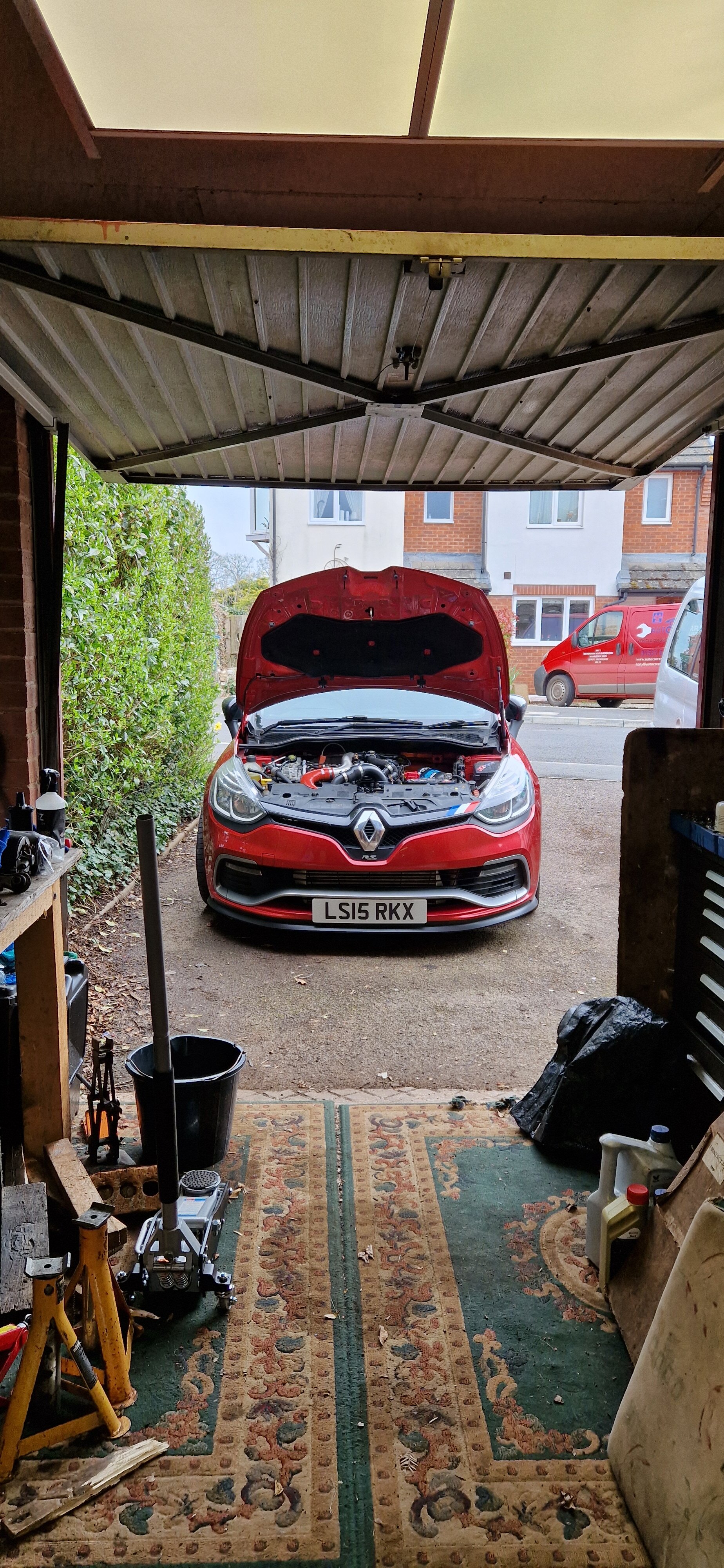

Parts still aren't here from autodoc.... annoying as I wanted to get it all fitted up this bank holiday weekend.

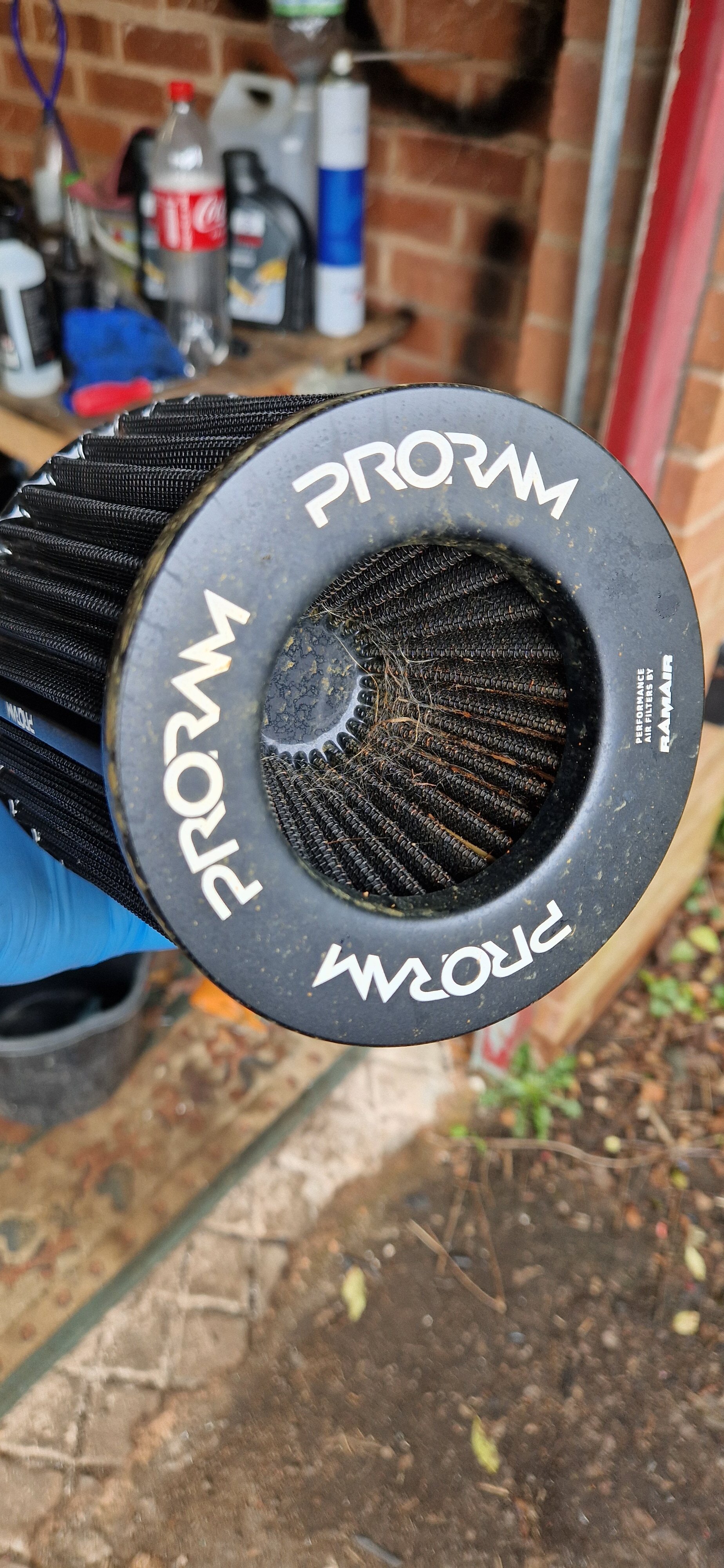

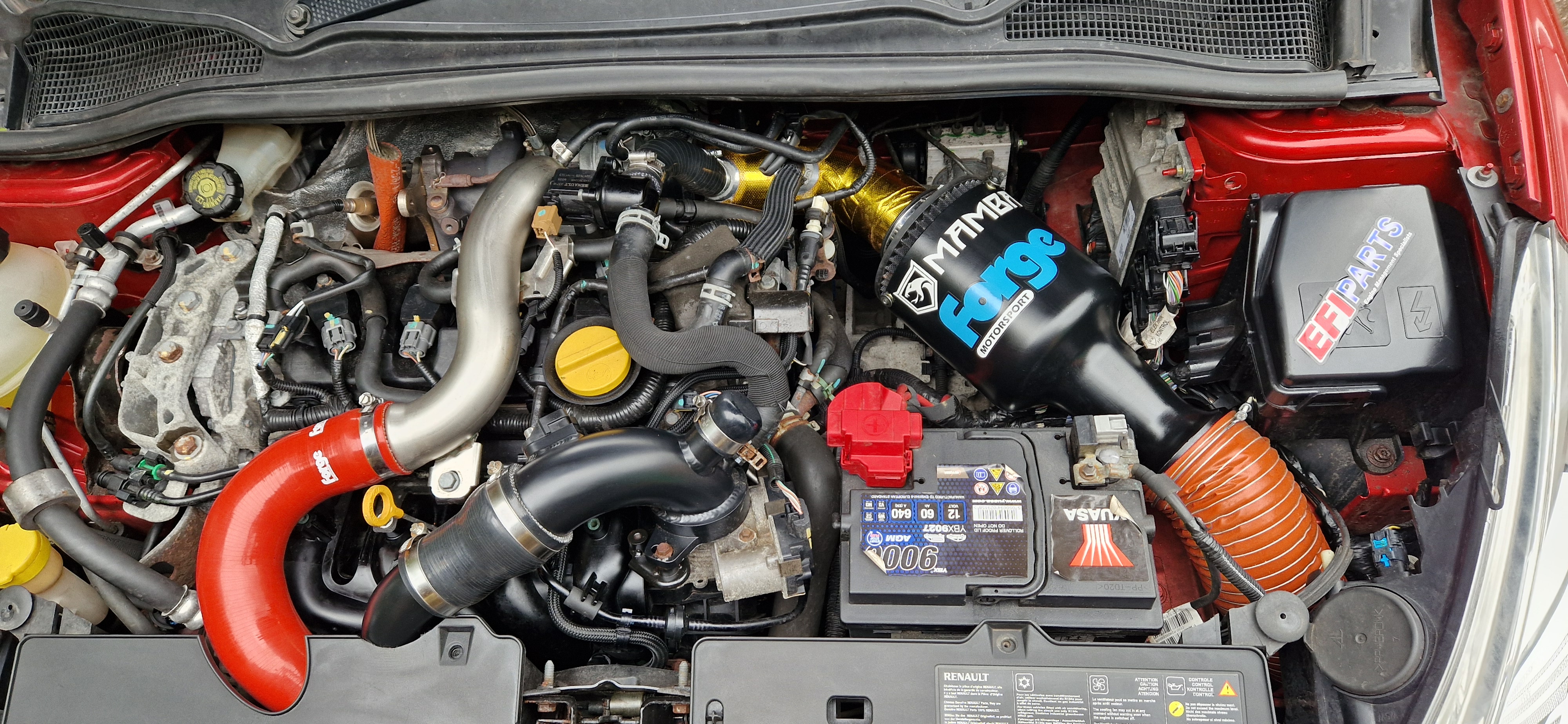

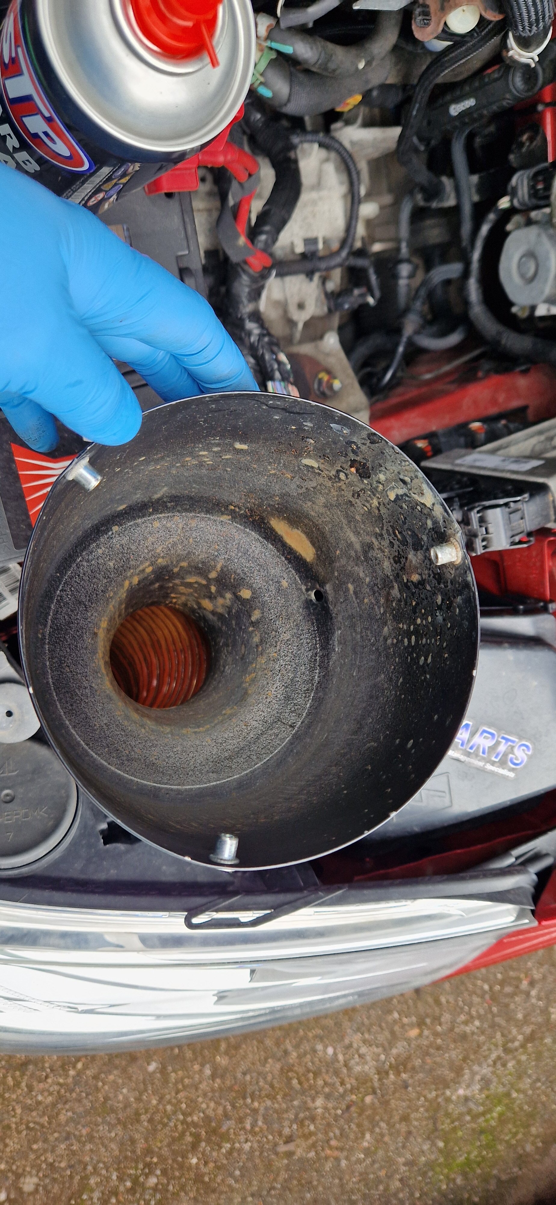

Anyway bit of a check over on the turbo which is still fine, has no excessive play. I whipped off the filter and gave it a clean. The ducting pipe and filter are pretty dirty so that kind proves that it's working I guess. There's also a fair bit of dirty water staining so it's also throwing dirty road shite up there pretty well too.
Gave everything a wipe down and gave the filter a rinse off too. Should be good for another few miles.
The powerflex mount has definitely quietened down too. There's still more vibration than stock but a lot less than when first fitted. Still undecided if its more than I want to live with though.

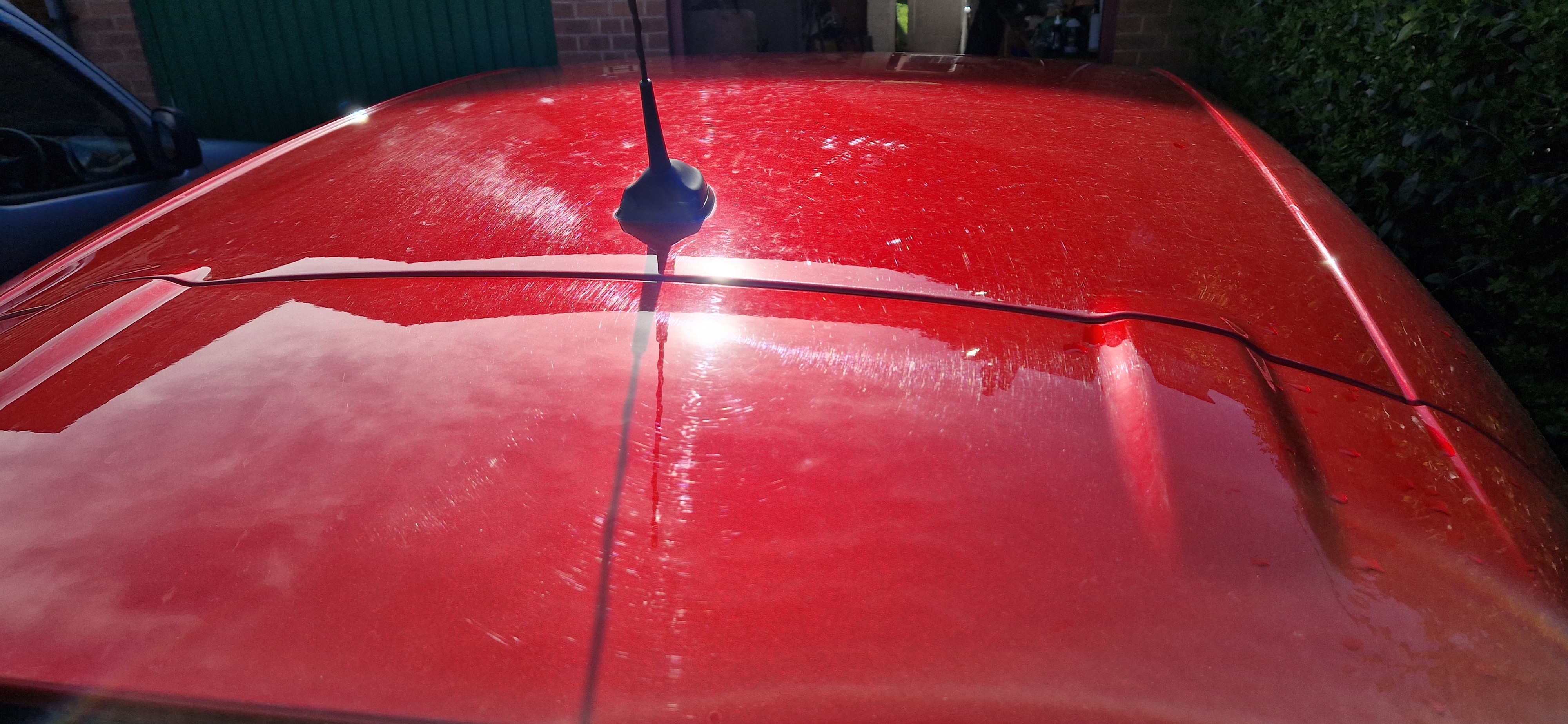

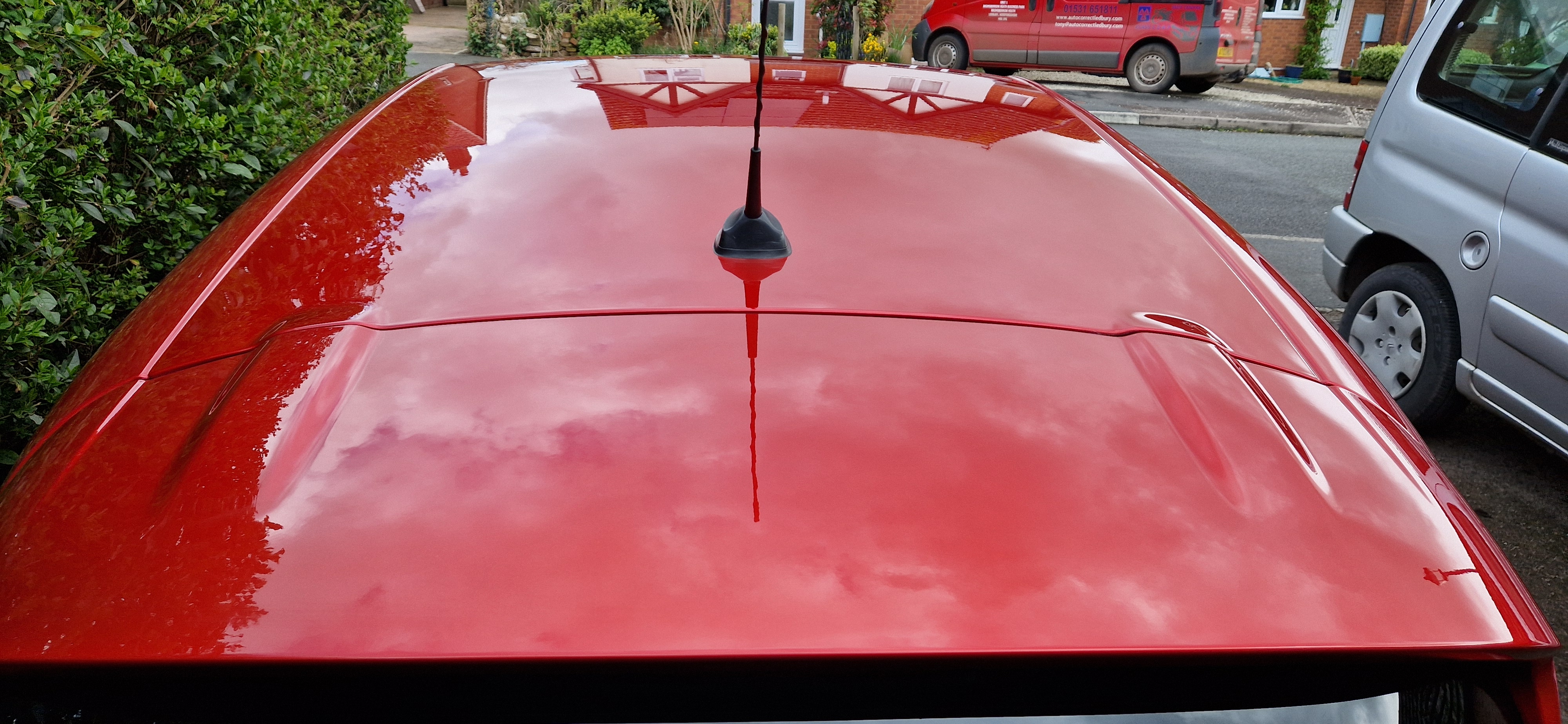

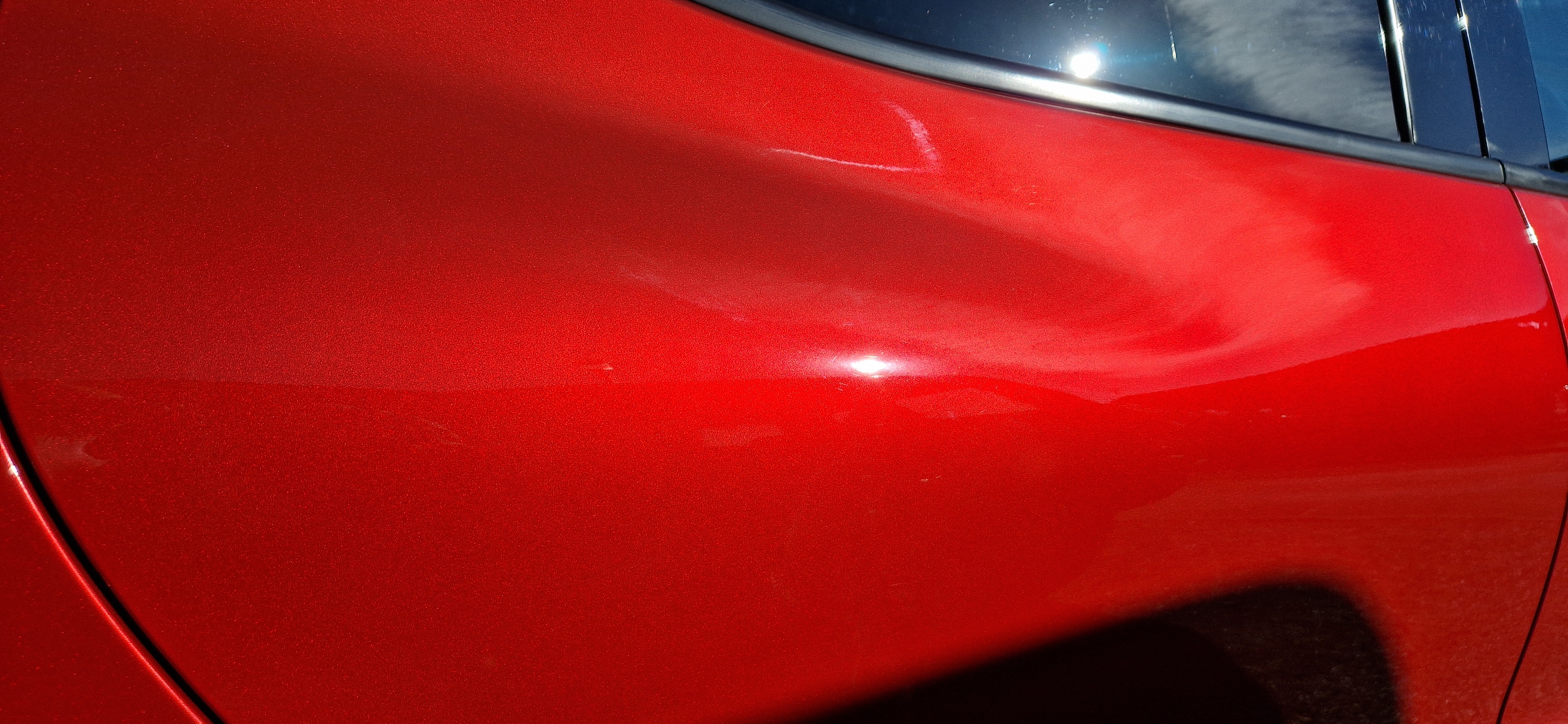

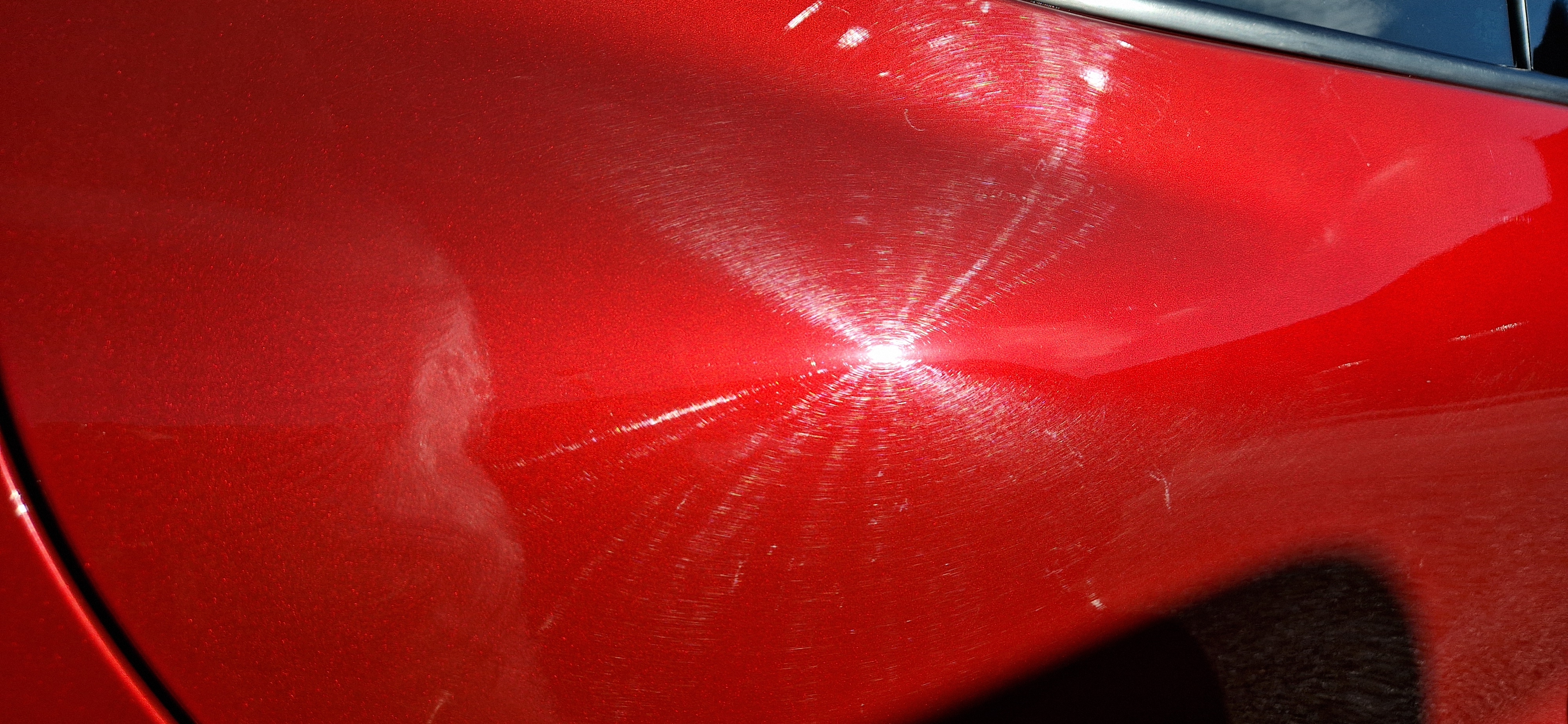

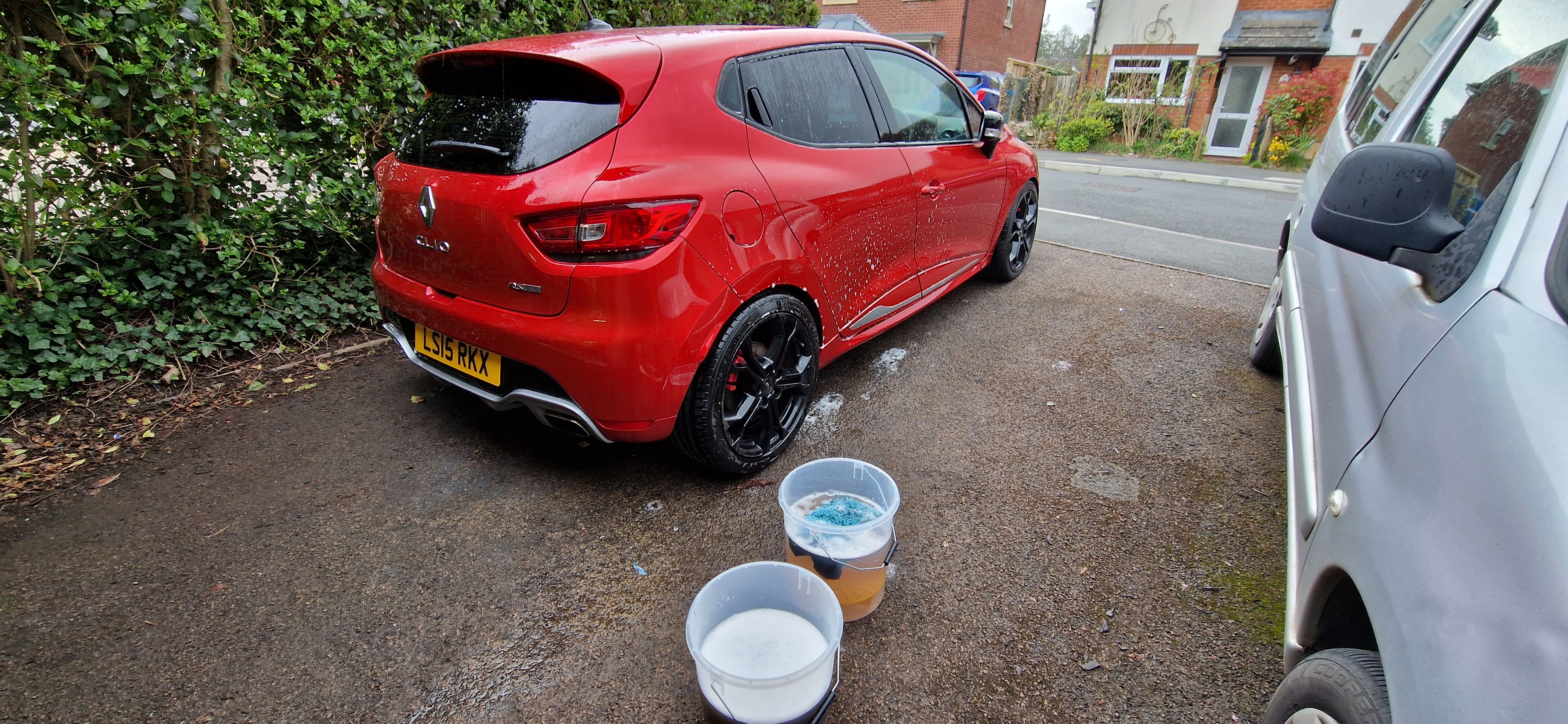

I have really neglected the body work and cleaning side of this car for way too long. I have spent the last 6+ months driving it through the local spiny scrub and blow dry and its really starting to show....
So today I have made a start on correcting it a little, ideally it needs a pro but itll be better than it was. So the usual deep clean stuff going but one side at a time, along with a some clay bar action followed with a light polish to remove some scratches and greatly improve the swirls. I still have the drivers side and roof to machine and then I need to protect the whole car with something (plus do the trims, tires, glass and wheels)
I absolutely hate cleaning cars with a passion, way too much effort for not enough reward but im way to cheap to pay someone to do it.
I'm a little ashamed I let it get this far instead of just cleaning it myself.

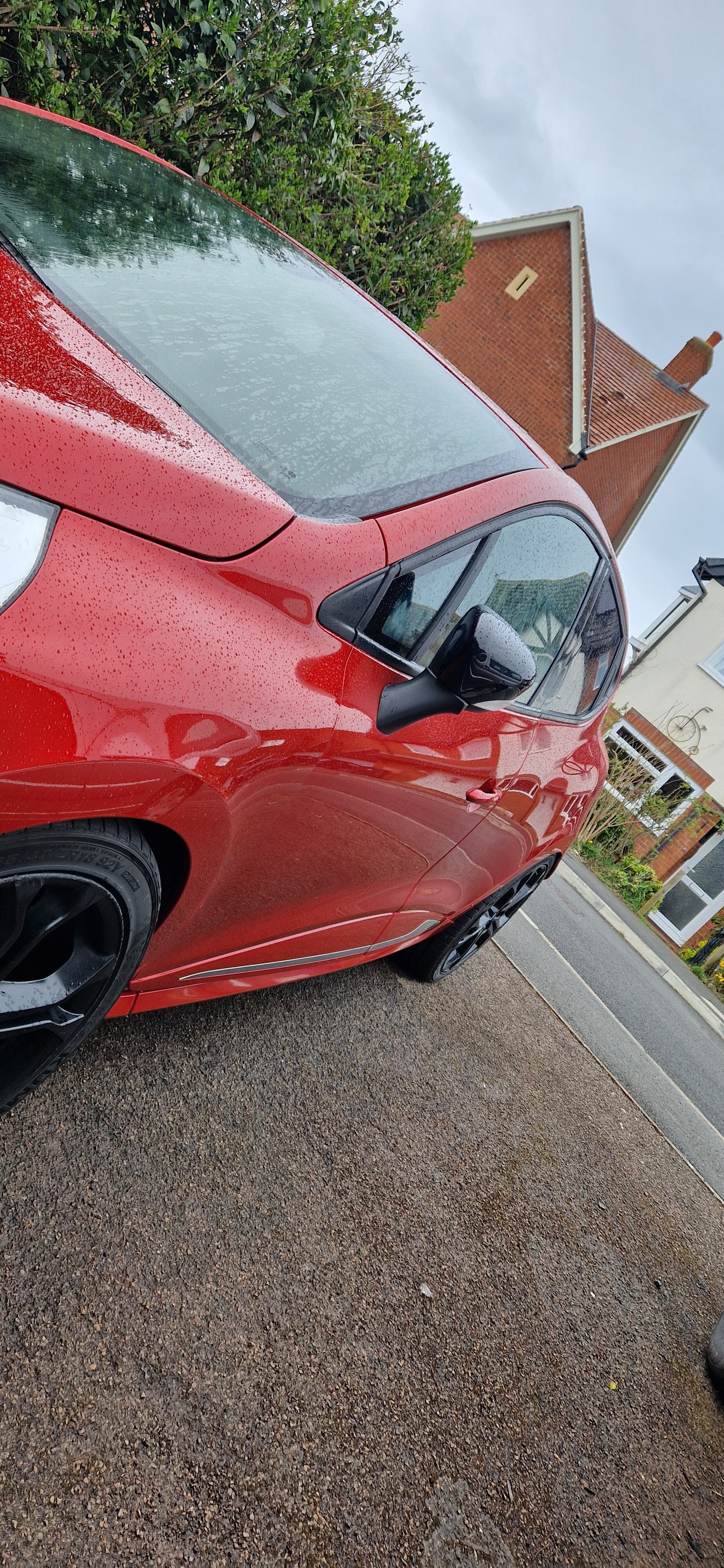

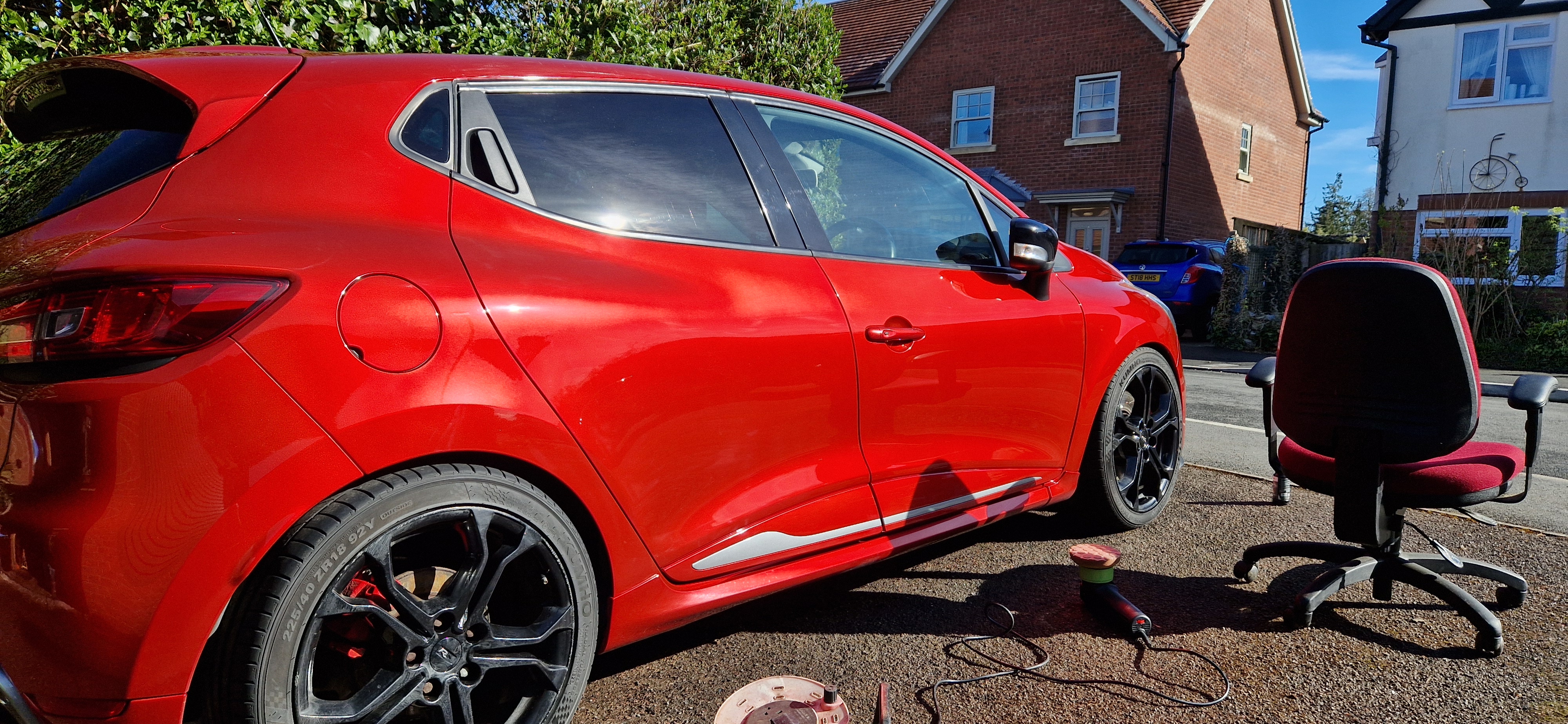

The rest of the car is starting to come up nicely, though the day kept getting postponed due to showers
Adey.

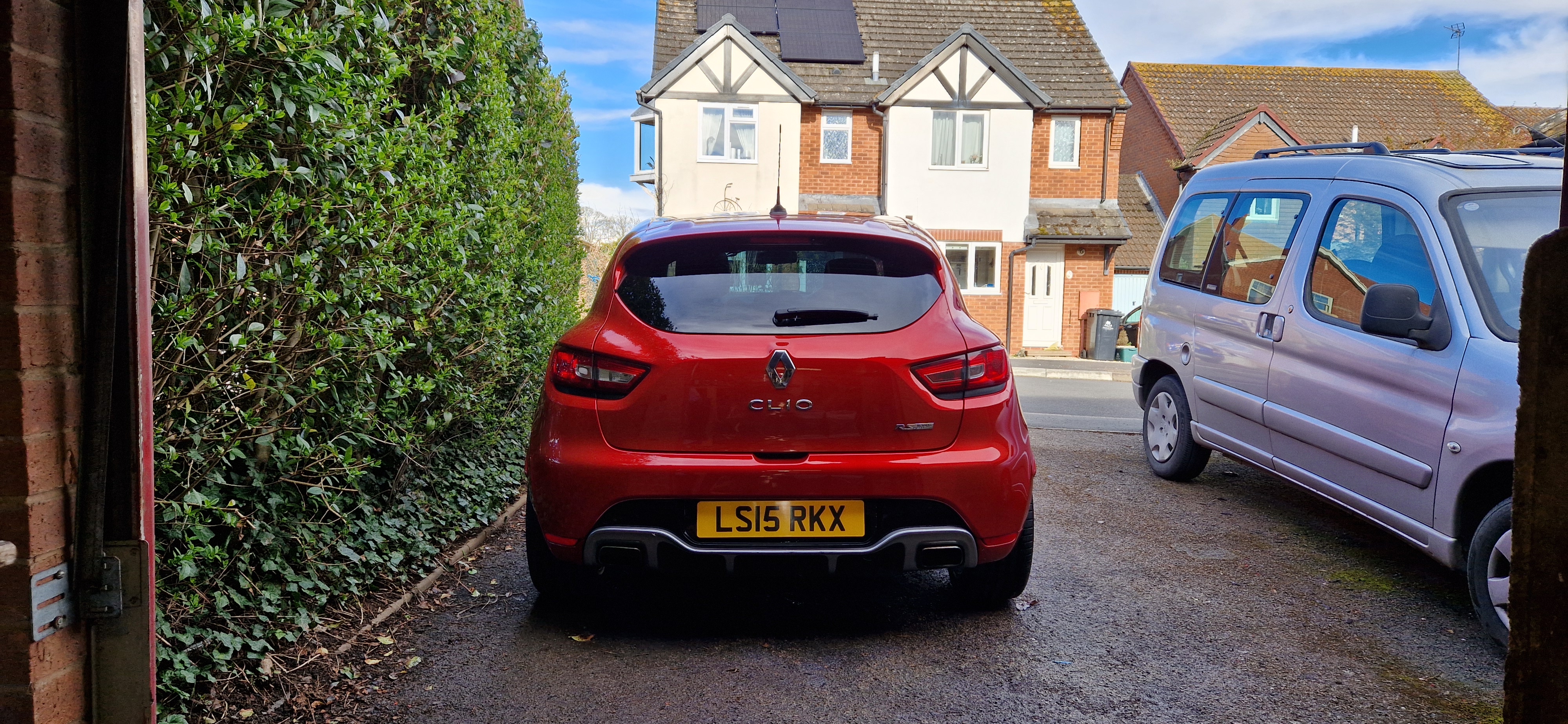

Finished it off today, coated with some wax and from now on ill stick to cleaning it myself. Doesnt look that different from a distance but up close its loads better. That said I now see more imperfections. Could do with a new bonnet in the future and a front spray/refresh. Looks ok for a daily though.
There are no filters on these pics, but you can see how bad it was, no where near pro level but a definite improvement below.
Ill remove and scrub the exhaust trims sometime too.
