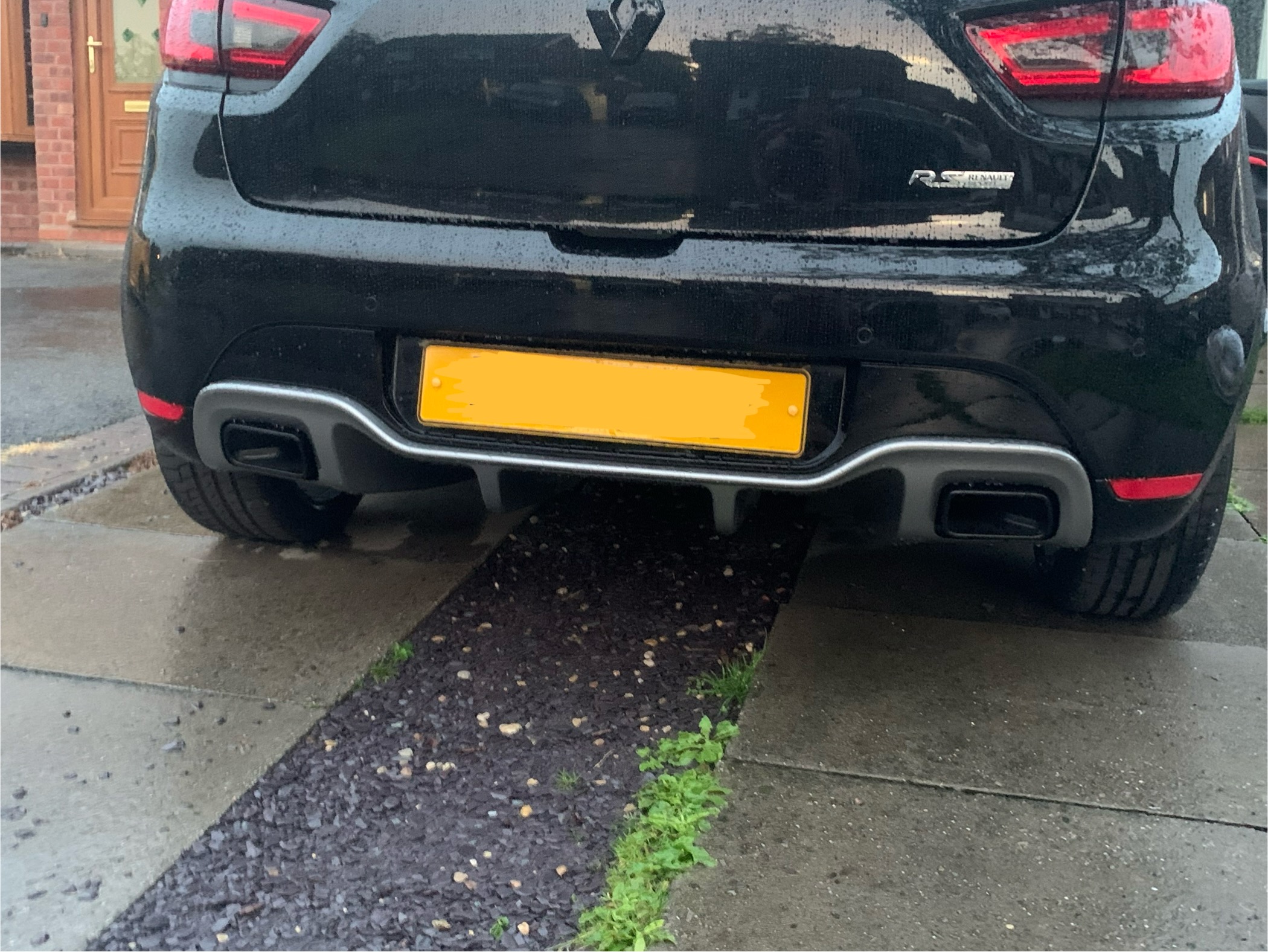

I got sick of cleaning my tips after I had the exhaust modified, so sprayed them black. 🤣

Yeah I thought it looked good and saved cleaning them every 5 mins, especially after the secondary cat was removed.

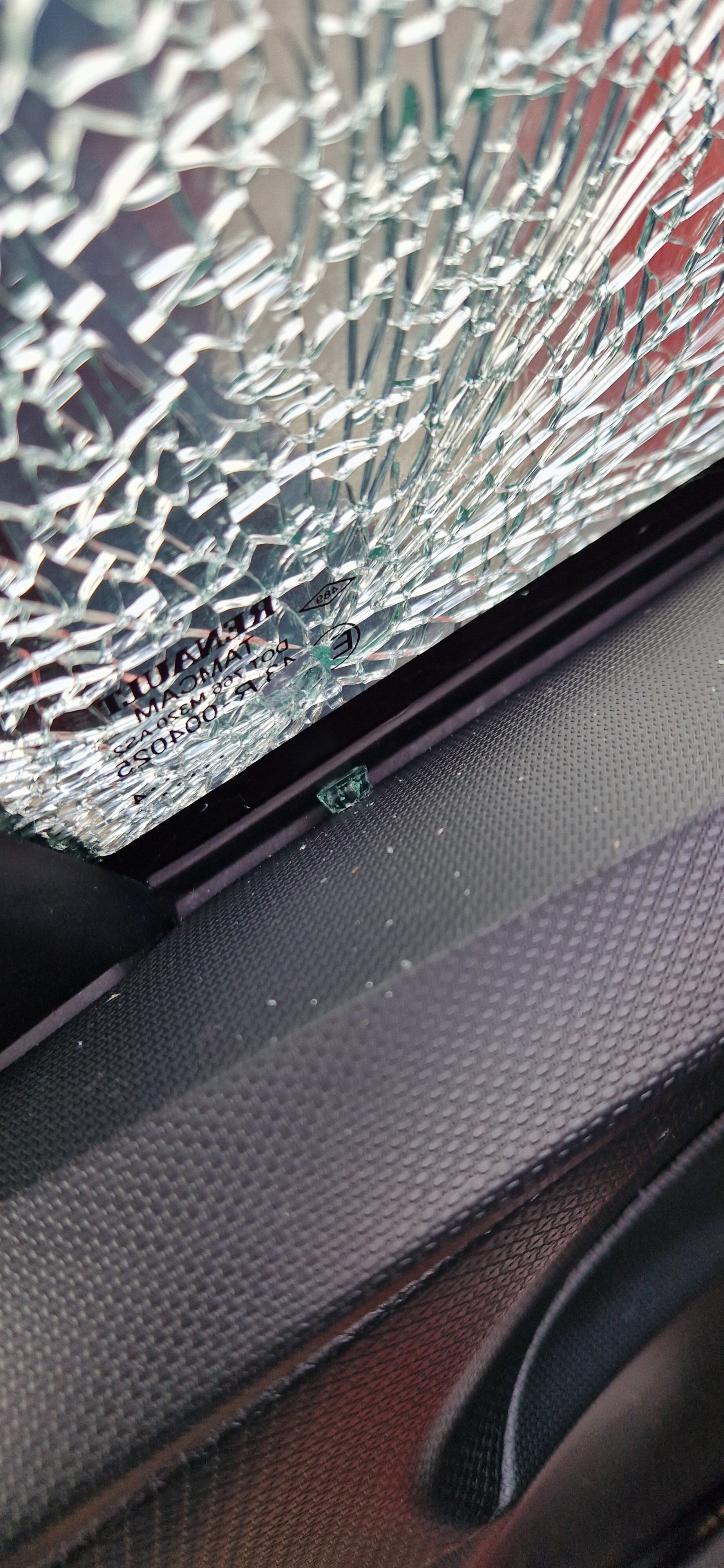

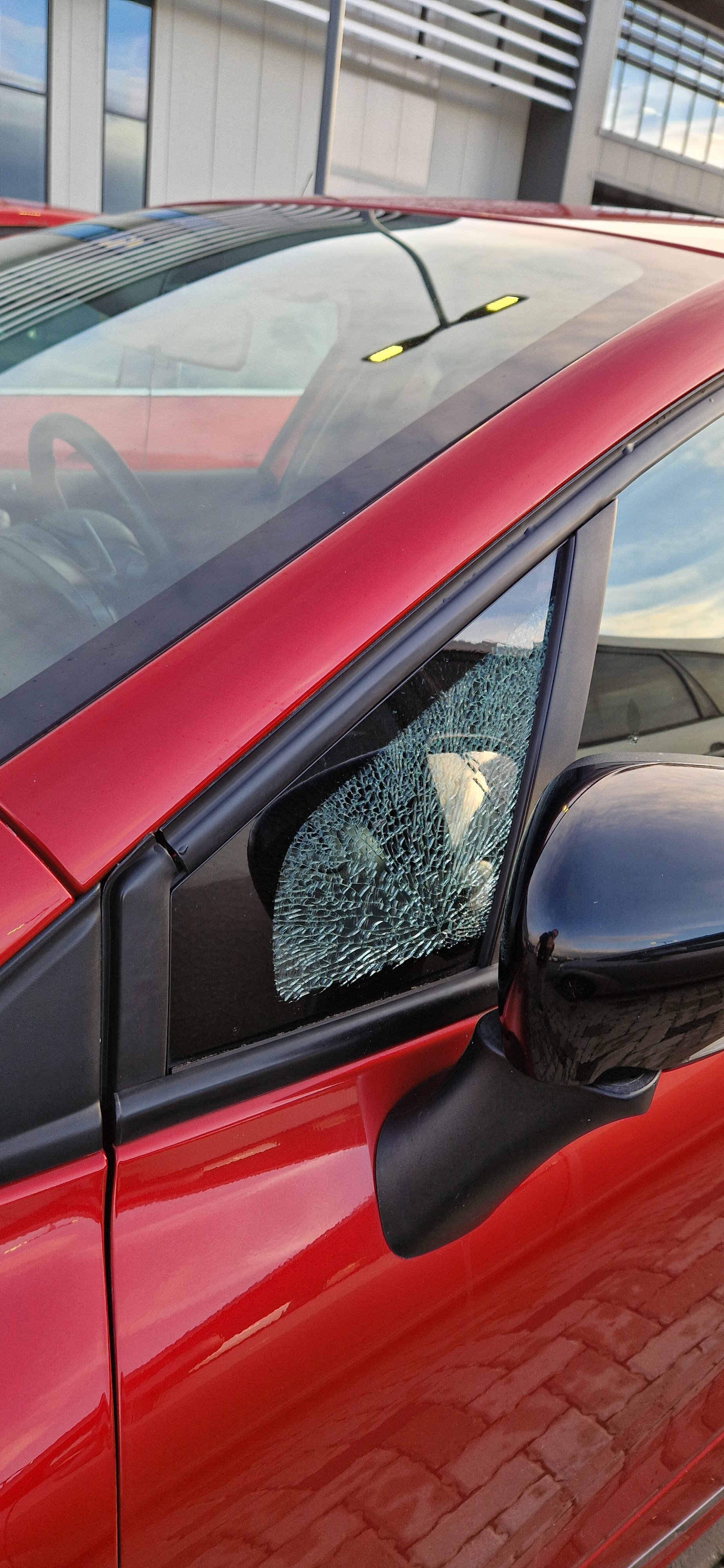

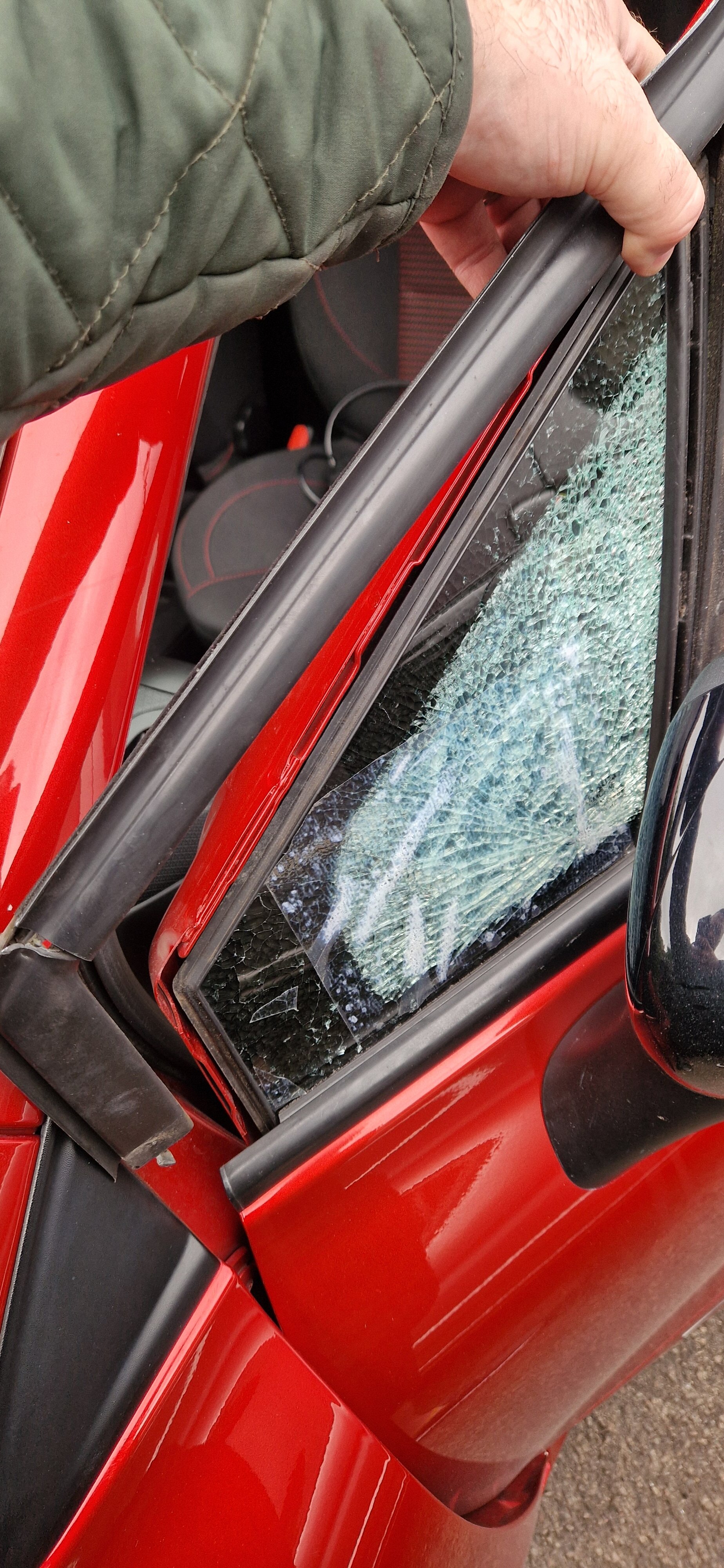

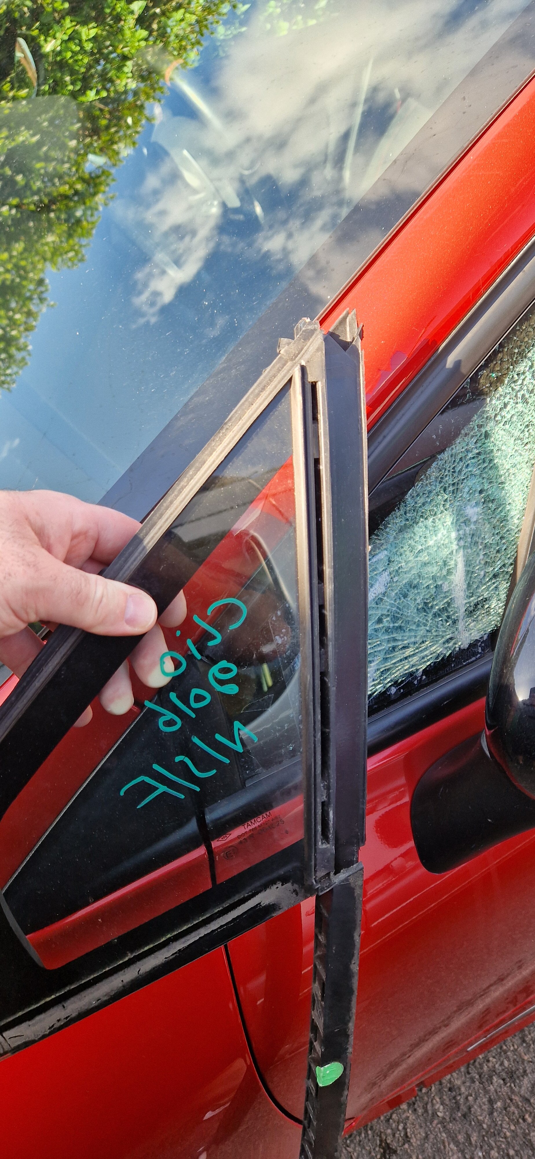

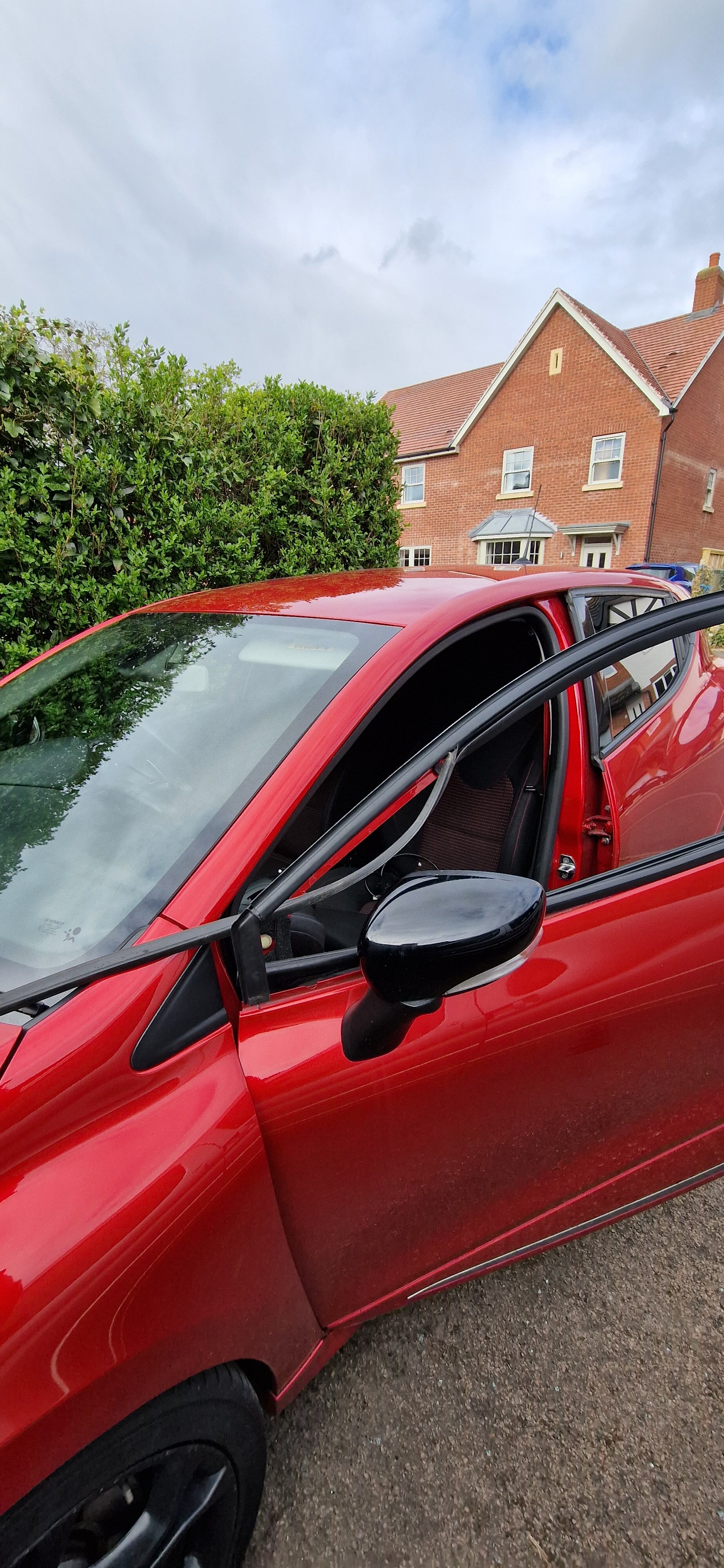

Urgh, I drive to work in the dark so generally don't notice much... whilst at work someone mentioned my window was smashed.....

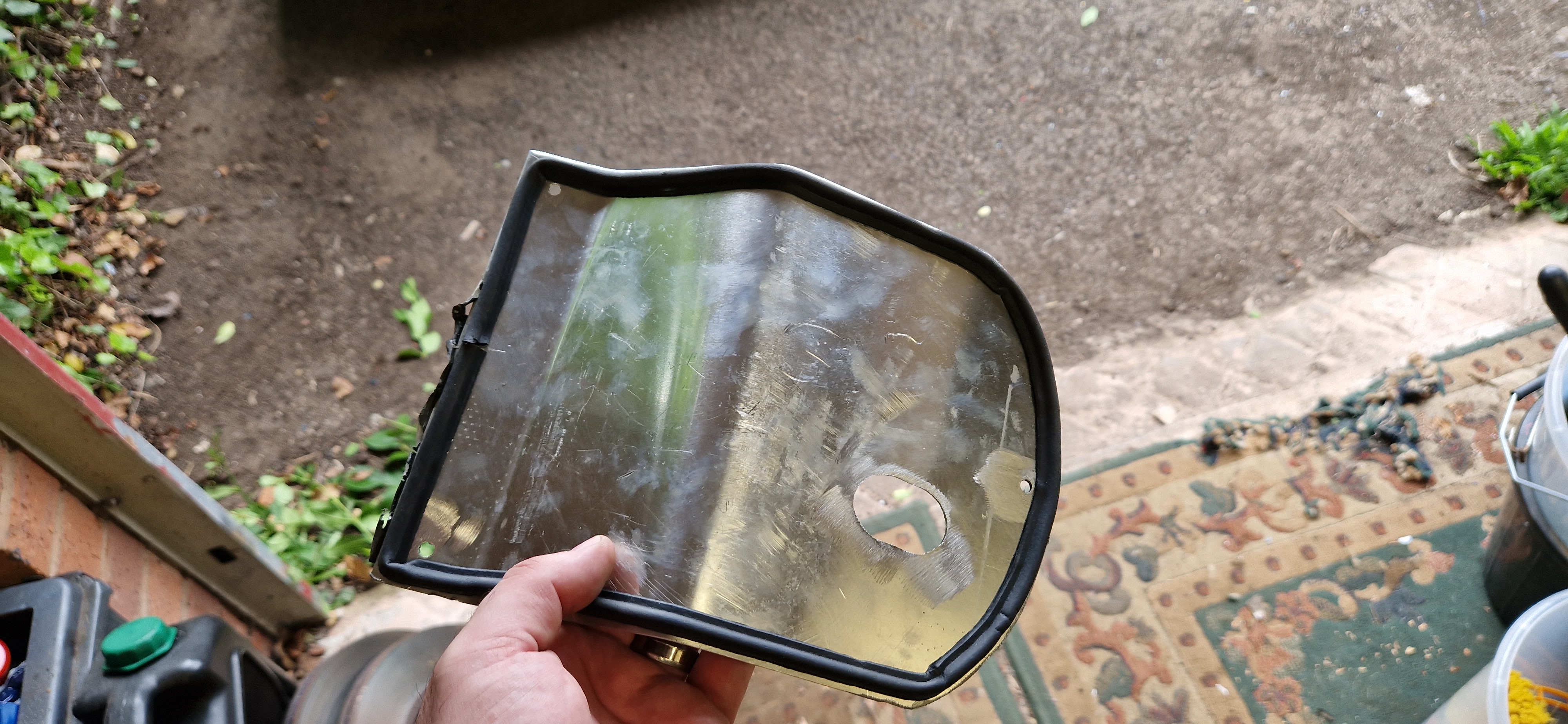

Not sure what's gone on here, a stone maybe 🤷🏻‍♂️ the part looks to bolt in and out on a frame with a seal so I have found one on ebay which should hopefully be here soon. That'll explain the whistling noise on the motorway this morning 🤦🏻‍♂️

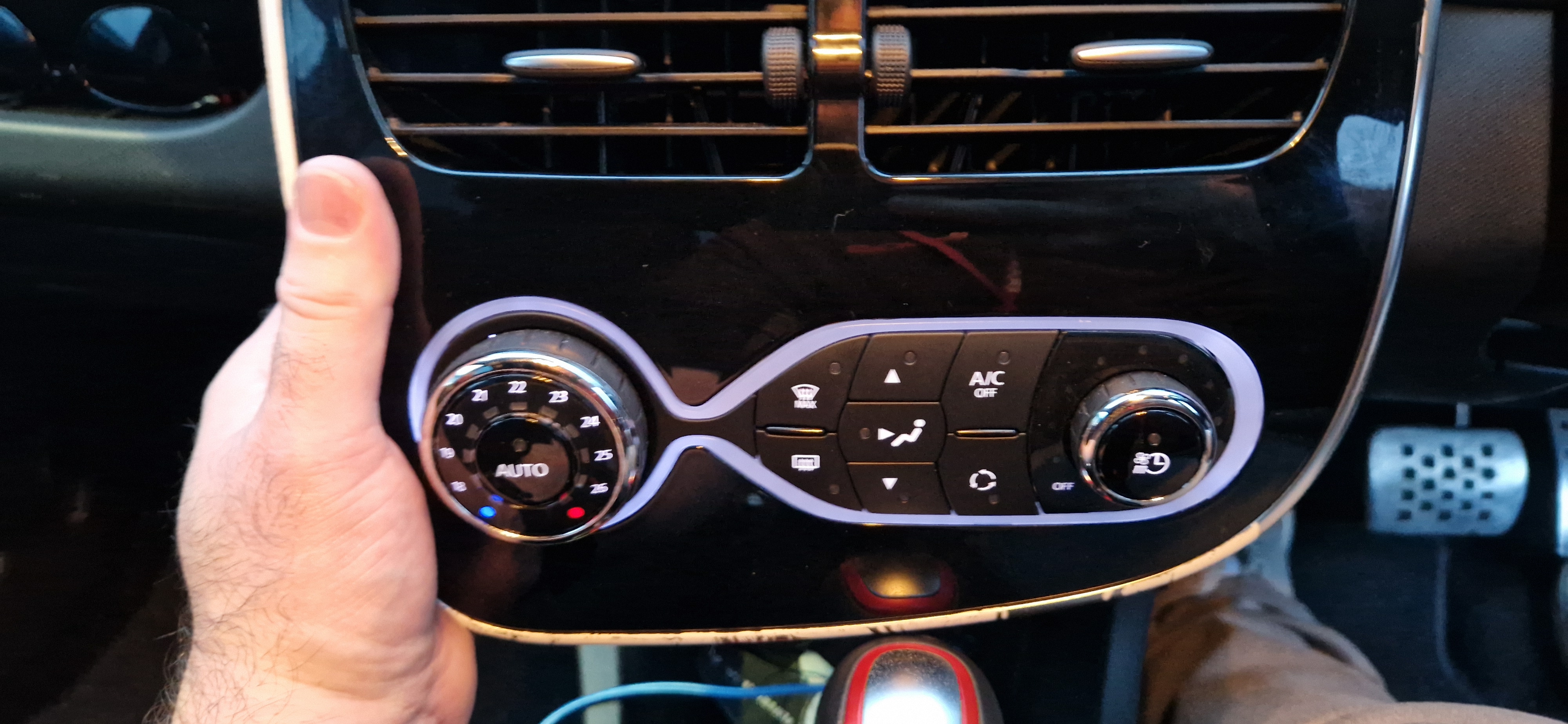

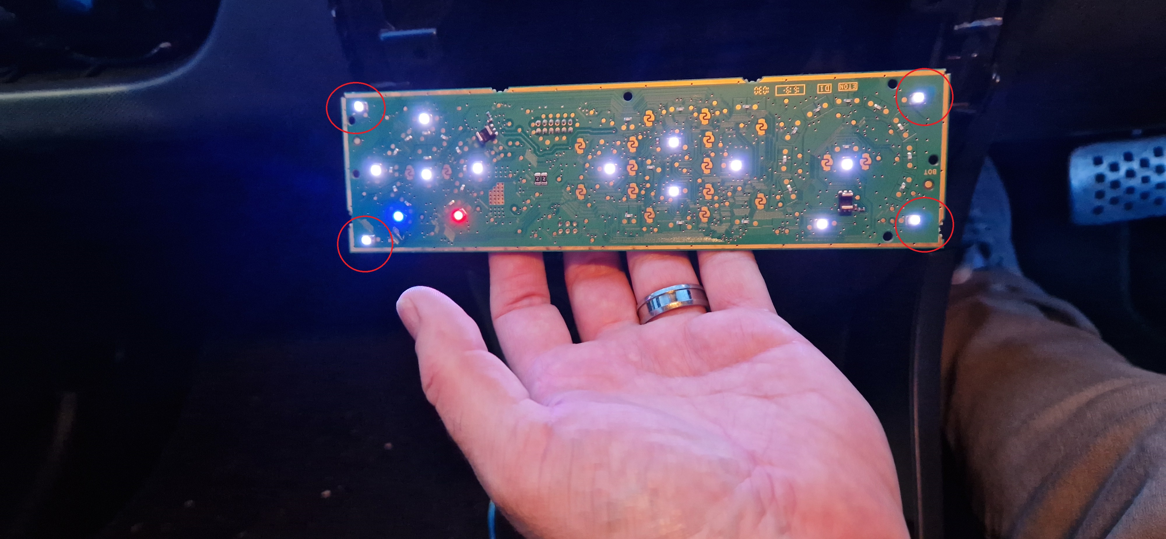

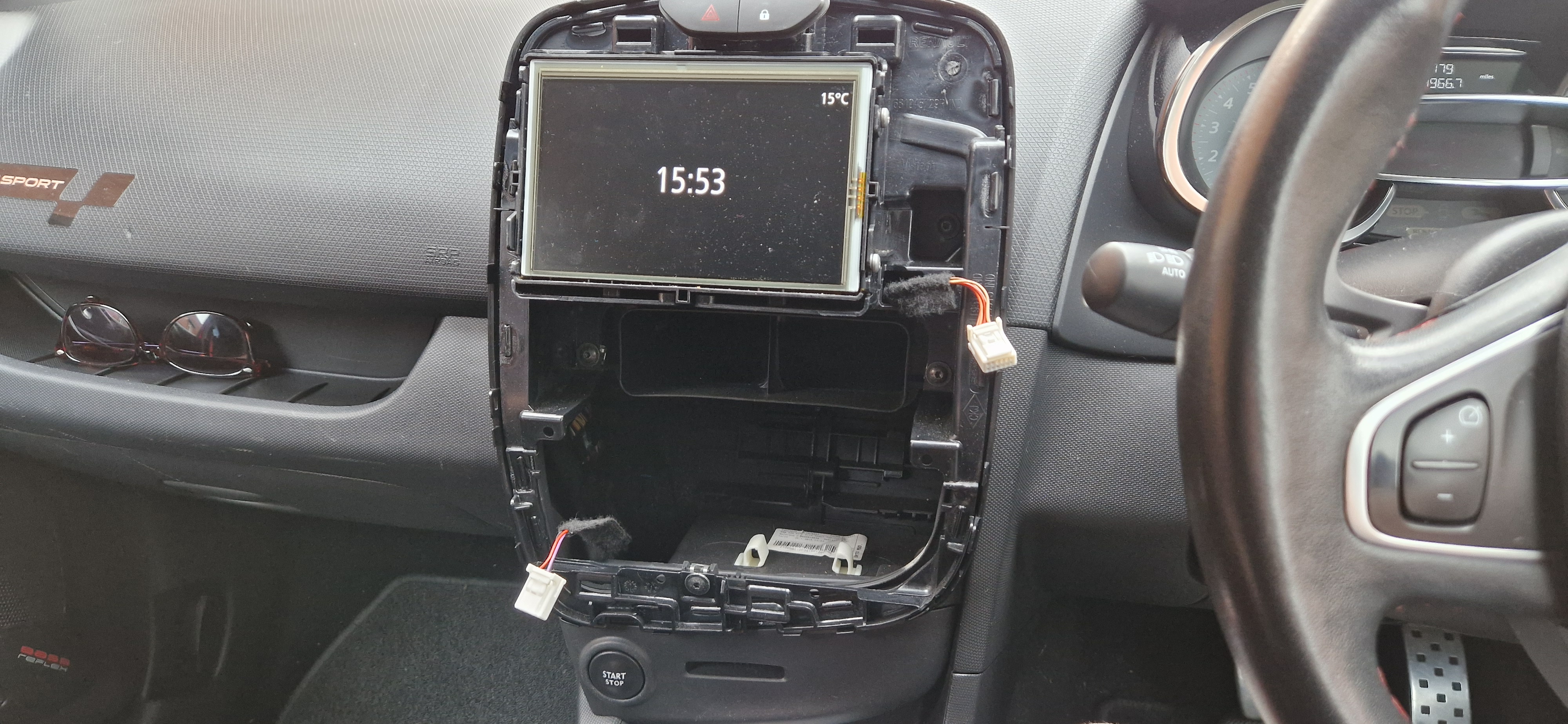

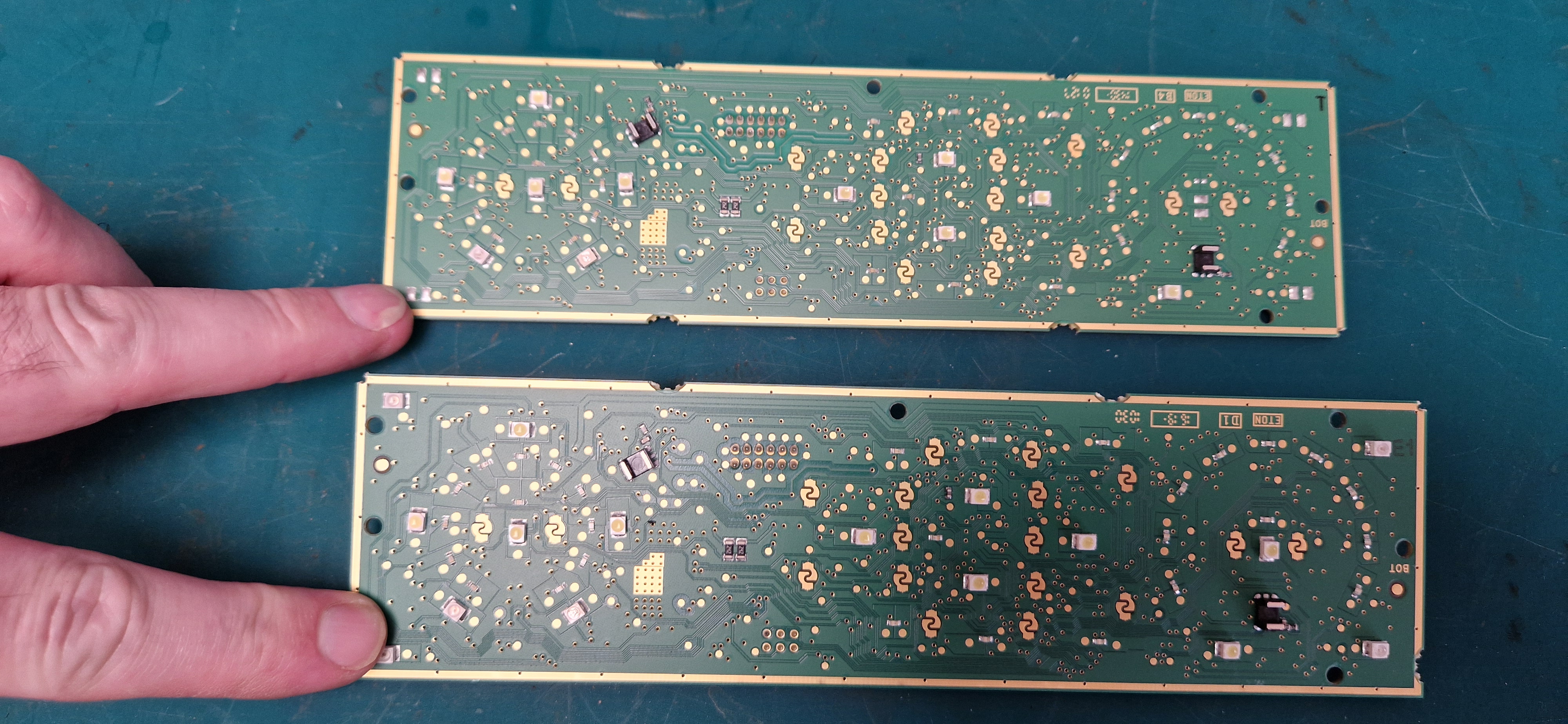

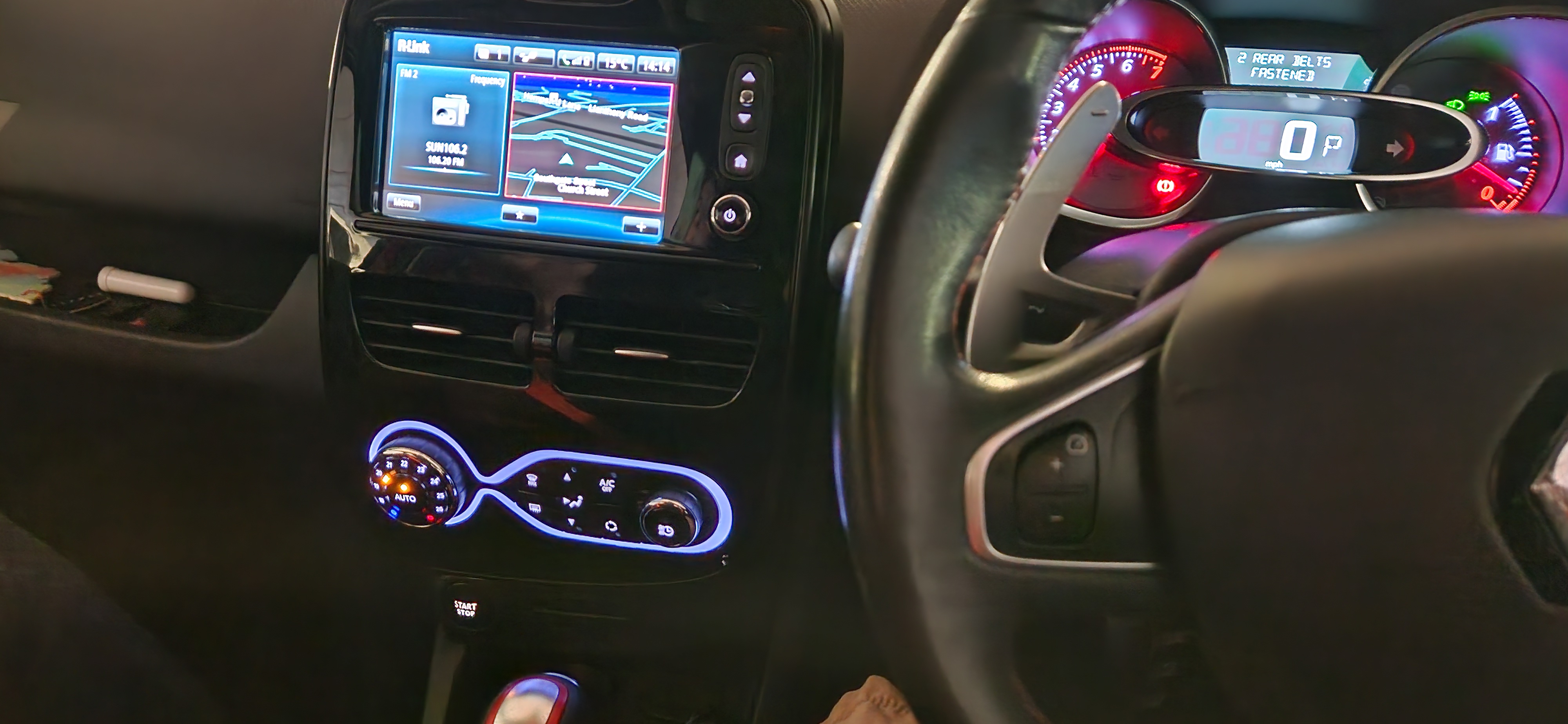

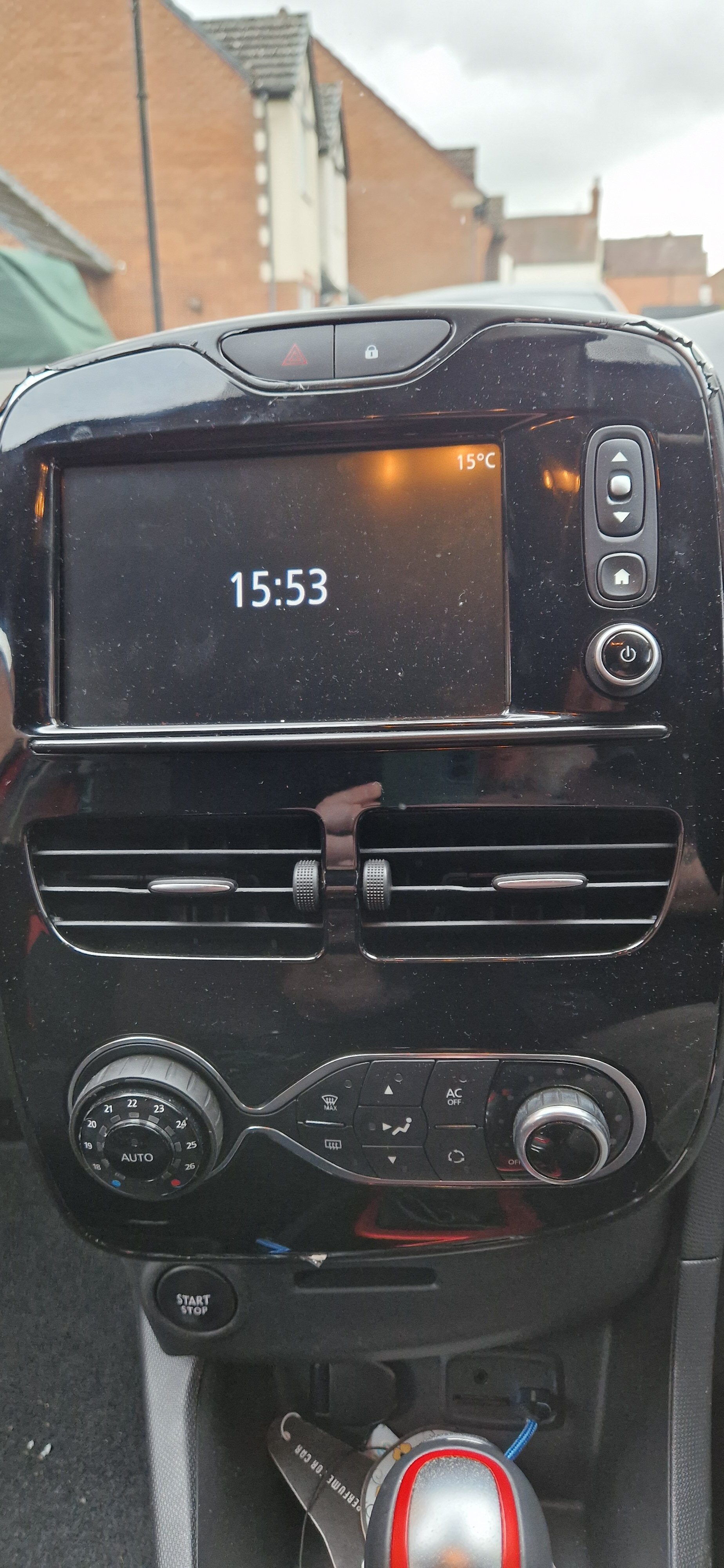

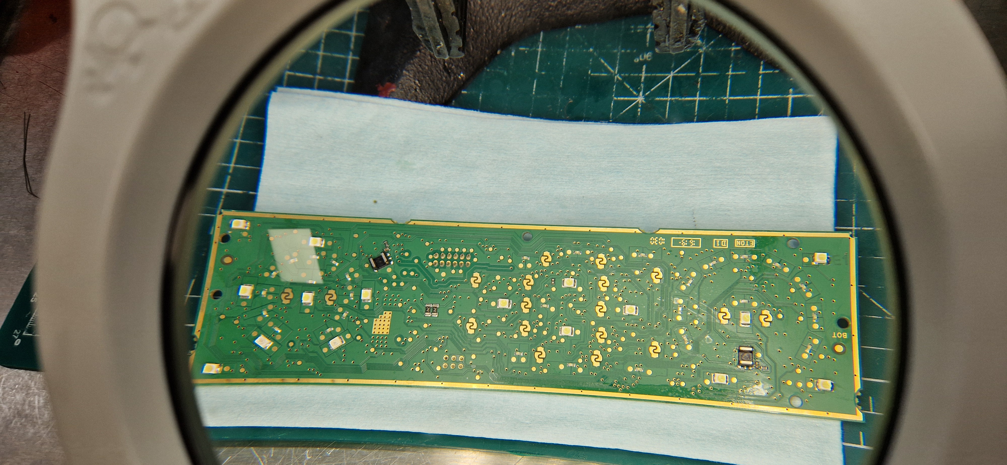

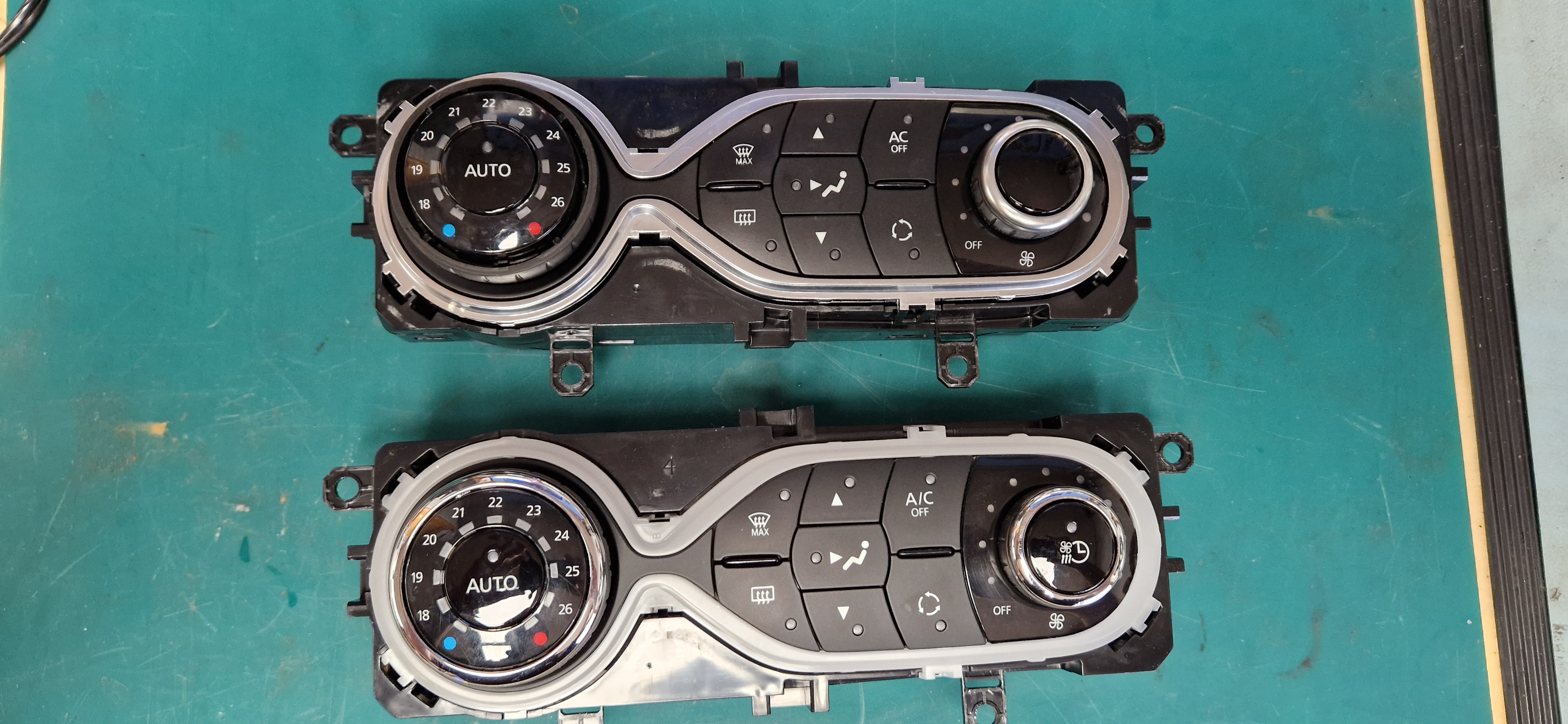

So I have seen this Zoë illuminated heater "upgrade" done @Danith . The Clio has bare plastic around the control, the Zoë is illuminated blue. I've whipped the blue smd/led's off and replaced them with some spare white ones off the old board. Red could be a good choice too though its subtle when lit up. My home setup for soldering wasn't accurate or small enough so I jumped on a workbench this morning at work (much to the amusement of the team) and did it here (showed them I could still use some kit).

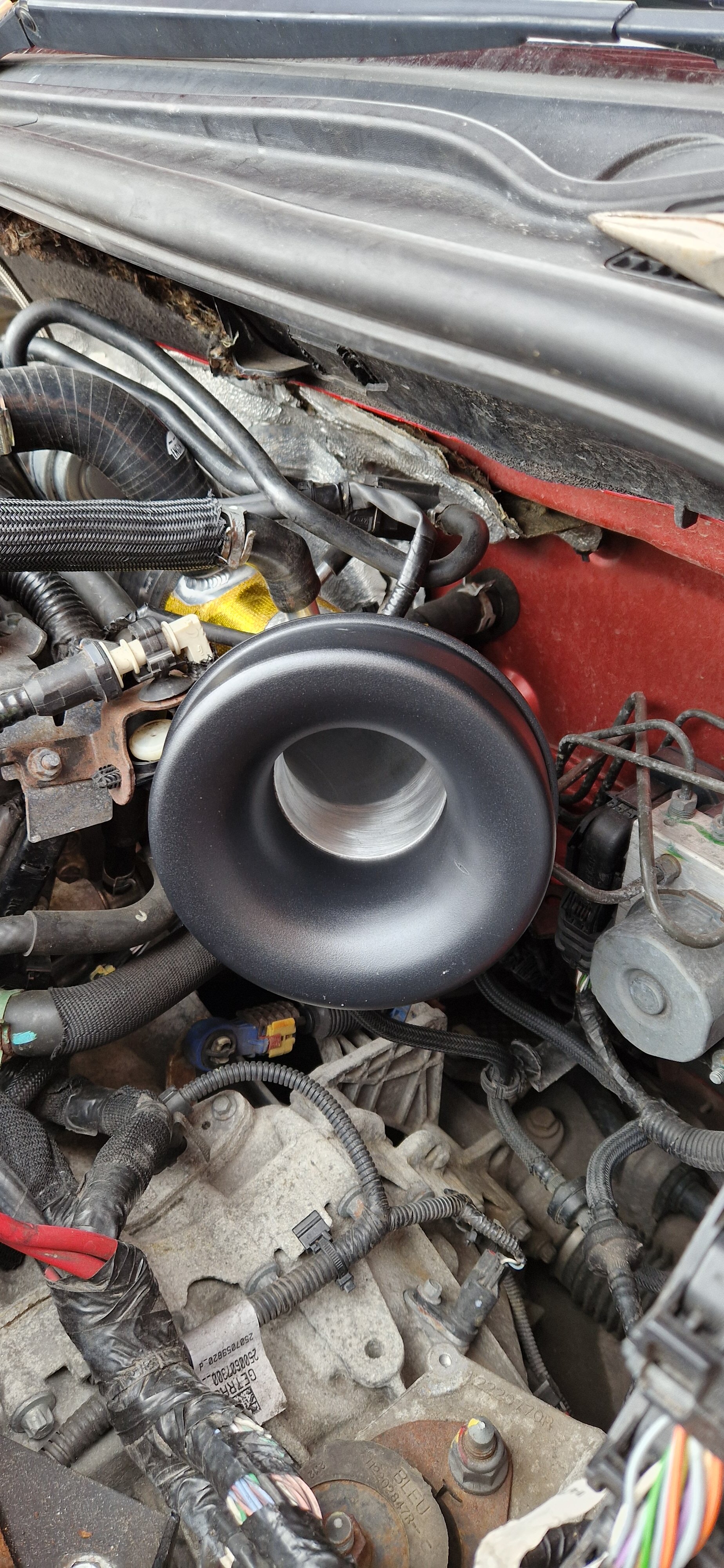

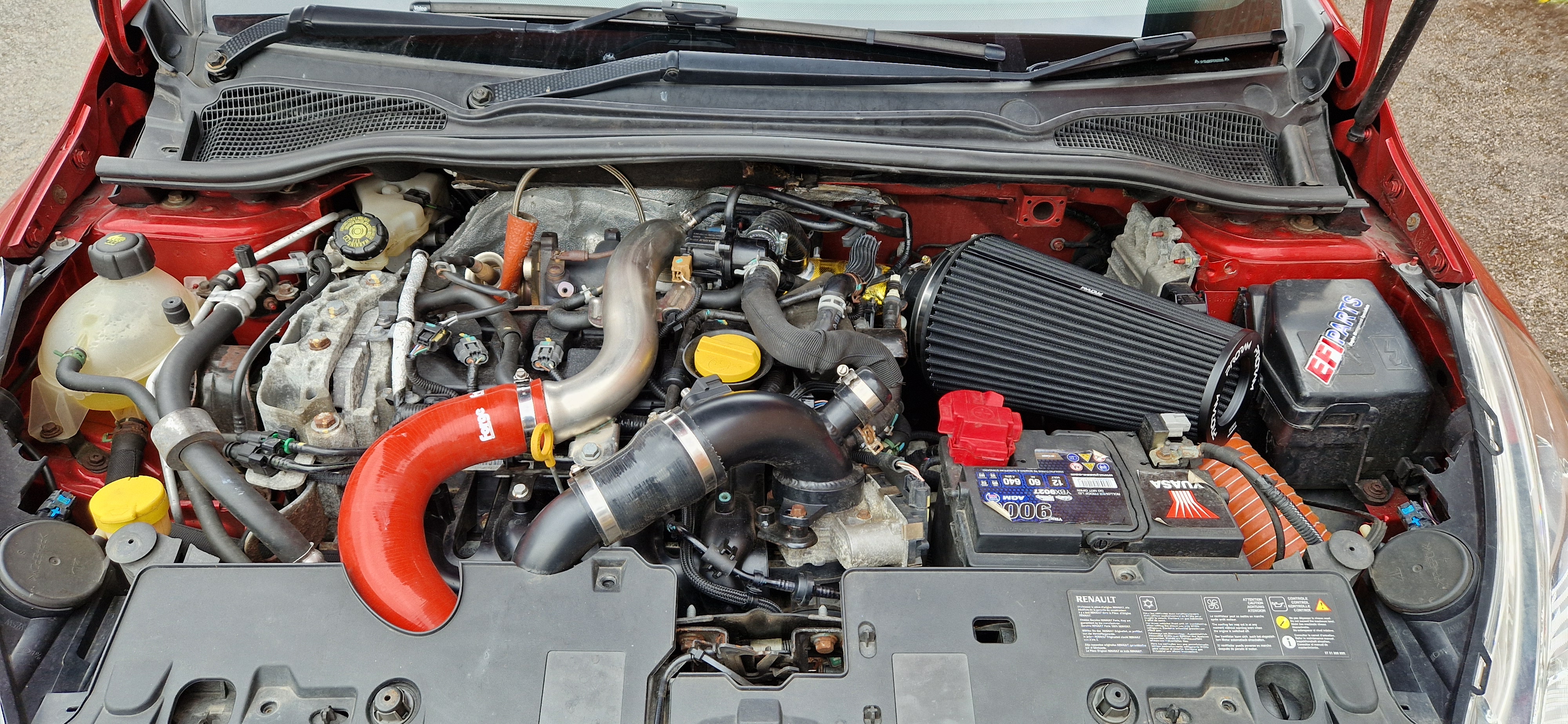

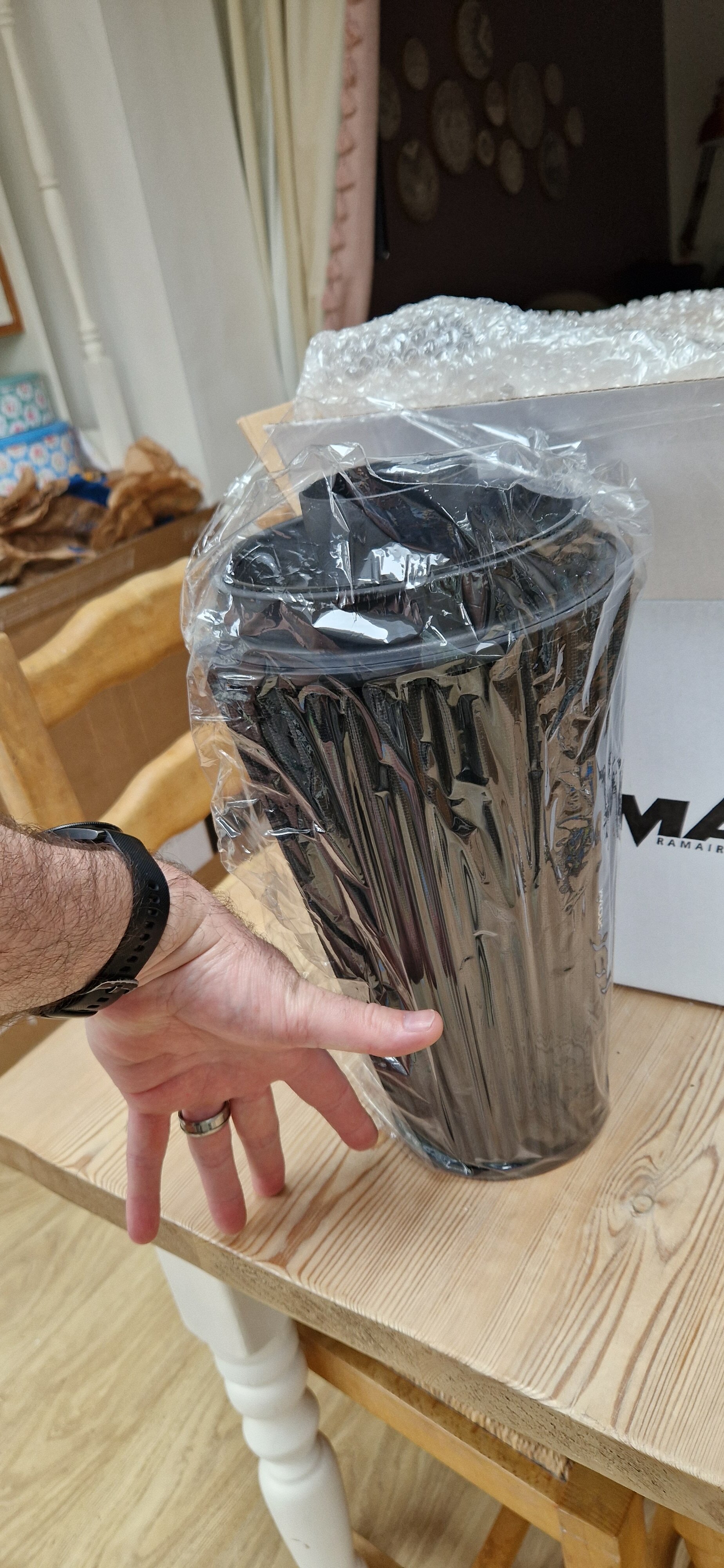

I have been trying the induction setup with the itg housing on and off and haven't really noticed any difference other than an increase in induction/turbo noise which I liked, so I've opted to fit the largest filter I could fit in the space. Fitted with a trumpet intake so may aid flow, I really doubt its made a difference the performance, though I'm yet to test it properly. I have a Juke R turbo outlet pipe to go on at some point too. So say better flowing as its a straighter route for the air to travel, again I doubt it'll have a measurable difference but Ill give it a go soon. Ive also given the turbo a look over and found it still spinning freely with no excessive play, so still going strong

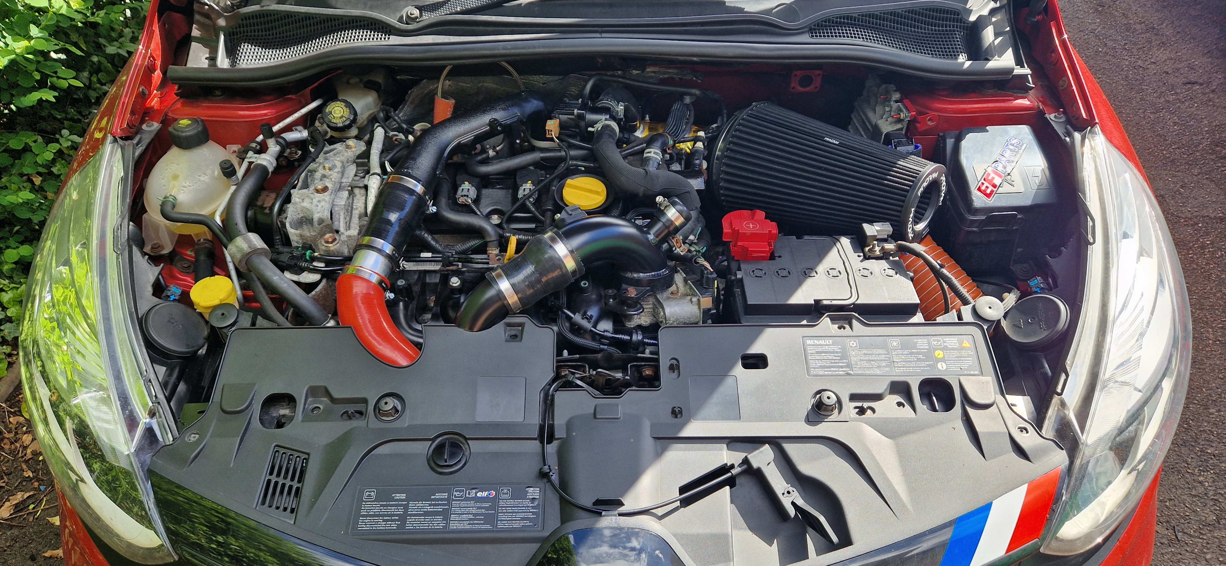

Changed to the so say "better" flowing juke turbo out let pipe. The pipe work routing for for the FMIC is quite convoluted and the whole lot could be improved massively which I may look to do in the future, I think you could take a meter or so out of it pretty easily. That said I know it is the way it is to fit on totally stock Clios, All the FMIC kits follow the same route.

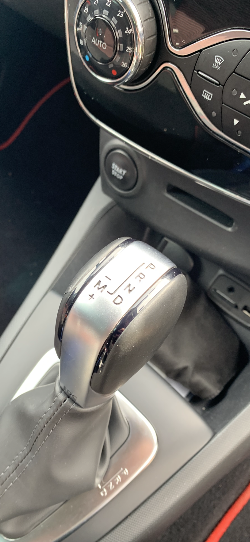

Another thing I did to mine, which I loved and felt much better was a captur/ph2 gear shifter.
At first I did the full captur shifter and edc surround, but then I got a ph2 clio shifter without the letters on the top and a manual clio gaiter and surround, stitched red cotton across the stitching to match the interior and fitted that.

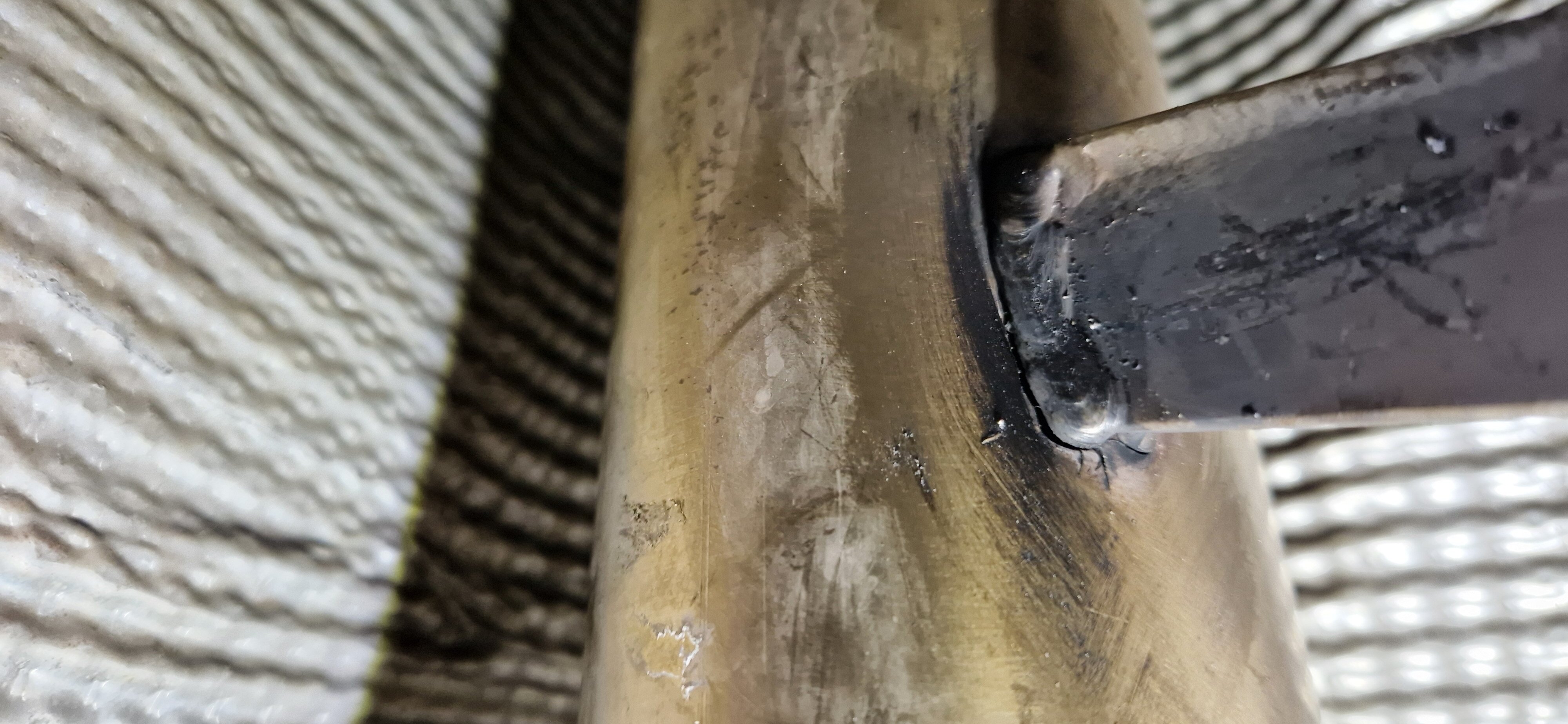

Whilst there I found that the hanging bracket has fractured, annoying as its hasn't covered many miles and is 6 months old. I have fired an email off to Ktec but tbh I know how it'll go and ill end up removing it to weld it back up.

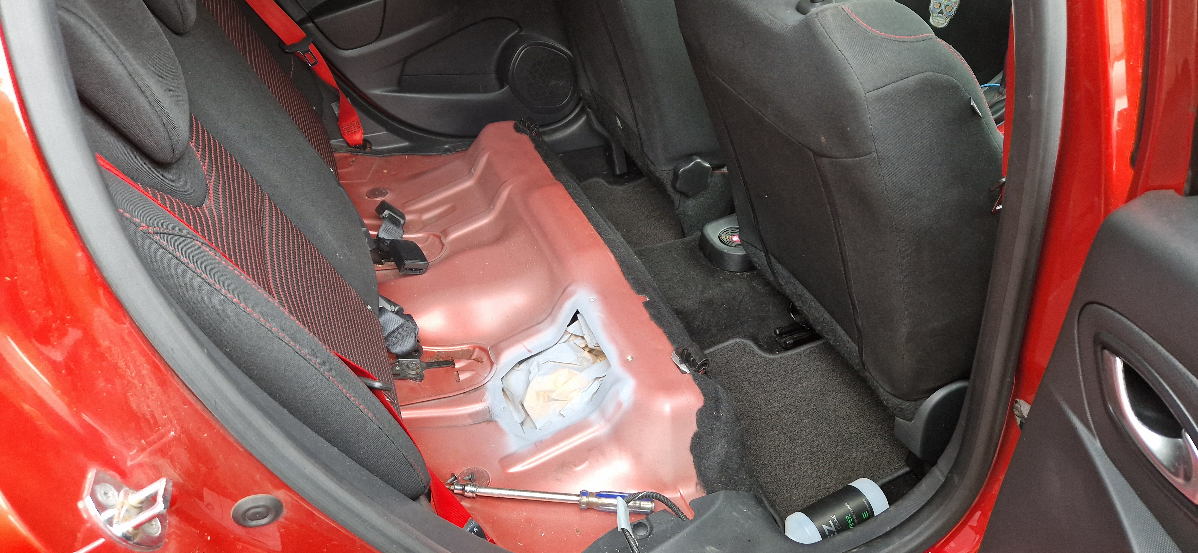

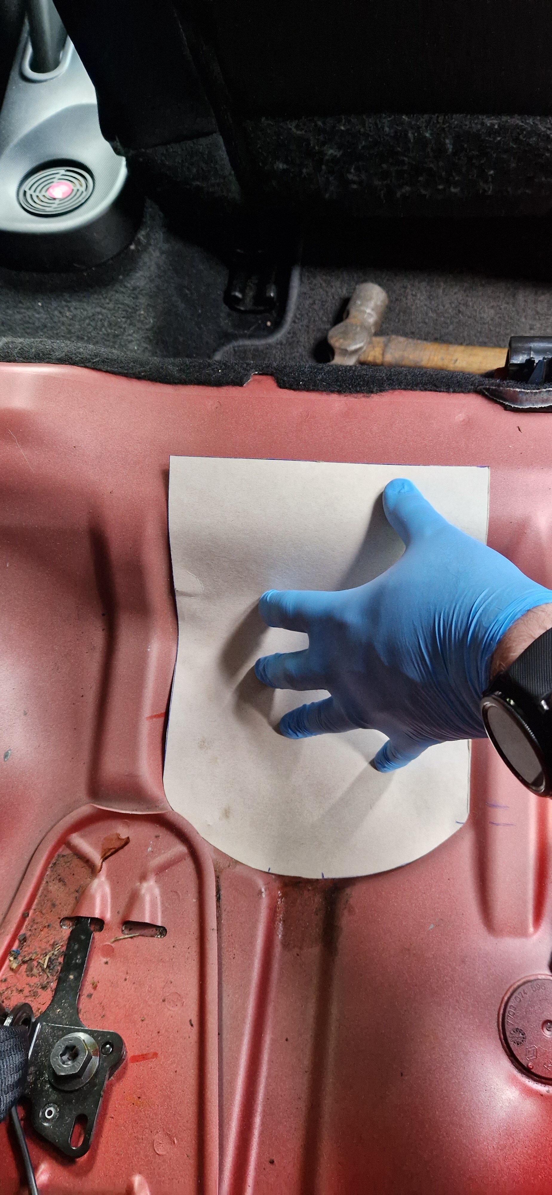

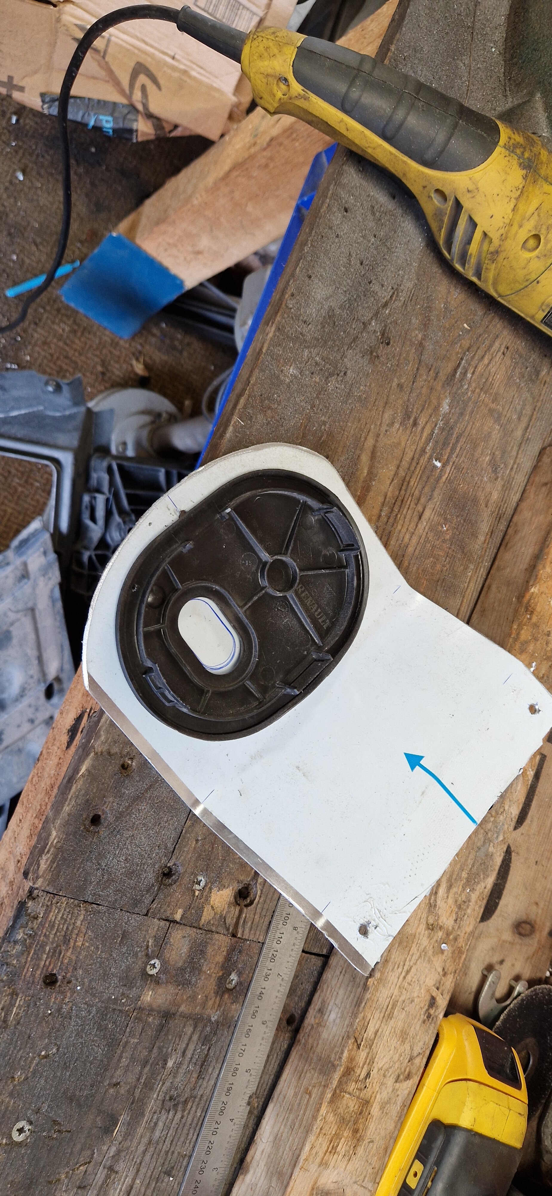

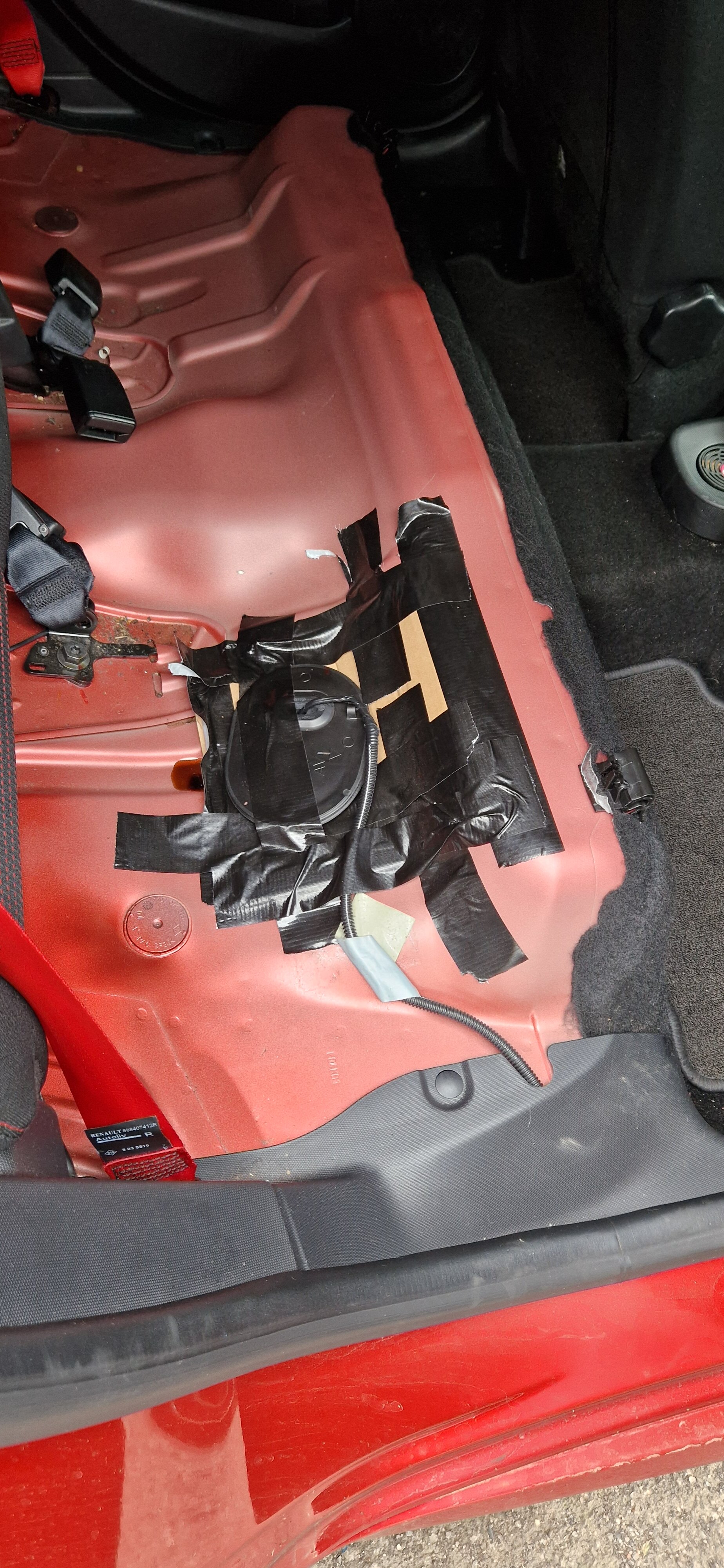

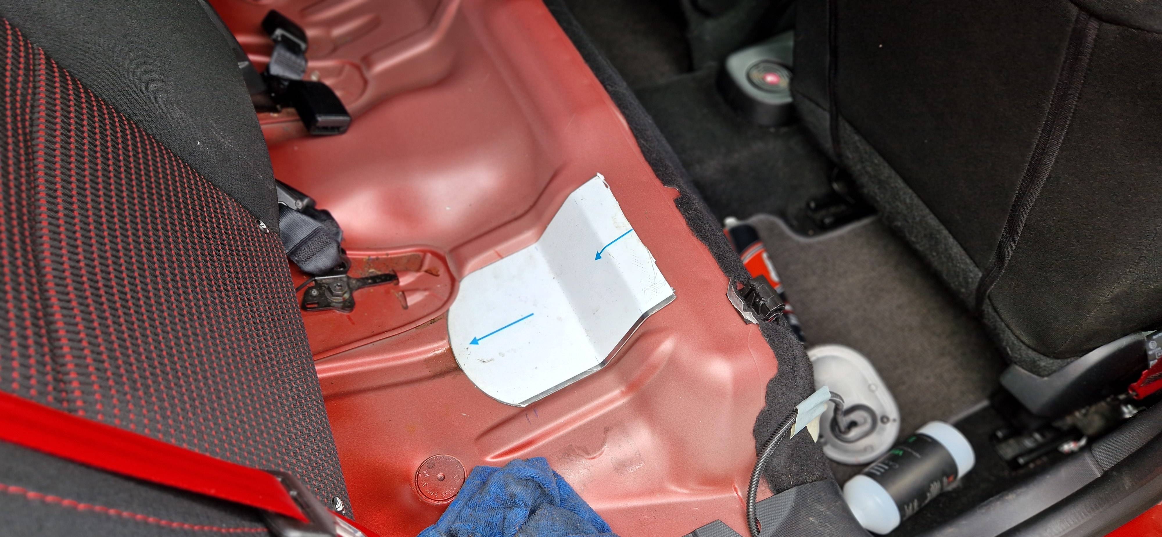

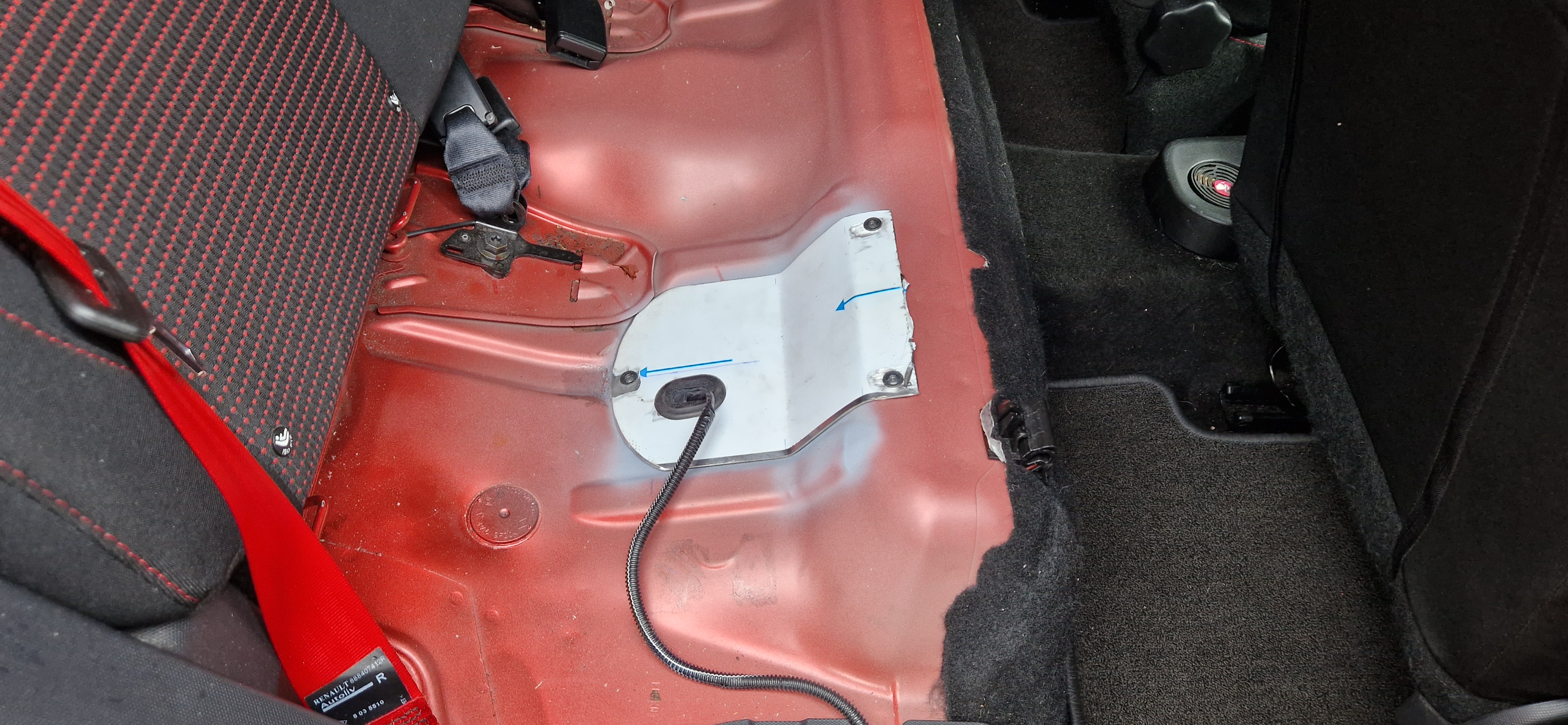

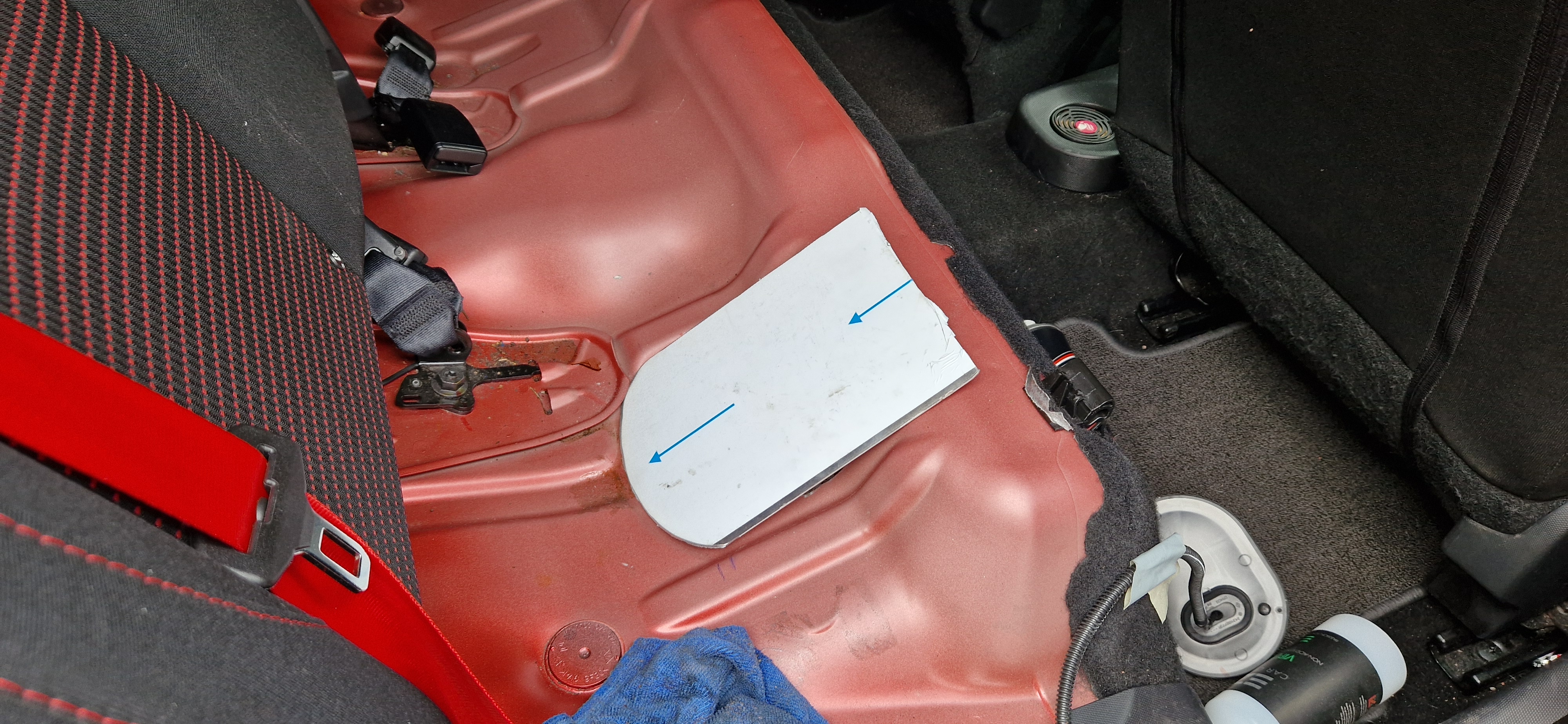

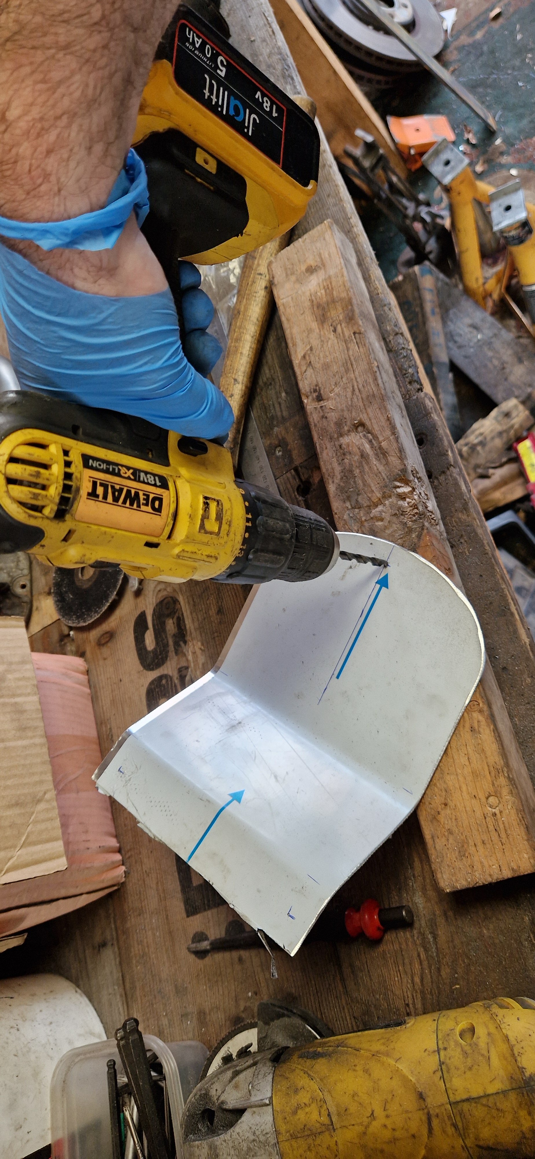

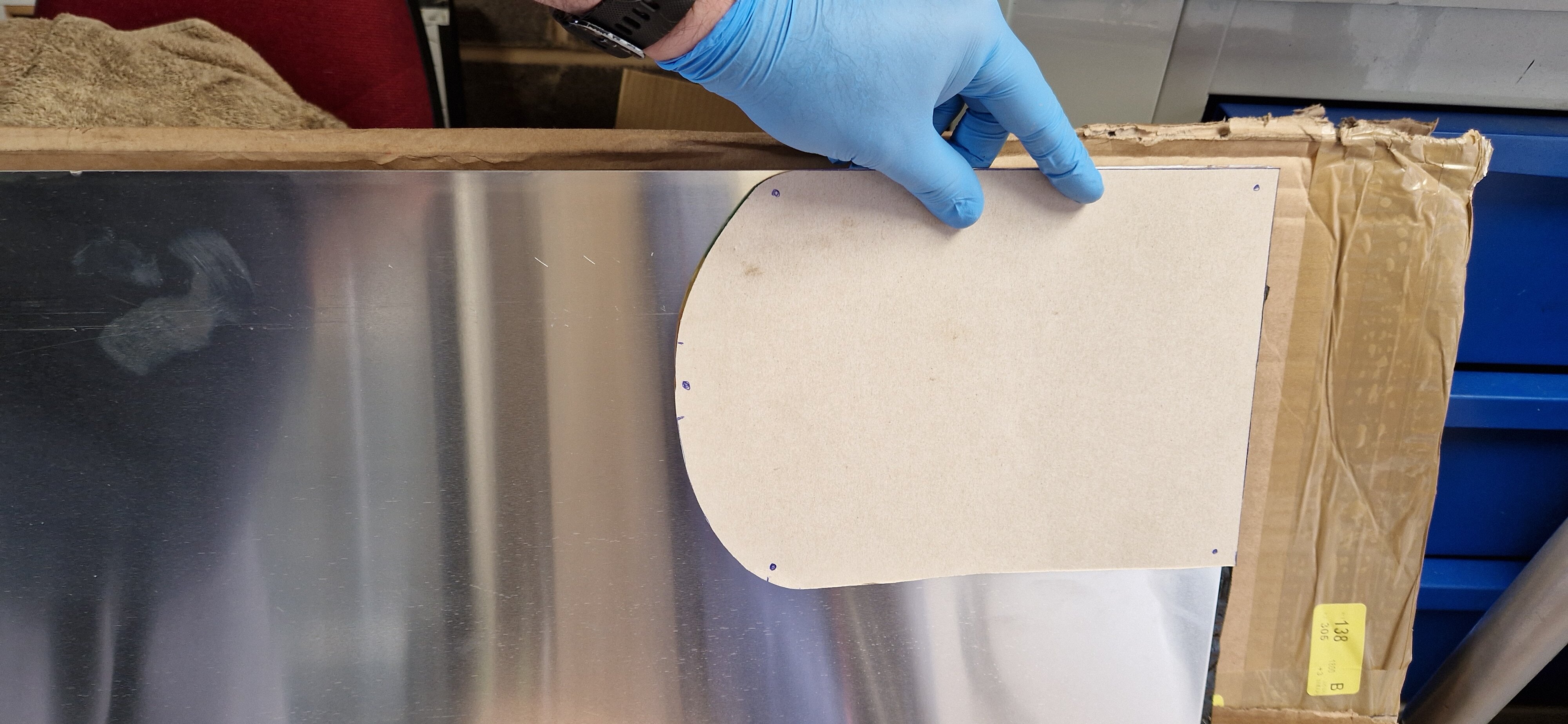

So I've been meaning to tackle this little job for a while now. When you "gain" access to fit a fuel pump on these Mk4's you are left with a bit of a hole. The Renaultsport way is to hack some metal out and cover it with a panel, a panel I didn't have. Mine was covered up with cardboard and gaffa tape, out of sight and mind..... well I had a few hours spare today so decided to tackle it and make a removable panel to cover the hole.
Started off with some high tech CAD to get the shape I needed and transferred this to some 1.5mm aluminium.
I then bent the sheet to match the shape of the cars floor. Marked through and added some rivnuts. Popped a hole through to allow the wiring to reach the pump. Gave the edges of the chassis a little dress up and hit with some primer to add protection. Found some draft excluder and added that to the panel and bish bash bosh i have a removable fuel pump cover that is a load better than what was originally there..
I think there is a panel available from Renultsport still but I had the material and bits around to make this with no outlay. Thanks for reading (y)

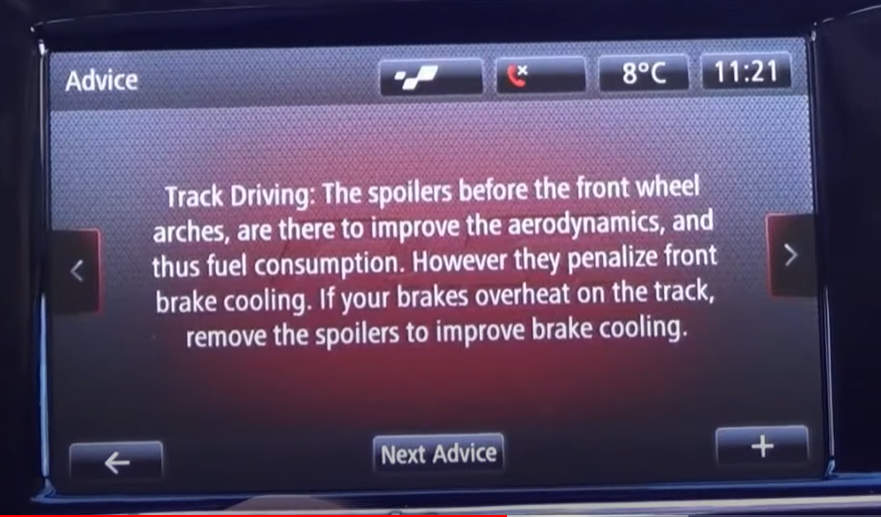

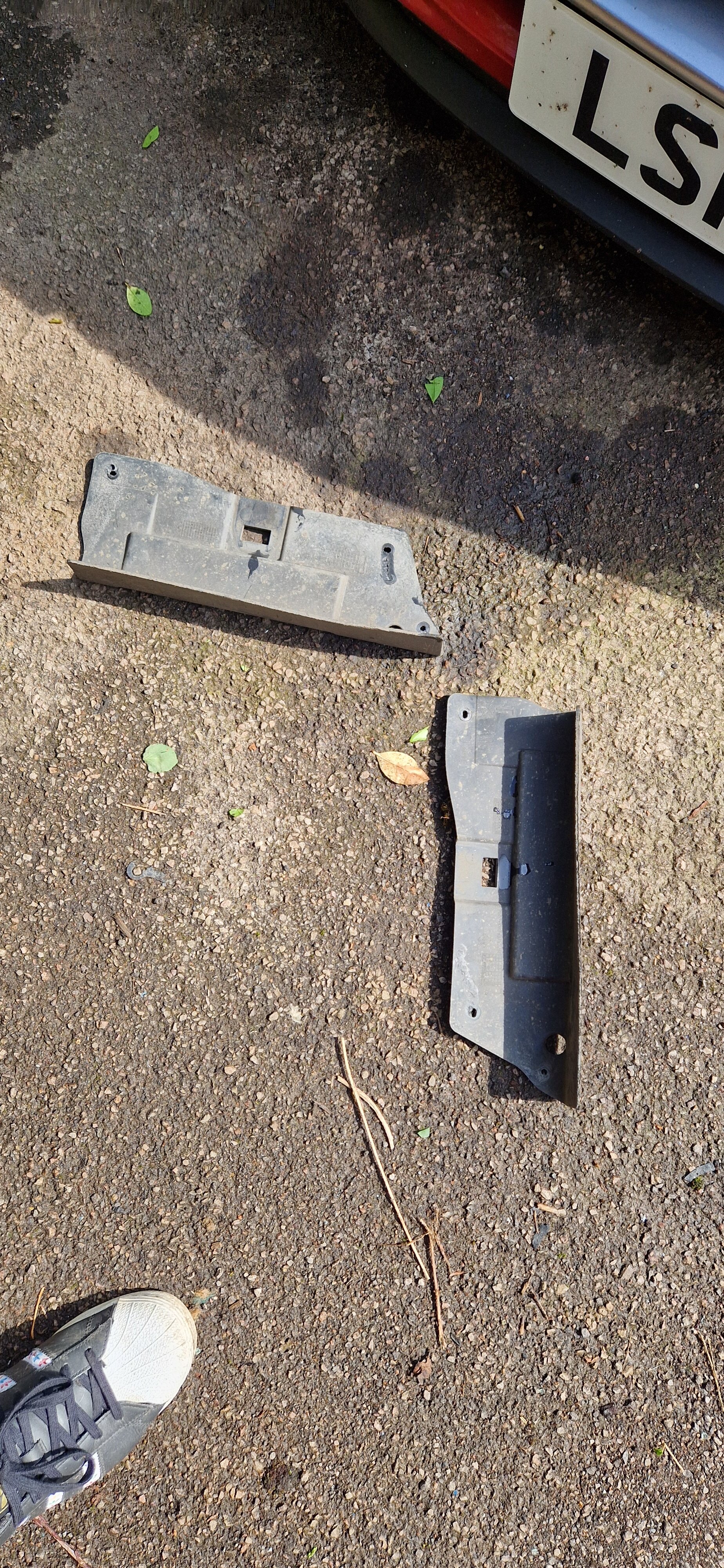

Whilst there I actually removed the air deflectors for the wheels. Now this actually pops up as a suggestion on the RS monitor for keeping the brakes cooler at the sacrifice of some MPG. I've done this to help aid the brakes on the upcoming track days.
under the car in front of the front wheels
Doesn’t that actually refer to the triangles that clip in rather than those that are riveted?
