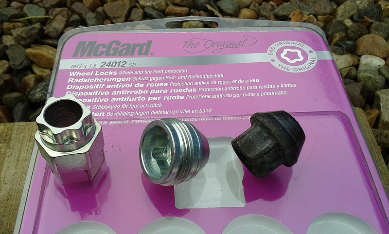

Ive been meaning to get some locking nuts for a while but most locking nuts have closed tops so they won't nun down a long stud. Then i spotted these in Halfords :S
Anyway, they are spot on, for going on the standard Twingo Cup wheels or the Speedlines. They have the 60deg seat and are the same diameter as the nuts which I had fitted, the key sits nicely over the wheel stud so it should have a bit of support for when you come to undo them
The only inconvenience is needing a 19mm socket
