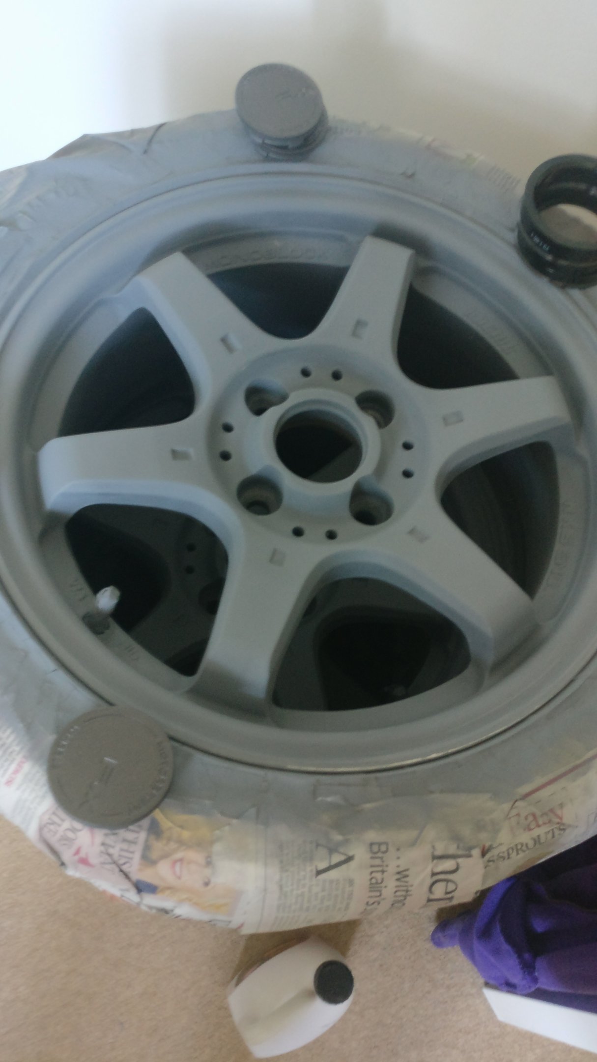

Looking to get some studs, I take my wheels of a fair bit and I'm fed up with horrible rusty bolts. + I got new wheels.
One I've finished spraying them and cleaning them up. (I brought them black. Crumbling black) I'm not running Spacers. And my wheels are only et35. Do you think these ( https://www.driftworks.com/wheel-stud-conversion-kit.html) will be okay?
They end up poking 66mm out past the hub ik people run 68mm! but is that overall length? I only want short ish ones. I don't want massive extended bolts or bolts that end up with the studs poking out of them. It would just be anoying for me.

Okay. I think 58mm overall is what I want. Just struggling to find some at that length I know the pms are like 72mm or close they allow for 20mm spacers

65mm from the face of the flange, disc is 7/8mm thick so that gives you 58mm of length from the face of the disc.
14mm is the tapered end of the stud so if you wanted to lop that off that gives you about 45mm of thread length.
